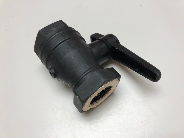

Also the inline valve is plastic from the bronze thru hull. It does not work, just slips, does not open all the way, and does not close all the way--replacing with a bronze ball valve. Why did Boston Whaler use plastic on thru-hull rigging? All the boats I have owned always used bronze. Pretty cheap from Boston Whaler.

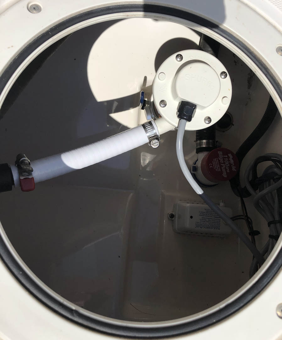

For the record I installed a 800 Bait Sentry and Bronze Shut off valve. I also replaced the 2amp breaker with a Blue Seas 5amp as directions indicated. Got plenty of pressure in the well and my plan is to install a two way valve in line and put a raw water spray hose in engine well.
