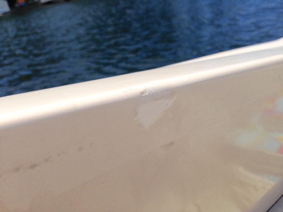

Postby jackjax » Sat Dec 26, 2015 10:26 am

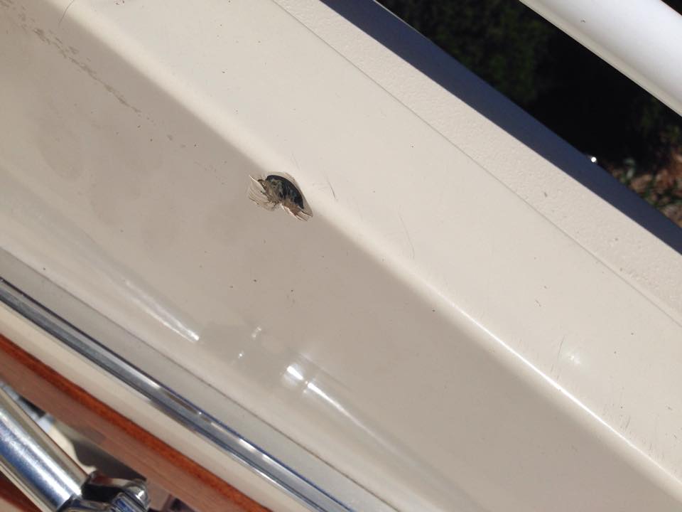

[Please give advice on how] to fix this [this small area of damage on a 1997 Boston Whaler Dauntless seen in this linked image]. [The damaged area has dimensions of] about 2-inches long and 1/2-inch wide. [The depth of the damage is] not deep. Just the fiberglass [is] damaged, it seems. I see some kind of foam, too. Thanks

Please read the following three articles to get advice on how to make a repair to your Boston Whaler boat hull:
--Repairing Hull Damage the Whaler Way
--Instructions, Hull Patch Kits
--The Epoxy Cure
These three articles contain a great deal of expert advice, excellent illustrations, and first-hand accounts of repairs to the hull of a Boston Whaler boat. This information will be useful to your if you want to undertake the repair of this minor hull damage yourself.
Questions seeking advice on how to repair damage to the hull of a Boston Whaler boat are frequently asked questions. Answers to frequently asked questions have been prepared in an article called the FAQ. A good place to start when looking for advice is to read the FAQ.

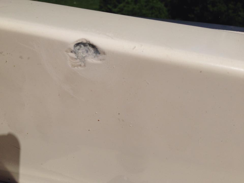

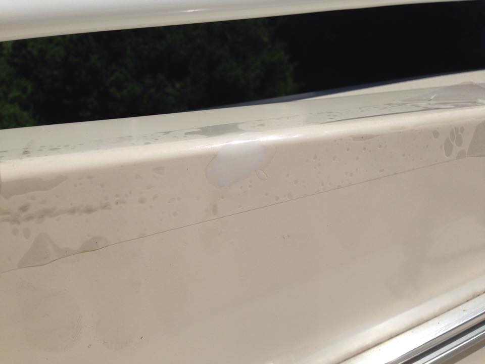

Here is an easy step by step of what you need to do...this is how I fixed a similar small knick in my Grady White. There will be multiple postings so I can attache all the images.
Base layer needed if foam is exposed:
Step #1
If foam is exposed, you might need to an initial layer of resin and chopped mat or cab-o-sil to close and seal up the damage. To fix that you will want to mix up some resin, tape the area off and with the end of a paint brush dab it over the area to work it into all the nooks.
Step #2
While that area is wetted, work some chopped glass material over the area and do a final layer of resin over that. It does not have to look pretty.
Step #3
Once cured, with 60-150 grit paper, smooth out the area and prep it for gel coat filling.
Finish layer of Gel Coat

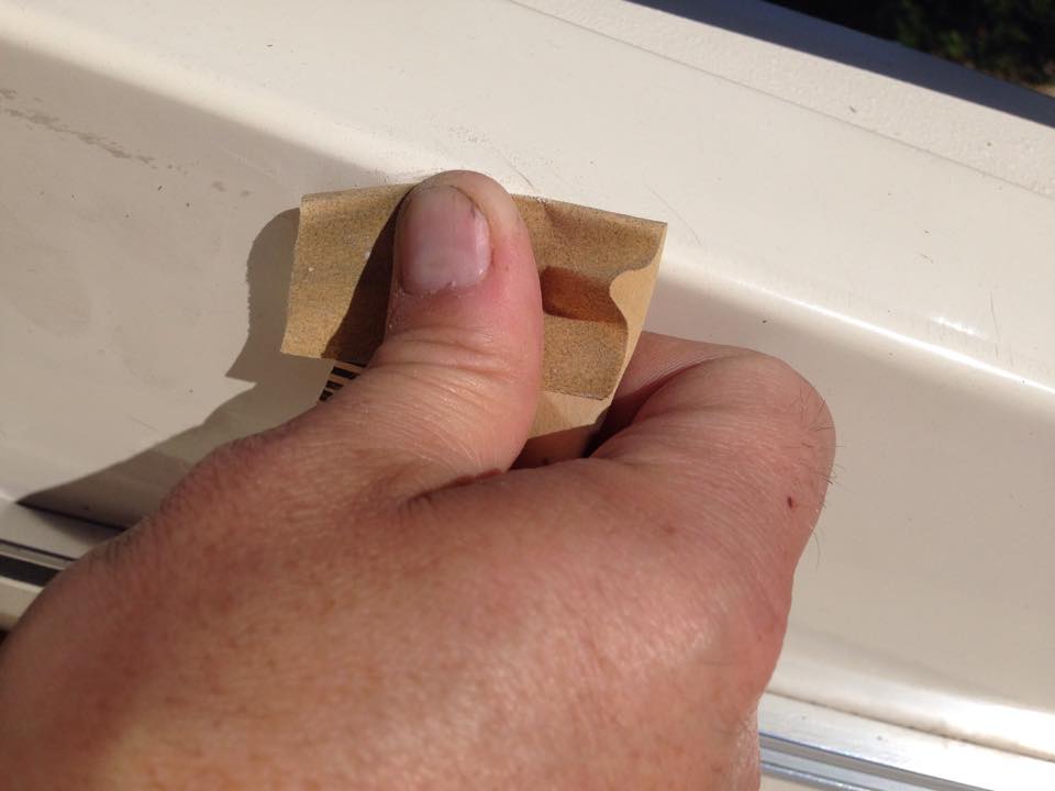

Step #1:
Use 150 Grit sand paper to rough up the area of damage and just about 1/2" of the surrounding gelcoat. Wipe that clean with lacquer thinner once done.
Jeff
Posts: 138
Location: Detroit Area
Re: Repairing Boston Whaler Hull Damage
Postby Jeff » Sun Dec 27, 2015 2:11 pm
Step 2:

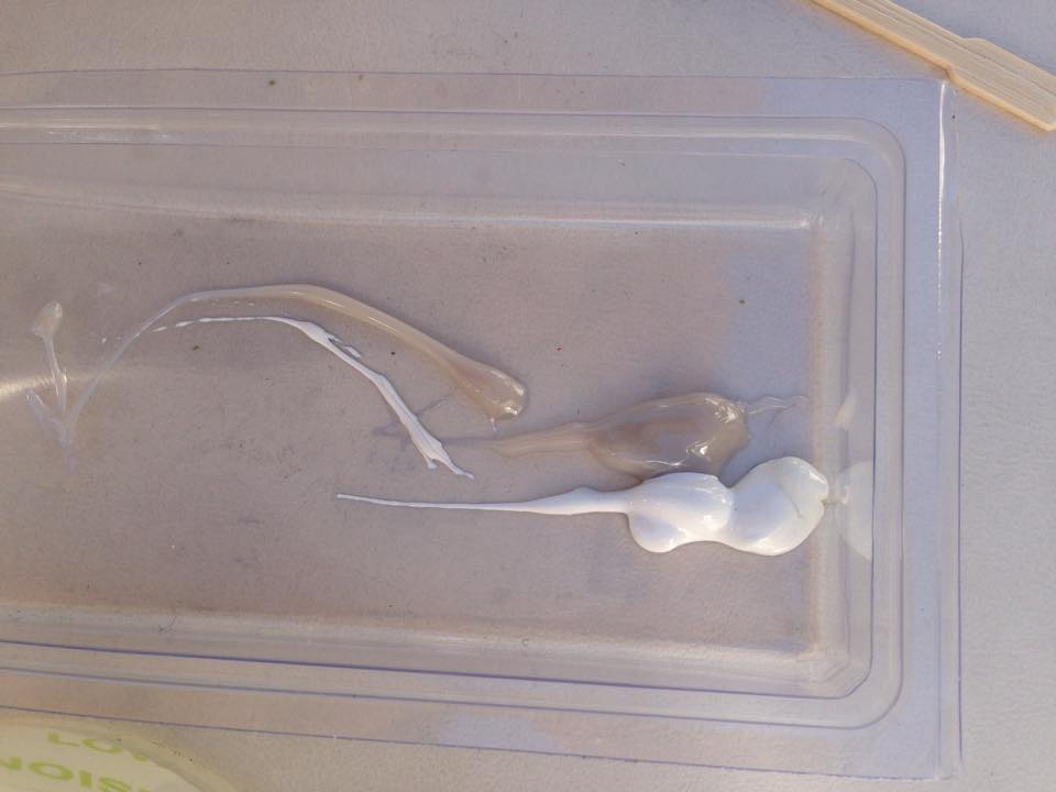

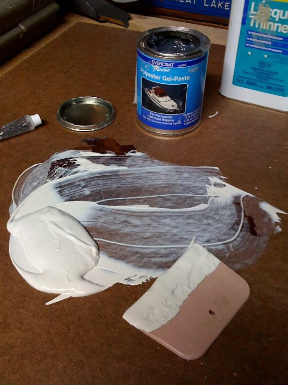

Mix your gelcoat patch.
If you need to extend the material I would recommend using Evercoat Gelcoat Paste. It is a clear product and takes color really easily. Here is a large batch that I mixed together to fill a bunch of scrapes on my Newport.
Jeff
Posts: 138
Postby Jeff » Sun Dec 27, 2015 2:22 pm
Step 3:

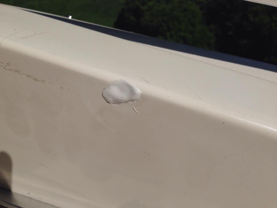

Now you need to fill your damage. For me I like to use a small detail paint brush to work the material all the way into every little nook. Once that base is done I then fill the area with more material until it seems the area is just a little over filled.
Because in your area of damage you have compound curves and because gravity is going to be working against you, I highly recommend using Chuck Tribolet's packing tape trick. I think because you are working on the underside I would lay a row or two of clear packing tape under the area you are going to be filling. Only Attach the bottom 1/4 edge of the tape and let the top 3/4 hang, or pull it back and use a tab of tape to hold it in place.
You will need this because as soon as the material is fully in there, you are going to want to quickly take that tape and wrap it over the compound surfaces. This trick will help to form and mold your repair to match the contours of the hull as well as hold it in place to let it cure.
Step #4
Once cured, you can remove the tape (it releases right off the new patch) and clean the area with lacquer thinner. If there are any major voids or low spots, you can go back and do the same process to get the material built up to level.
Step #5
Once you have it filled, lightly wet sand the repair with 220 to smooth it out, then 600->800 grit. Finish by polishing the area with compound and wax.
Step #6
Use all that money to saved to fill your tank with gas and enjoy the boat..
