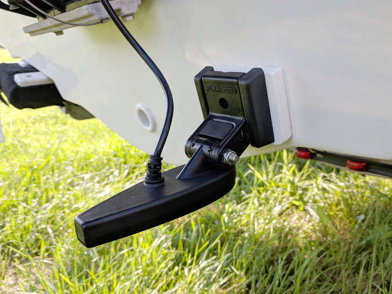

I recently replaced a SONAR transducer, and of course the new mounting holes did not line up with the old mounting holes. I cut a small rectangle from some leftover KING Starboard, mounted it to the hull using the old mounting holes and some 3M 4200, then drilled the Starboard for the new mounting holes, making sure to choose screws that didn't penetrate to the gelcoat.

It was clever to use the original transducer's mounting holes to mount the Starboard adapter. An added benefit is that the adapter can be slightly oversized to accept some of the more outsized transducers used with modern sonars. On the curved transoms of many classic boats the curvature presents some added challenges.
