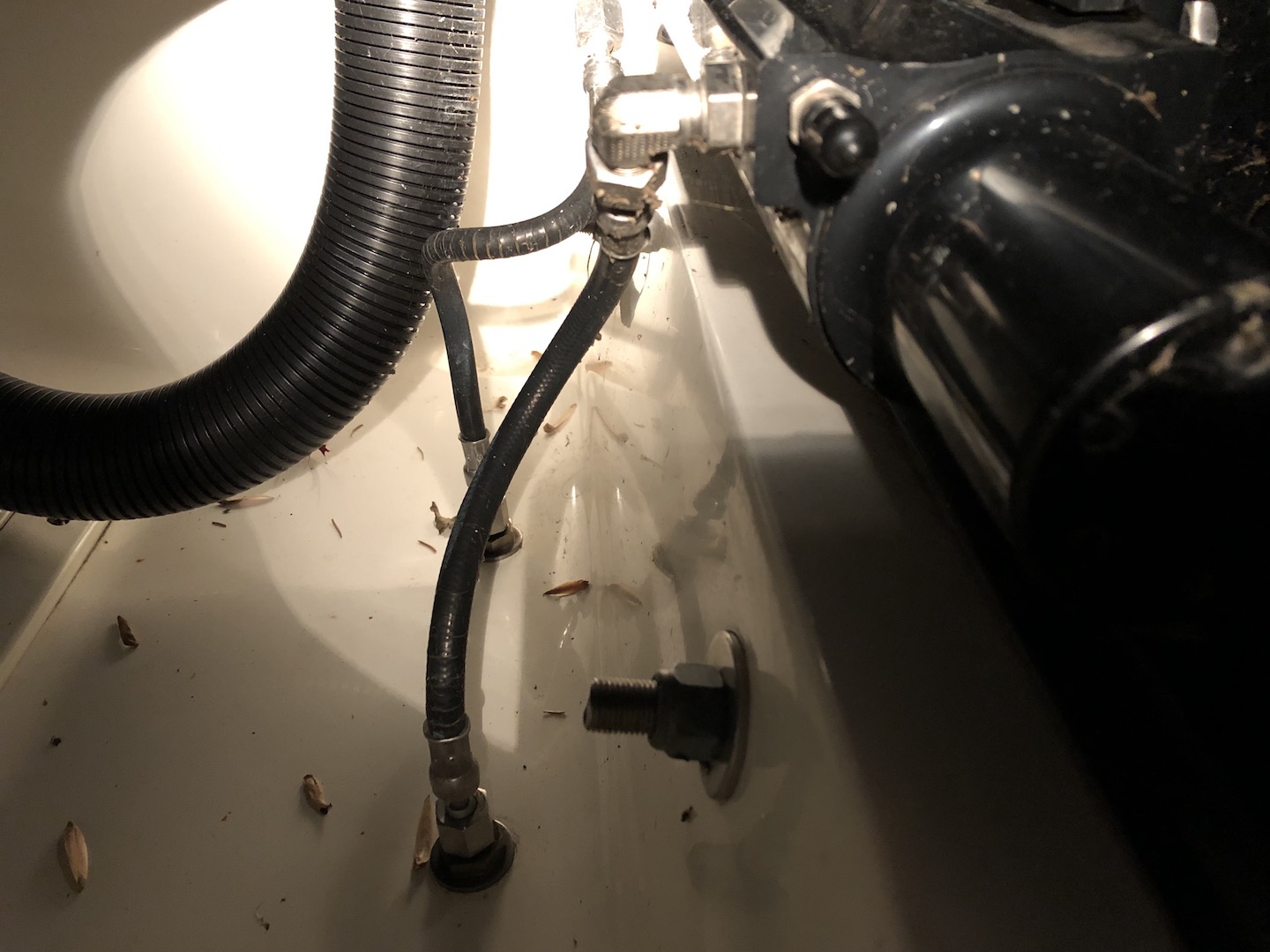

The steering hydraulic fluid hoses on my 2006 Ventura that [extend from the engine splash well to the steering actuator] are looking pretty bad.
Fig. 1 Steering hose extensions
2006 Ventura steering hoses.JPG (237.11 KiB) Viewed 14917 times

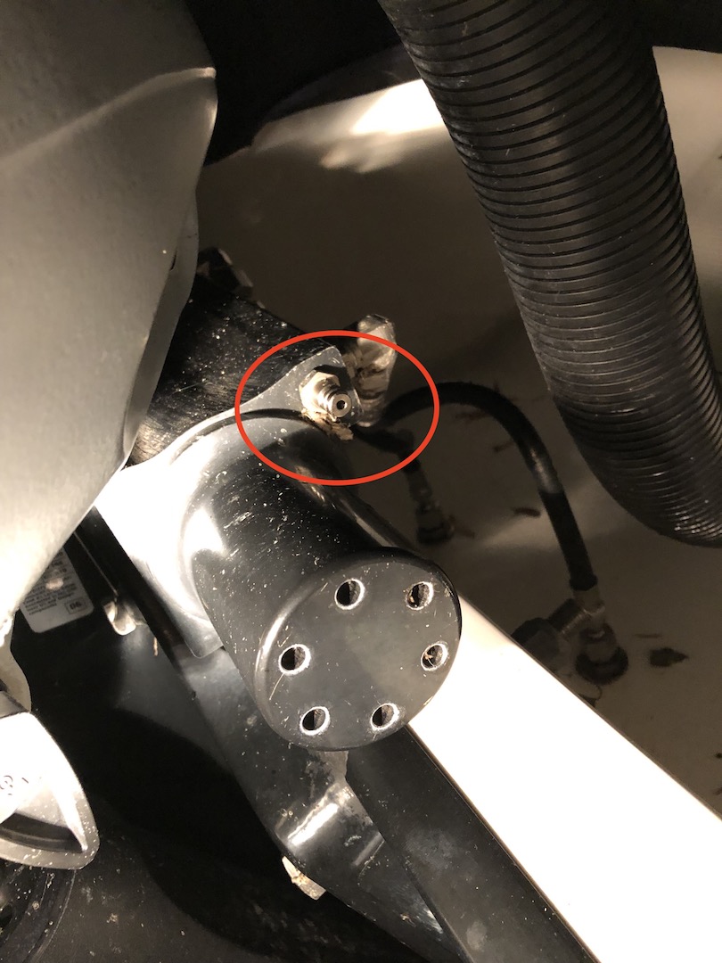

Fig. 2. Component circled in red on actuator
2006 Ventura steering fluid coupler.JPG (173.03 KiB) Viewed 14917 times
I'd like to replace these two hoses this winter, so I don't have one break while I'm in the middle of the water somewhere.
Has any reader of this post ever replaced these hoses?
I'm guessing you can just buy this specific part.
I may take off one hose and have [a duplicate hose] made at a local shop like Parker Hannifin.
Once I take off one hose, I'm assuming I'll lose a lot of hydraulic fluid.
What type of hydraulic fluid do I replace the lost fluid with?
Also, see the quick connect coupler fitting circled in red in the Figure 2: I'm thinking I use those, as there is no spot on top of the steering wheel to pour in the oil.
How will I know [the hydraulic steering system] is full?
Finally, I thinking I'd just turn the steering wheel back and forth to bleed the system.
Is that correct?

You could buy Mercury or Boston Whaler hoses. Or, you can take your removed hoses to an industrial hose supplier and they will make you new hoses on the spot for less money, as most farmers, construction equipment, and truck operators do.
For bleeding [instructions] go over the posts on this site or search on YouTube where many procedures are shown.

Typically in a hydraulic steering system, the helm pump is at the highest point in the system and the engine actuator is at a lower level. The procedure to add fluid is usually done at the helm pump. The helm pump typically has a filler inlet that is normally sealed with a cap. The process of adding fluid during any air bleed procedure is usually done by removing the filler cap, threading into the helm pump filler inlet a new fitting with a hose barb, attaching a hose to the new fitting, and extending the hose vertically upward to a higher level. A reservoir of hydraulic fluid is then attached to the filler hose. The reservoir is vented to the air, and the reservoir level kept high enough that no air will be drawn into the helm pump.
Typically at the engine actuator there will be two air bleed fittings, one on each side, with each associated with one direction of motion of the actuator. The typical air bleed process will open one air bleed, then turn the helm pump in the direction that pushes fluid toward the open air bleed. The air bleed is usually fitted with a temporary hose. The hose outlet is put into a container that will collect the hydraulic fluid. The outlet of the air bleed hose is kept under the level of the fluid collecting in the container. As the helm pump is turned, fluid will begin to be pushed out the bleed outlet, and any air in the system will be expelled along with the fluid, appearing as air bubbles in the outflow. When all air has been expelled from that portion of the system, that air bleed is closed, the bleed for the other direction opened, the temporary hose and container are attached to that air bleed, and the procedure repeated with the helm pump rotating in the other direction.
If there is no indication of a filler port on the helm pump, there may be a completely different procedure necessary to accomplish the addition of fluid and the bleeding of air from the system. If fluid is to be added at a lower point in the system, some sort of filler pump or pressure will be needed to force the fluid into the system, and uphill to the helm pump. There would typically then need to be a bleed air vent at the helm pump to allow the air to escape.
Also, with a Mercury VERADO FOURSTROKE engine, there is likely an electrically-operated steering boost pump involved in the hydraulic steering. The procedure for bleeding the hydraulic system will likely be more complex due to the presence of the electrical boost pump. I suggest you obtain the exact procedure to be used with your exact system from the manufacturer of the system.
It is now common practice that specialized gear is attached to a hydraulic system for the purpose of bleeding air, often called power-bleeding pumps. This gear is able to reduce the amount of wasted fluid expelled from the system during the bleed process. The use of power-bleeding gear also significantly reduces the time involved in bleeding air. And the outcome is usually excellent, that is, all air is quickly and effectively removed from the system in a matter of a few minutes.

Re replacement hoses: I suggest you inquire about an OEM replacement hose and its cost. The notion that the existing hose could be exactly duplicated by a local service shop is speculative. The fittings and hose used may not be on hand at every service shop. The notion that the cost of a custom-made hose fabricated by a local service shop will intrinsically be less than the OEM hose is also speculative.

Verado power steering hose replacement seems to be a topic with a number of threads on the Verado forum with failures. It is recommended that if you are running the OEM Verado hoses that you install something over it to protect from the UV exposure since they do crack and fail.
Go OEM if you want simplicity, but if you want a better hose and possibility of saving money, then look to have them custom made. On a non-marine application I looked at OEM hoses (rated at 3000-PSI), but was able to have them made locally with 5000-PSI hoses for 30-percent less cost--better hose and a savings was a no brainer.
As for hydraulic fluid there's lot of information floating around about using ATF fluid, automotive power steering fluid to save money. I steer clear of them. Teleflex sells their liquid gold fluid at nearly $20-per-quart, which is grossly over price, as many marine products are. You can look at aviation hydraulic fluid in place of the Teleflex fluid and aviation fluid is made to a much higher standard since the FAA frowns on planes falling out of the sky.

I don't recall if these extension hoses on a VERADO FOURSTROKE follow the engine as it is turned, or if they stay in place. If the hoses are stationary, it should not be too difficult to give them protection against ultraviolet light with a covering. If the hoses have to swing back and forth with the engine as the engine turns, covering them will be more difficult. You'd have to find a cover that was sufficiently soft and pliable that it did not cause abrasion of the hoses, but at the same time provided UV-protection. And here I am assuming UV is the cause of the damage.
I have hydraulic hoses that are stationary on my boat, and they are the original hoses from c.1990. That's a 28-year service life. Of course, my boat spends all its time around Latitude 45-North, so UV is lower, and much of that time under cover or indoors.
Is the boat we are discussing operated near the equator or in some very strong sunlight environment?
To have the hoses decay in 12-years sounds like a rather short service life. I can understand there might be mentions of these hoses showing decay on VERADOCLUB, as many of those participants are in the southern USA, and maybe within 100-miles of Ft. Lauderdale, Florida, which seems to me to be the epicenter of VERADO ownership. But a VERADO in the northern Great Lakes ought to go about 30-years on one set of hydraulic steering hoses, particularly if they are not subject to any motion.
Also, I am not a big fan of non-OEM parts, unless there is some notorious lack of quality in the OEM part that needs to be remedied by an aftermarket part. If these VERADO hoses were really lousy hoses, I would expect an alternative supplier would have entered the market to supply high-quality hoses and compete with the Mercury branded hoses.
By the way, I think the real OEM of those hoses may be UFlex--just my guess and not authoritative.
