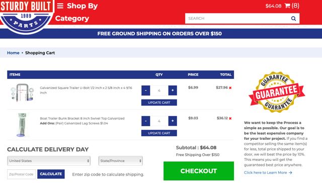

While I don't know the exact size of your frame here is an example of what you are looking for:
These are the items:
U bolts - https://www.sturdybuiltonline.com/Galvanized-Square-Trailer-U-Bolt-12-inch-x-2-58-inch-x-4-916-inch_p_1053.html
Brackets https://www.sturdybuiltonline.com/Boat-Trailer-Bunk-Bracket-8-inch-Swivel-Top-Galvanized_p_277.html
You just need to measure and select the sizes that work on your trailer.
http://www.EasternMarine.com (TrailerPartsSuperstore) are also very good having used them for over 10 years.
