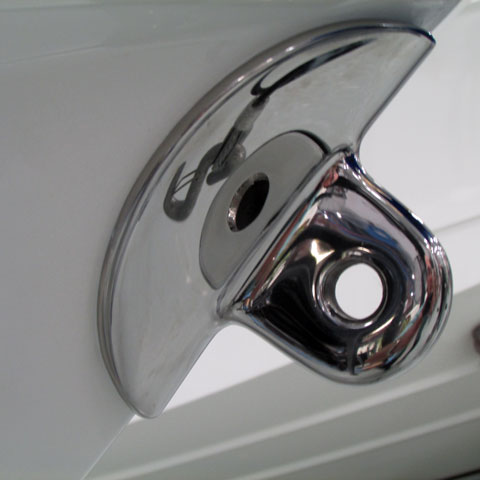

Re: 210 MONTAUK: Towing Behind Sportfishing Yacht
Boston Whaler has been offering a "tow eye" as an option on many models.
Looks like this:
Looks like this:
- OFUM_13233895.jpg (28.45 KiB) Viewed 57846 times

As per Phil's comments and picture, Whaler sells (as a build option) an Bow Tow Eye option for $1,318.00 for the 210 Montauk - I would not attempt long distance towing or towing on a regular basis with just the standard bow eye. The weight of a 210 Montauk will be in the 3,700-lbs range. I would also probably not tow a 210 Montauk with a T-Top. I would imagine that would add considerable drag and stress.

Phil's picture is the actual picture of the Boston Whaler build option that Boston Whaler calls " Bow Tow Eye" which is offered as an $1,318 option on the 210 Montauk. It seems this may also be retro fitted. http://www.toweye.com/ lists Boston Whaler as one of the boat buiders that uses its products. There is also some good information on their site about towing and bridle set-up: http://www.toweye.com/towrigsetup.html

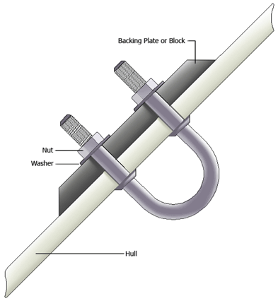

40.6 BOW EYES AND BOW STRAPS
40.6.1 General - Boats designed to be towed (e.g., a tender) or winched onto a trailer shall be equipped with a bow eye or bow strap.
40.6.2 Materials - Bow eyes and bow straps shall be constructed of a material which will minimize galvanic corrosion (see ABYC E-2, Cathodic Protection) with the hull materials.
40.6.3 Design and Construction
40.6.3.1 Bow eyes and bow straps shall be of suitable dimension to accommodate the towing line or trailer hook, but not less than one inch inside diameter.
40.6.3.2 The inside working surface shall be smooth and rounded.
40.6.3.3 A bow eye or strap, and their points of attachment to the hull, shall be able to accommodate a direct tension pull of the sum of the boat weight and its maximum designed weight capacity.
40.6.4 Installation
40.6.4.1 The bow eye shall be installed parallel with the centerline.
40.6.4.2 Bow eyes and bow straps shall be through bolted with backing plate(s)/block(s), and washers and nuts incorporating a locking means, or welded to the structure of metal boats. (See Fig. 1) [below]
Source: http://mantusanchors.com/2014redesign/w ... 1/H-40.pdf

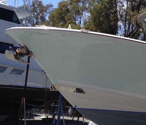

Notice the bow eye on this SOUTHPORT 29 Tournament Edition boat; it looks quite different from the usual bow eye. I suspect it might be reinforced for towing. It appears that six bolts fasten the bow eye to the hull via the associated strap.

jimh wrote:Notice the bow eye on this SOUTHPORT 29 Tournament Edition boat; it looks quite different from the usual bow eye. I suspect it might be reinforced for towing. It appears that six bolts fasten the bow eye to the hull via the associated strap.
It appears to be an aftermarket item.
I don't believe that SOUTHPORT manufactures the bow towing fitting shown in the photograph of their boat (above), but I doubt that it was added to the boat after it was built at the factory. Maybe you can call SOUTHPORT boats and track this down. I showed the fitting to illustrate a bow eye fitting that appeared to have extra reinforcement for towing
As for the vendor you linked to, they specialize in fitting out larger boats for towing. The fitting is a custom fitting, as it would not be easy to fit it to a hull at the bow stem unless the fitting were made to exactly match the angle and slope of the bow. I wouldn't call it an "aftermarket unit" in the sense that you can just buy it off the shelf. They probably bend and shape them to exactly fit a particular boat. Also, the fitting you have pointed to has six bolts per side, not three, so I don't think it is the same fitting as I showed with the SOUTHPORT boat.
jimh wrote:I don't believe that SOUTHPORT manufactures the bow towing fitting shown in the photograph of their boat (above), but I doubt that it was added to the boat after it was built at the factory. Maybe you can call SOUTHPORT boats and track this down. I showed the fitting to illustrate a bow eye fitting that appeared to have extra reinforcement for towing
I don't believe the boat builder manufactures the reinforced bow eye either. But they also don't manufacture a lot of the hardware used on the boat. As do many builders, they source the hardware.
The picture you posted also shows a standard bow eye that is on every Southport trailer boat. Many of the Southport web pictures and videos do show that reinforced bow eye though.
porthole wrote:...The picture you posted also shows a standard bow eye that is on every Southport trailer boat.
I disagree. Most of the SOUTHPORT boats I saw pictured on their website did not have that unusual bow eye fitting. That was the basis for my using that picture. It showed an unusual bow towing eye, not the standard bow eye. I actually saw the picture in much higher resolution in a magazine print advertisement. When I went to look for it I could not find it in a high-resolution format on the web, so it is a bit hard to see that there are only three bolts per side, not six.
For an example of a SOUTHPORT boat with a more commonly seen bow eye, just visit:
http://southportboats.com/model/southport-272/
That image disproves your statement that the bow eye I showed is on every Southport trailer boat; it is not on the one on their webpage.

jimh wrote:porthole wrote:...The picture you posted also shows a standard bow eye that is on every Southport trailer boat.
Jim, you misunderstood me.
What I was referring to was that all of the Southport boats have a standard loop type bow eye. The picture you posted has one as well as the heavy duty V shaped item.
I did contact Toweye about the Southport pictured. http://seahawkmarine.com/southport-boats/southport-29te/
They said the piece pictured on that boat was not their product and they supplied me with a picture of their product on a Southport. Not easy to see, but there does appear to be a different number of fasteners between the two. I also contacted Southport, but no reply yet.

The tow option offered by Boston Whaler must be requested when ordering. The reinforcement required is constructed during the build. The eye itself does not differ markedly from the standard eye. Broward Marine (or Toweye) fabricates the eyes for Boston Whaler. The owner of Broward is a very nice fellow and very helpful.
You do not want to put holes in the hull to mount an after-market backing plate. The towing eye offered by Broward uses the holes used to mount the standard eye, slightly enlarged. The after-market product is priced very close to the tow option offered by Boston Whaler. I hope this helps others.

Clarification--the standard tow eye is in fact intended for occasional, slow speed, short distance towings. Our boat was so equipped.
The picture posted above is of the enhanced tow eye marketed by Broward Marine.
The optional tow package from Boston Whaler for the Montauk includes that tow eye together with an integrated backing plate.
The after-market ensemble includes a reinforcing backing plate. The backing plate is in the anchor locker and visible after installation.
If you look at the standard tow eye, you will see that there are two bolts that go into the hull. There is a nut inside the anchor locker. The aftermarket backing plate includes two holes to accommodate those bolts. Remember, the enhanced eye is very similar to the standard eye.
