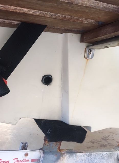

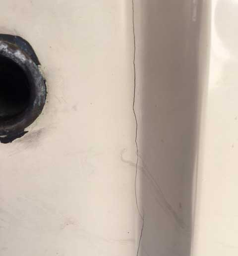

Hi - just joined the site and this is my first post. I recently purchased a 1992 Outrage 17. I noted a crack on the transom gel coat when I made the purchase, and I assume it is cosmetic but would like to get some expert advice.
Fig. 1. A crack in the gel coat at the transom
The crack is what I would call a "hairline" crack, narrower than a sheet of paper. It is about 12-inches long and located in the corner of the transom where the transom goes in about an inch. The transom sounds solid when tapped. Any thoughts or experiences would be appreciated.

Can you post a picture showing exactly where that crack is located?

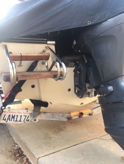

To better understand the crack location see the two attached photos. The crack is located beneath the swim platform in the corner. I hope this will give you a better idea of what I'm dealing with. After reading a bunch of posts, I think I'm convinced to take it in to a repair place and have them take a look. I live about 90-minutes north of Los Angeles if anyone has recommendations for a repair facility in my area.

That drain plug looks about ready to replace.

Given it is a single crack I would discount it as a stress crack caused by movement in the transom and proffer that it is a result of age and an over application of gelcoat in that seam at the factory.
It is cosmetic.
If one really wants to reduce its appearance, the crack should be ground out a bit and colored gelcoat patch paste, sold by Spectrum, can be applied. Note color matching is not exact due to age and variations in production.

In areas of the hull molds were a rapid curving of the surface takes place, it is common for there to be a build up in the thickness of the gel coat layer. Gel coat resin is not particularly flexible, and in thick areas the resin has a tendency to crack. It is common to see on older Boston Whaler boats that some cracks appear in the gel coat layer in certain areas of the hull which may have some bending stresses on them (such as at the transom) and where the gel coat layer is thicker than elsewhere.
Gel coat applied to flat hull surfaces will generally not be particularly thick, perhaps only 0.020 (or "twenty mils") thick. But if the gel coat layer has been build up to be much thicker, it may exhibit stress cracks.
As long as the crack is confined to the gel coat layer and the underlying laminate and resin layers are not involved, a gel coat crack is mostly a cosmetic flaw. However, a gel coat crack was probably produced by some stress on that area of the hull, so it could be seen as an indicator of some slight flexing.
In the case of a crack that extends for several inches and runs vertically along the edge of the thicker portion of the transom where the hull has embedded reinforcement material, a careful examination should be made of the stiffness and rigidity of the transom. A simple test is to tilt the outboard engine lower unit to an 45-degree angle with the transom, and then use the gear case as a lever arm, pulling up and down on the gear case while observing closely the transom for any indication of movement. On a solid transom there won't be any movement.

Some of the cracks I filled look similar to the one in [Fig. 1 above].
