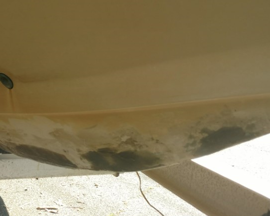

Hello. I plan to buy a MONTAUK 17. I came across 1984 boat that I really like—except it has keel damage depicted in Figure 1. The owner said that the DIY-repair was done to prevent further damage until professionally done, and that it was mostly sandbar rash from years of beaching the boat.
I have no reason not to believe the owner, I just want an opinion of what I am looking at here.
Q1: What concerns should I have?
Q2: And how much to fix?

It is difficult to judge the extent of the repairs needed from the photograph. The only way you will truly know what is needed to do a proper professional-grade repair will be to grind off the temporary repair to see what is lurking beneath.

ac61 wrote:Q1: What concerns should I have?
The principal concern is that the hull laminate and possibly the hull foam has become saturated with water due to exposure of the hull laminate layers below the gel coat layer to water or to exposure of the interior foam to water, particularly on a hull running surface.
A secondary concern is that the initial repair was not made with a resin that was particularly suited to the task.
A tertiary concern is the repair may need to be completely ground away, which will inherently create a new, larger area to be repaired
ac61 wrote:Q2: And how much to fix?
The materials to repair this damage will probably not cost more than $100. The labor to repair this damage will be free, if you do it yourself, or if hired out, probably cost about five hour of labor, or perhaps $500. Thus the cost to repair will be from $100 to $600. This assumes the damage is limited to the gel coat layer and a small part of the underlying laminate layer.
If the damage is more extensive and the interior foam of the Unibond hull has been exposed and is saturated with water, the repair will be more difficult and more expensive.
For an example of how to make repairs to a Boston Whaler Unibond hull, I recommend you read the excellent article with several illustrations at
by Taylor Clark
http://continuouswave.com/whaler/reference/whalerRepair.html
Another resource for information about repairing a Boston Whaler Unibond hull is this reprint in HTML of the Boston Whaler repair advice:
A narrative of a relatively simple and very inexpensive repair process to fix damage to the running surface of a Unibond hull which did not expose the foam is available at
The Epoxy Cure
http://continuouswave.com/whaler/reference/epoxyRepair.html
Re: Montauk Hull Damage Assessment
Postby jimh » Sat Oct 05, 2019 9:27 am
In assessing the value of the MONTAUK 17 that is a prospective purchase, I would ask the seller to reduce his price by about $500 based on the repair of the hull damage. Also, to get a better idea of the extend of the damage, ask the seller to drill a 0.125-inch-diameter hole into the repaired areas to see if any water begins to drip out from the repair. If no water appears, the repair will be simple. If water begins to drip out, the repair will be more extensive. The hull may need several months to dry out before a proper repair can be made.
If the seller balks at either suggestion, ask the seller to have the damage repaired professionally at his expense, and then you will retract your request for the $500 reduction in price.

I personally would not be afraid if the price was right.

I was measuring resistance. A dry transom would show no continuity.
Is your conclusion of moisture content based on testing the electrical continuity on a good number of Boston Whaler 17 Montauks or any other boats that have a laminated plywood/fiberglass transom? If yes how many readings of this nature, Boston Whaler transoms or other transoms of similar construction is in your sample data set to establish the baseline electrical continuity ranges that would be indicative of a wet transom or a wet boat or a dry transom or a dry boat?
Readings such as moisture content utilizing a "moisture meter" are only useful in a relative sense. If there is not a good number of known base level data collected and verified on very similar if not identical hulls on a boat that is considered dry vs a boat that is considered wet then a conclusion on one moisture reading is only evidentiary but not conclusive for a determination of the general moisture content of a boat.
Weighing the boat is a great weigh (pun intended) to determine if you have a bunch of water in the hull. But quite frankly you can kind of tell by just looking at the boat to see if attention has been paid to limit water egress via the bottom or interior of this boat.
How much are you considering paying for this boat? If it is $10,000 for the boat only then walk away. You are not looking at a $10,000 hull. If it is $5,000 for the boat walk away given the "temporary patch" and your very significant concerns. If it is $2,500 then there is very little risk to the purchase. Add the contributory value of anything else included and there ya go on a decision. If you're paying around $5,000 for the boat, an engine that runs and a basic trailer to pull it around it is what it is.
Forget about a moisture meter and get yourself a hard plastic hammer. Tap lightly around the boat. Crack Crack Crack sharp reports back it's not significantly wet and is likely sound. Thud Thud Thud there are problems.
