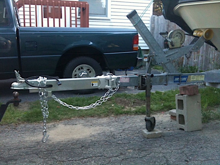

In a REFERENCE article series on TRAILERING, a very good illustration of a trailer tongue extension was provided by contributor Chuck Tribolet, a crafty engineer (who unfortunately passed away several years ago). His modification is seen below:
The right-hand portion of the extension fits into the existing trailer frame. When at the launch ramp, if even more extension is desired, two bolts can be removed, and the tongue can be extended further, and the bolts reinstalled.
As seen above, the extension and the original trailer box-beams are joined by using a smaller box-beam that telescopes inside the original beams and has a considerable span to bear the stress and load.
