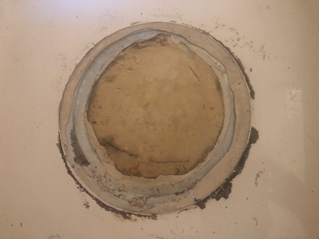

[In August 2019] I purchased a 2008 Conquest 285, and I have discovered a major problem. I bought the boat in Long Island, NY. and shipped it to Southern California where it sat in the boat yard for three weeks getting new bottom paint, a little engine maintenance, and new electronics. During this time I did some deep cleaning and discovered the boat had mold and mildew in all the spaces and voids where wires are run. I cleaned everywhere.
In the forward bilge and storage compartment in the mid berth behind the companion way (as pictured below) I discovered a 10-inch round fiberglass lid that was loose and peeling off. I removed it and the thin layer of silicone revealing the foam core. Apparently this is where [Boston Whaler] injected the foam during construction. [The foam in the interior of the Unibond hull at this location] was soaking wet.
Fig. 1. Wet foam at Sprue hole. There is a gap between the laminate and the foam at one side.

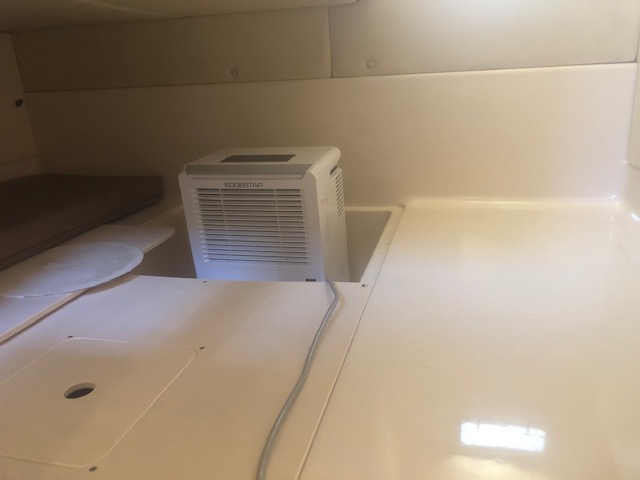

I thought maybe [the foam had become wet] just from the water I used to clean the area, and that [the wet foam] was on the surface ONLY, of course, because of the closed cell foam. We dropped the boat in the water and put her in a slip. For the last two weeks I have had either a fan or most recently a dehumidifier running right on top of the foam [at the sprue hole] and it is still soaking wet.
Fid. 2. Mid berth storage compartment with dehumidifier.

The circular cut-out seen in Figure 1 is the SPRUE HOLE. In molding the hull, the sprue hole is typically the point in the molds where the foam is introduced (as a liquid) and then later escapes during expansion into a foam. After the foam has cured into a solid, the sprue hole is capped with a thin laminated cap. This is a feature common to many Boston Whaler hulls. The location of the sprue hole varies from model to model.
I do not think that blowing a fan to move air across the top of the sprue hole is going to be particularly effective at drying the foam, and a de-humidifier probably even less effective.
I recommend you check with Boston Whaler customer service for further advice.
One idea that comes to mind: perhaps a hole of say 0.75-inch diameter could be bored downward for about six-inches into the foam that is exposed at the sprue hole. Be sure to check with Boston Whaler if this is possible, as there could be other elements deeper in the foam that are passageways or shear-tabs for bonding the inner and outer hull together. Assuming the hole is safe to make, then If this hole then fills with water, a hose could be put into the hole and led to a pump. The pump would then pump the water out and overboard. In this way perhaps more water could be extracted from the interior foam.

The water around the sprue hole seems to be greater in the area toward the bow. When I apply pressure on the forward edge of the sprue hole, water comes up through the cracks.
And I am relieved to report the foam is not nearly as wet as I had thought. There are two cracks in the foam. The water is coming up through the cracks and the surrounding foam appears to be dry. I made small incisions which revealed the dry foam
Q: what caused the cracks in the foam visible in the sprue hole?

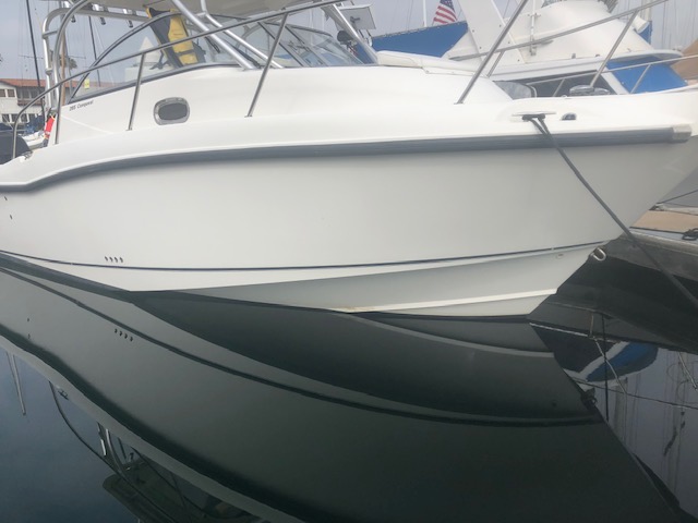

Fig. 4. [View of static trim at the bow; bottom paint appears to be above the water line. Bottom paint at stern seems to be several inches above water line.--jimh]

Re the present trim on the boat compared to where the anti-fouling paint was applied as shown in Figure 4: to make an inference about the presence of water in the hull based on a comparison of the current static trim to where the anti-fouling paint was applied previously is difficult.
As I indicated parenthetically in your comments, the photo of the bow shows the hull is floating higher at the bow and at the stern than the anti-fouling paint line. From that I infer the weight of the boat at present is no more than the weight of the boat in the past when the anti-fouling paint was applied.
If you have a really high-resolution image of the water line, email it to me and I will crop it to show just the water line areas in greater detail.

Sandor wrote:Q: what caused the cracks in the foam visible in the sprue hole?
The process of making very large, say 28-foot, Unibond hulls is somewhat of a trade secret at Boston Whaler, and the exact process is not particularly well-known.
That the appearance of a crack in the foam at a now exposed sprue hole is evidence of a hard grounding of the boat is very speculative.
Contact Boston Whaler customer support with your question about the appearance of a crack in the foam visible at the sprue hole on your 2008 285 CONQUEST, and ask them if there is anything unusual about it.
Re: 2008 285 CONQUEST: Water Intrusion
Postby jimh » Sun Oct 13, 2019 10:25 am
In Figure 1 we see a Sprue hole. There appears to be some shrinking of the foam and perhaps some loss of sealant between the foam the laminate, particularly on the portion of the Sprue hole that is at the bottom left of the circular opening of the Sprue hole in the image. I believe this is in the direction of the boat's bow.
It is known that there can be some slight contraction of the foam as it cures. This may account for the slight gap between the foam and the laminate at the Sprue hole, and the apparent loss of a seal at that point. This may have allowed water that was being used to wash down the boat to enter into the spaces between the foam and the laminate at that point.
