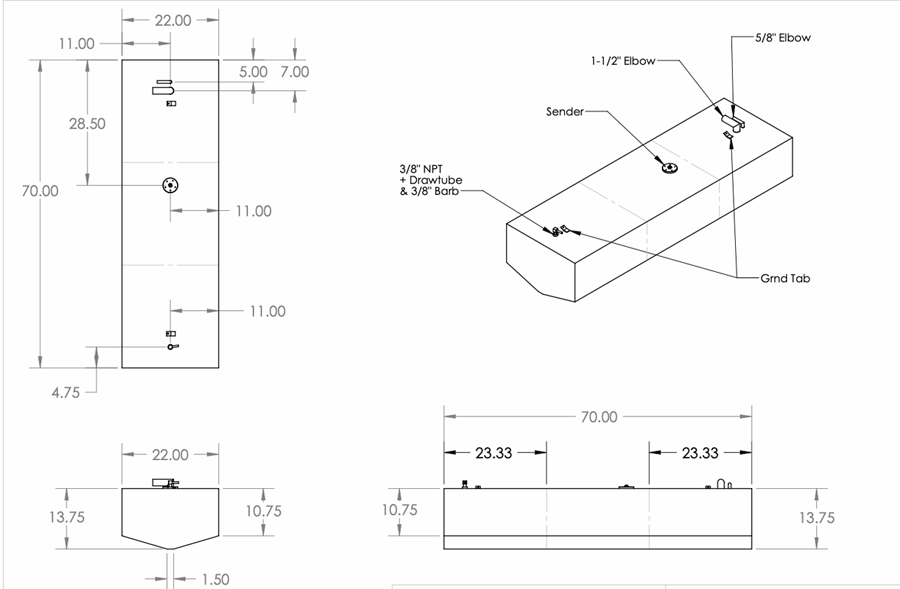

Here are the dimensions [Luther's] are using which match some searches I have done about a 20' tank:
Fig. 1. Tank Dimensions from Luther's for 77-gallon Boston Whaler OUTRAGE 22 tank.
Larger image at https://postimg.cc/PPKgYb68

ekalb wrote:Is the 77-gallon fuel tank in an OUTRAGE 20 identical to the 77-gallon fuel tank in the OUTRAGE 22 of the same era?
As far as I know the hull of the OUTRAGE 22 and OUTRAGE 20 are very similar--identical really except for the aft two feet. From what I can see, the only difference in the hulls occurs aft of the fuel tank cavity. I would expect the 77-gallon fuel tank dimensions are the same.
But I understand your reluctance to commit to an expensive custom-order tank without some additional confirmation. I recommend you contact Boston Whaler customer service and ask them for a confirmation.

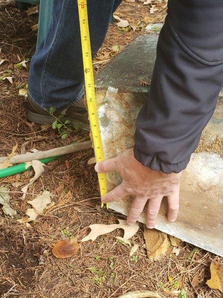

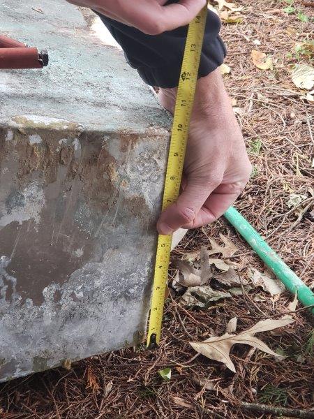

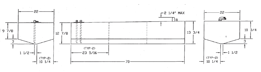

I recently purchased and installed a 77-gallon tank from FMT. The dimensions shown on your original post are slightly different from the dimensions of the tank I removed from my 1989 Revenge 22. Your drawings reference a constant side height of 10.75-inches. My original tank and the replacement tank both had a varying height from 9.875 to 10.75-inches. The 9.875-inch dimension was at the aft end and the 10.75-inch dimension at the forward end. I don't think there would be enough clearance for an additional 7/8-inch of height at the aft end.
Though I could be wrong.

I hesitate to provide the exact drawing that was provided from FMT but I will provide the following pictures and diagram.
Fig. 2. Aft Starboard Corner
Fig. 3. Forward Starboard Corner
Fig. 4. Fuel tank dimension for OEM fuel tank
