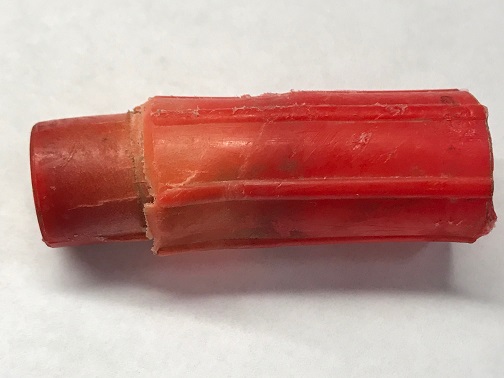

On a 1968 Boston Whaler 13-footer, one of my kid's friends tripped over a partially inserted oar and tore the bronze receiver right out of the gunwale.
I have contacted Caplugs, the gunwale insert manufacturer, no luck yet
I might 3-D-print one if I can get good measurements from the parts.
The insert prevents the oar yoke from getting water into the hull.
Has anyone ever fixed one of these before?
Any insight would be appreciated.--Doug
Oarlock break-out at gunwale, part way through foam removal.
gunwale 1 sm.jpg (43.41 KiB) Viewed 6527 times
Profile view of oar lock insert: Caplugs # B-178
Caplugs profile sm.jpg (50.34 KiB) Viewed 6527 times
End cap with manufacturer and model # of oar lock insert
Caplugs end sm.jpg (19.1 KiB) Viewed 6527 times

West system epoxy with fillers.
And here is a new socket if you need one.
https://www.jamestowndistributors.com/userportal/show_product.do?pid=298
