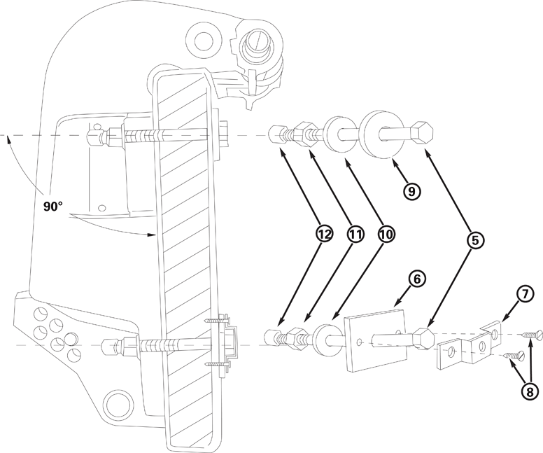

The instructions for engine mounting from EVINRUDE, a company that has over 100-years of experience in outboard engines, specify that the engine mounting bolts are installed with the bolt HEADS on the inboard side of the transom, and the nuts are on the outboard side of the transom for mounting larger engines. See diagram below:
Fig. 9. Drawing from Evinrude showing engine mounting details with bolt orientation. Note the use of retaining straps to hold the mounting bolts in place before the engine is lifted onto the transom. From "Predelivery and Installation Guide "for E-TEC engines.
Were I to install an outboard engine, I would follow the method that Evinrude requires, rather that adopt an opposite orientation of the engine mounting bolts through the transom.
By using the method required by Evinrude, I see advantages in the application of sealant to the portion of the bolt that is passing through the hull. The bolts can be pre-installed in the holes and pre-coated with sealant.
In Figures 1 and 2 above show the engine mounting bolts are installed in the opposite direction than recommended by Evinrude.
In Figures 4, 5, and 6 above the engine mounting bolts are installed in accordance with the recommendation by Evinrude.
