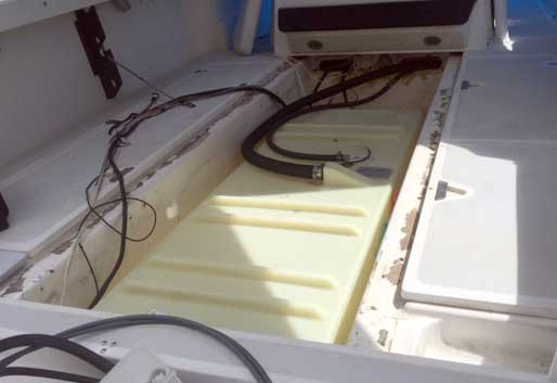

This thread will document my replacement of the original fuel tank on my 1995 24 Outrage. The project is not a big one, I thought, but pulling the tank was not easy. It was a pain getting out the old tank. I did it all alone and on my drive way.

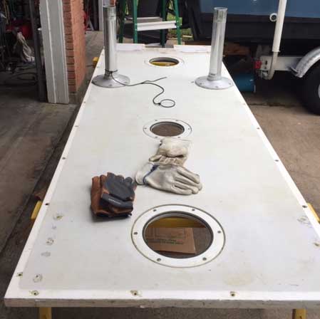

I had a very hard time getting the deck up. I used 3M4200 to put it down last time I had it up. Wow it was glued down like you would not believe. I used Debond around the deck with pressure on it with a 4x4 across the gunwale. And was able to get it off. It took a full day of waiting for Debond to work. That stuff is $30 a can but worth every penny.
What I didn't know is that the tank extended beyond the deck so I had to remove transom splashwell deck also. Which was much easier than the main deck.
Once both decks where off I used a pressure washer to cut the foam on the sides. Once it had the foam cut away I still had a solid stuck tank in the deck. With some research I was given the idea of while pressure was on the tank lifting the tank, using a prybar and 2x4 to pry the sides until it cracked loose.
To get the tank out I lifted it up and cut into4 sections and tossed each out. This took 1 full day. And I bought a new Dewalt Saws-all and a bunch of blade. I love Dewalt tools.
Now that it is all out I used the pressure washer to remove the rest of the foam and pressure wash the tank cavity. To cut the foam I used a 0 degree bit on the pressure washer.
As always, I am just in awe of the quality of Boston Whaler construction. Under the splash deck and inside the tank cavity the gelcoat is all clean. I love working on Boston Whaler boats because time spent working is rewarded by seeing the builder's craftsmanship. The boat is designed to be worked on. They put lot of thought into this design to make it easier to do repairs.

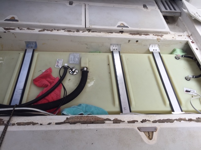

[The new tank] is a 111-gallon Moeller. The side angles matches the tank that came out. This also matches the cavity bottom angle., and the new tank filler lines up with the deck plates. Thank god for all that matching up.
Original plan of building a shelf is not needed. The bottom of the tank locker is actually flat. So I am going to build up with cut [rubber] mats. The whole tank will sit on rubber mats.
The installation plan is to let the tank sit against the rear bulkhead against rubber mats. Four aluminum flat strip hold downs will go on top of the tank. They also will have rubber under them.
Poly tanks will swell when they have fuel in them. The last bracket that screws into the front of the tank that will be installed after I put fuel in the tank. Then the deck will go back on.
I think the hard part is over. I have installed tanks before in Boston Whaler boats, so I hope things will get better. Cutting that tank up sucked. I wish I had taken a picture of the lift set up. It consisted of eight 4x4's, wood blocks, two concrete blocks on end, and a cable crank lift.

Not shown are rubber mats on the sides, below, and behind the fuel tank, and on the starboard wall that the tank will rest against. The new fuel tank touches only rubber mats on all sides.

I got the 1995 OUTRAGE 24 buttoned up with deck back on. Putting it all back together is sort of anticlimactic.
I hooked up an 8-AWG grounding or bonding wire to the tank and to the fuel fill, and connected it to the negative pole of the battery, which is directly connected to the outboard. This is the engine battery, not house the house battery, but both batteries are connected together with a large battery cable.
I got all the batteries back in the console and all battery cables are hooked back up.
The rear deck and the main deck are all sealed down with 5200--haha just joking after all the trouble I had 4200. Big mistake 4200 is an extremely strong adhesive. That deck was hard to get up. I used Boatlife LifeSeal for all screws and seam seal going around for the reinstall. I love BoatLife. It is great stuff. It is very easy to use, holds it position, and doesn't sag like 4200.
Now I need to test run the engine in the tank again and give the boat a thorough cleaning.
Since I have a gasoline station five minutes from my house with Ethanol-free 92 octane, the new fuel tank will never get Ethanol in it.
