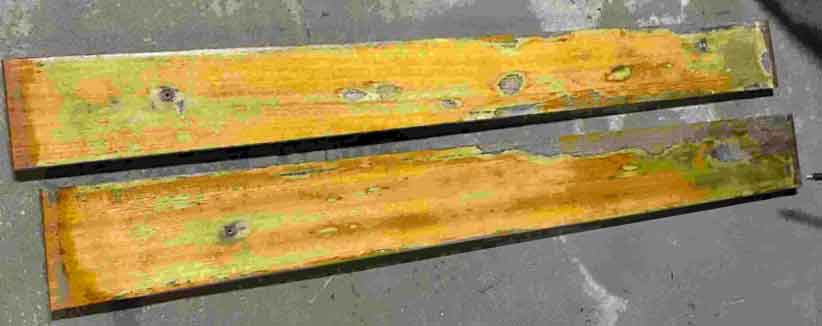

Stage 1 completed. We removed all the railings and almost all of the wood tonight, with the exception of the steering. Luckily, all of the holes in the fiberglass are in great shape, so we'll be able to get away with simply putting silicon in them instead of making repairs with epoxy.
Fig. 2. Broken seat board.
When we removed the main seat board, it came off in two pieces. Is there a marine wood glue that can be used to get it securely back together?

To repair the broken seat:
To join two boards to make a larger board, make several mortise cuts into each board and use several loose biscuit tenon inserts to join them. Or join the boards with dowels. A wood glue that is waterproof should be fine as an adhesive. Add two or three new smaller boards as reinforcement on the underside of the seat running across the break at a right angle. Or replace the broken board with new.

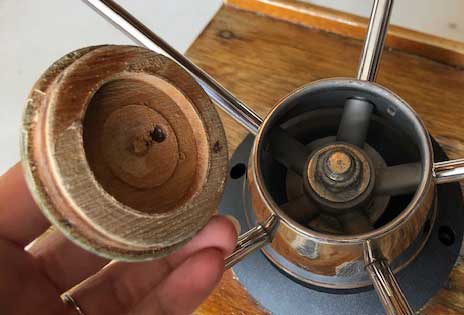

To update on the cap: We didn't have a heat gun, so we gently tapped a flathead screwdriver into the seam between the wood and the steering wheel, and eventually were able to pop it off. Turns out it was just a press fit, and it seems like it'll go back in without too much trouble.
Fig. 4. Steering wheel center cap removed from press fit into wheel.

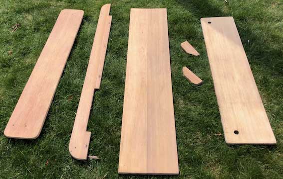

We're making slow progress on the sanding but getting there. We have almost all the boards down to the original wood.
Fig. 5. Original wood components with old finished removed by sanding.
The exception is the main seat. We are still debating what to do with it, but we might just replace the whole piece.
Fig. 6. Boards
We've read that the original wood on these older models was Phillipine Mahogany, but that wood has been taken out of use for environmental reasons. Now people are using Sapele , an African wood.
Will Sapele wood look close to the other pieces?
Are there better woods to use?

Given the old growth of the bench seat, I would reattach the two parts and add wood cleats on the back side to give the board support. Use Gorilla glue and clamps.

Congratulations on removing the wooden press-fit center cap from the steering wheel.
The newly cleaned and sanded boards look good.
My advice on how to repair the broken board for the seat remains the same.

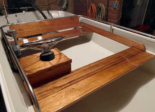

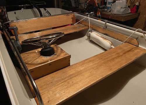

We finally got our little whaler back together. It was a much bigger job than we expected. In the end, we:
  • Removed the console, and sanded down ALL the wood to bare wood, applying eight coats of varnish.
  • Replaced the corroded T-joints on the side. We ordered these from CMI Marine and I have mixed reviews if anyone is looking for input on using them for your own project (Namely: Don't expect to get anything done in a hurry.)
  • Used wood glue to glue the two seat boards back together, then installed two metal connectors under the seat.

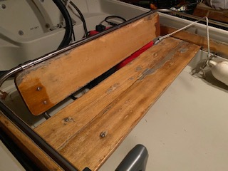

Fig. 7. Before refurbishing.
Fig. 8. After refurbishing.
We're very happy with how it came out. This little Whaler is looking presentable again. We enjoyed our first ride out on the water this past weekend. Thanks to all for the advice and input.

Looks very nice!
