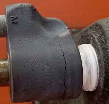

Fig. 1. [Moderator's caption: fuel connector at red plastic fuel tank with one long crack clearly visible.]
I found [multiple] small cracks on the connectors on the fuel tanks. I then suspected air was getting in the [fuel supply hose] line. Possibly the [FUEL SUPPLY MODULE] was starved for fuel.
When the engine ignition key is moved to ON from OFF, I see bubbles entering the low pressure fuel filter from the supply side.
I replaced the connectors. I have not seen the air enter the fuel filter, even though the low pressure fuel filter is not completely full of fuel.

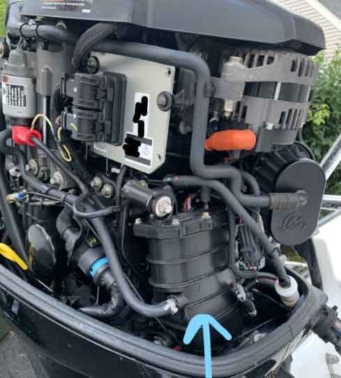

Fig. 3. [Moderator's caption: the engine cowling has been removed. The blue arrow points to the Fuel Supply Module.]
[The fuel supply module functions are:]
  • a low-pressure pump located inside that module fills the space inside that module;
  • a high-pressure pump pumps the fuel at a high pressure to the fuel rail and injectors;
  • a float switch controls operation of low pressure pump to run only at startup if the fuel supply module is not filled with fuel
  • if the fuel supply module is filled with fuel, then all is fine
  • after engine start, the ECM controls the both the low and high pressure pumps
  • a pressure regulator [limits fuel pressure in the fuel rail[/list]
The float switch is a common item to fail and caused by ethanol-gasoline blended fuels.
[I now believe the cause of the problem was not related at all to the Fuel Supply module illustrated several times above and the actual cause] was air being introduced at the connector on the fuel tank. If the fuel supply module was starved for fuel, that may have caused the engine to stall.
I replaced the connector [suspected of having an air leak at the fuel tank]. I ran the engine in the driveway for 30-minute. The engine seemed to to run fine.
To know for sure if the problem has been solved I will go for a test run.

Thanks for the several illustrations of the Fuel Supply Module and the detailed explanation of its operation.
You appear to have remedied the problem of the engine stalling by replacement of the defective fuel connector at the red plastic fuel tank. If this proves to have cured the engine running problems, then it appears there was no involvement of the Fuel Supply Module (or FSM) in causing those problems.
