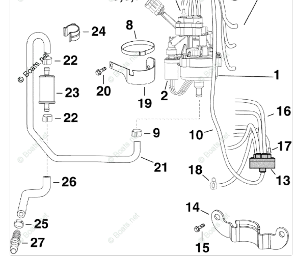

The filter is part number 5004958 and is on the oil line coming from the remote tank to the oil pump. It is show as item 23 on this diagram.

We really don't explicitly know which V6 200-HP is under discussion here, but from the illustration above we can infer it is the smaller 2.6-liter V6 model.
When doing your own repairs or maintenance on an expensive outboard engine, having the factory service manual is a very good investment. The cost is less than $90 and the manuals are really very well-written and extensively illustrated documents.

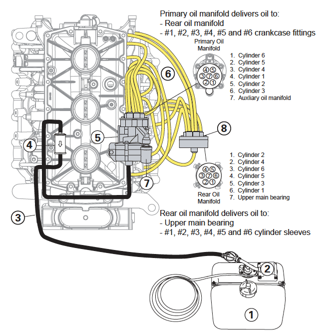

Here is the OEM diagram for the smaller V6 200-HP with the direction arrow shown on the in-line oil filter:
The factory manual notes:
The service manual also notes:
IMPORTANT: 60° Models – Arrow on oil filter faces incoming oil.
Oil Priming
The oiling system of the outboard must be primed:
- When the outboard is first installed.
- Whenever the oil supply to the oil lift pump is disconnected or disrupted
- Whenever an oiling system component is removed or replaced.
Refer to Oil Supply Priming on p. 70.
[From page 70'}
Oil Hose Priming
Insert the end of the oil supply hose (from the oil tank) into a suitable container. Squeeze the oil primer bulb to flow oil from the oil
tank. Once oil flow is observed, connect the oil tank hose to the outboard’s oil supply hose and secure with Oetiker clamp.
Oil Distribution Manifold Priming
Squeeze the oil primer bulb to flow oil from the hose connection, through the filter, to the oil pump. Visually inspect filter to ensure that all air has
been purged.
Continue squeezing the primer until oil flows through the distribution manifold into the oil distribution
hoses and to the crankcase fittings. All air must be eliminated from oil lines. Use Evinrude Diagnostics software to make sure the EMM is programmed for the type of oil being used. Start the outboard and use the oil priming function in the software for a minimum of 90 seconds to make sure the system is completely primed.
Observe oil flow through the oil distribution hoses.
Make sure that oil flows through the rear oil distribution
manifold to the cylinder block fittings.
Small bubbles are acceptable. Large bubbles must be eliminated through continued priming.
IMPORTANT: All clear “blue” oil distribution hoses on the powerhead should fill with oil as the air is purged from the lines.
Repair any fuel or oil leaks.
The oiling system can also be primed using the Self-Winterizing feature if diagnostics software is not available. Refer to STORAGE on p. 96.
