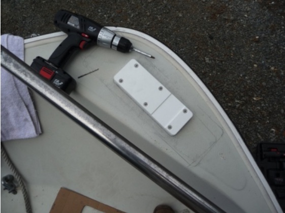

There are dozens of photos of mounting plates.
The difference between them is the number and location of holes into the bow pad area.

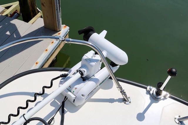

Typical mount:

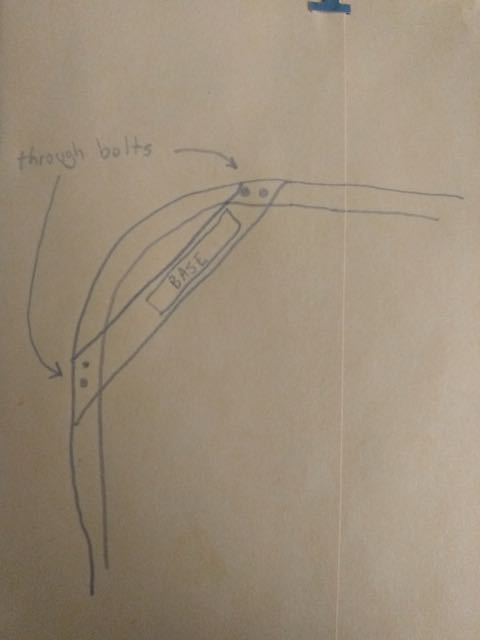

I have seen recently (but can't locate) an improved method of install where the base was attached to a backing material (HDPE or similar) that spanned the lip and did was through bolted. Here is my rough illustration:
Mount base to backing board that is bolted through the gunwale lip
This method avoids the possible water intrusion into the foamed cavity. The bolt holes are easily repaired if removed in the future.

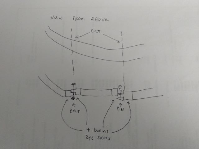

Also note a new approach to installing a bow trolling motor includes modifying the bow rail by installing a hinged section to allow the shaft to deploy and stow.
Additional information on adding a rail hinge is available.

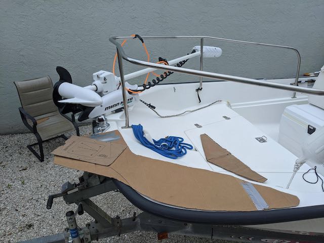

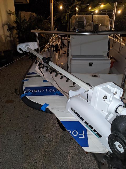

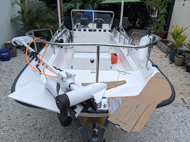

Here is what I am working with: I made a mirrored template on the port side however the motor will be mounted on the starboard side.
I flipped the template over to the starboard side and placed the motor in position far out enough to clear the bow rail.
So close! In this position the control head unit extends about 1" out the gunwale.
In order to get the control head inside the boat my options are to either move the motor base several inches forward to get more side clearance however then the motor base will be hanging considerably off the front of the boat. My other option is to cut the 54-inches shaft shorter to 48-inches; that will probably still work great for the waters I will be in. Am I overthinking this? Any advice or experience is appreciated.

Postby Phil T » Wed Sep 16, 2020 3:18 pm
On all the installs I have seen over the years, the mount only extends over the lip just so the motor can deploy.
Consider changing the angle of the base (not the mounting plate) so the motor stows inboard.
To clear the rail, you can add a hinge to the rail. Just need 4 bimini eye fittings and a hacksaw, nut, bolt and pin with safety wire. Here is a drawing to give you an idea.
