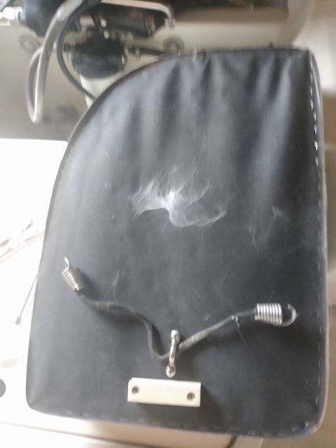

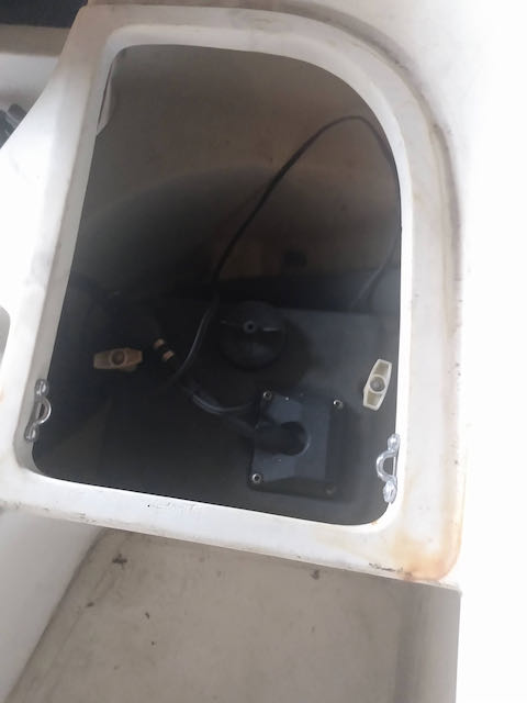

The original method for attaching the rear quarter seats included a shock cord and three eyes--far from a good method for many reasons. [See illustrations below.]
Figure 1. View of stern quarter seat from 1992 OUTRAGE 17. Seat cushion is removed. Two pad eyes attached to hull are shown.
Figure 2. View of stern quarter seat from 1992 OUTRAGE 17. Underside of seat cushion is shown with stretch-cord running through a center pad eye.

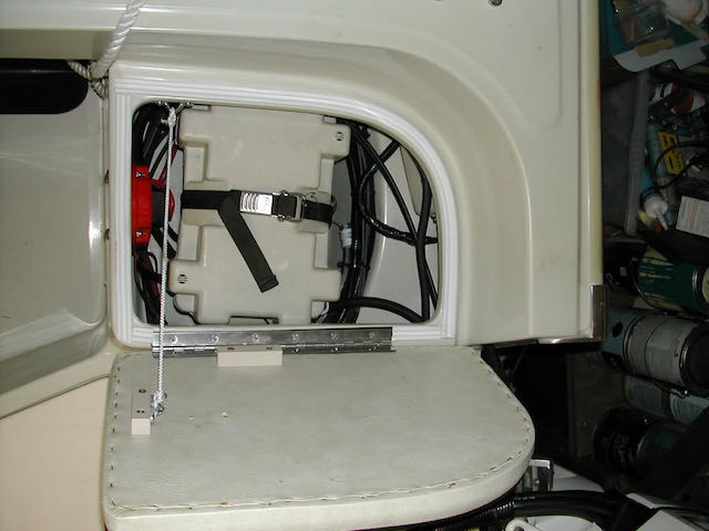

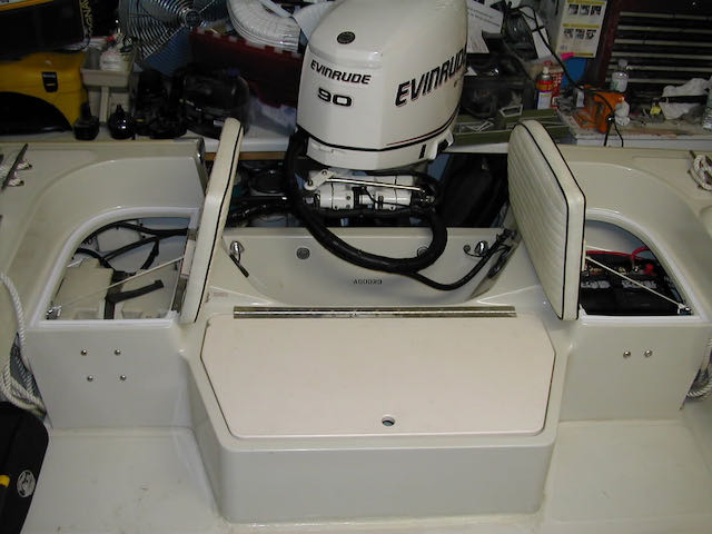

Here are two photos of the hinged method described in the video.
Fig. 3. Seat with modified method of attachment using hinge.
Fig. 4. Two modified hinged seats in open position.
