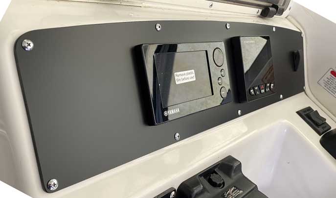

Postby ivansfo » Mon Feb 22, 2021 12:50 pm
I am happy to report my new panel is done. I ordered the plastic sheet from Decorative Plastics (as mentioned earlier in the thread by kwik_wurk).
https://shop.decorativeplasticsheets.com/main.sc
A sheet cost about $80, and the sheet is large enough to make four or five panels in the size I need--enough material for screw-ups.
Fortunately, I took my time and the first attempt came out nicey enough. The labor was quite intensive with basic shop tools, and now I can understand the charges by plastic fabrication shops.

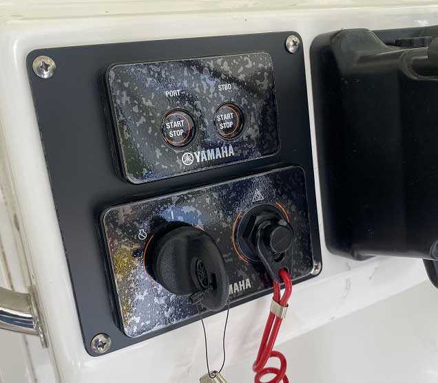

Also I used the same plastic panel to mount new Yamaha switches in the old cutouts left by the Mercury key switches.
Thank you all for the tips, leads, and advice.
Fig. 5. New dash panel.
Fig. 6. Holes from from old engine controls.
Fig. 7. New key switch panel covering old holes.
Re: OEM Instrument Panel Plastic
Postby Phil T » Mon Feb 22, 2021 1:36 pm
The panels look fantastic.
Can you detail the tools and techniques you used to produce the panels?

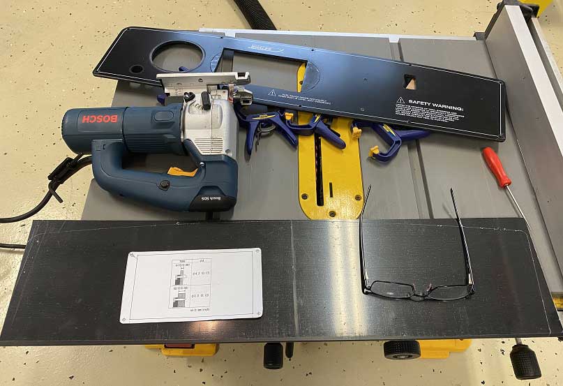

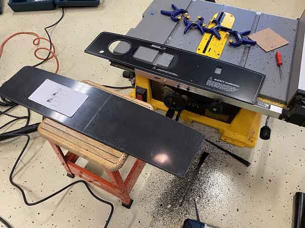

  1. Traced out the new panel using the original panel as a template.

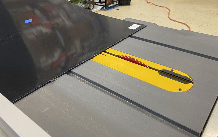

  2. Cut out a new panel using a table saw for the straight edges. For non-straight edges, used a jig saw. Equipping the saws with fine tooth blades seemed to help quite a bit.
  3. Again I used the original panel as a jig to drill out the matching screw holes.
  4. Used a palm router to chamfer the perimeter edge. Tiny detail but I wanted to match the original as much as I could.
  5. Used a jig saw and files to cut out the openings for the new gauges.
There was a lot of filing and sanding in between these steps. The most challenging part is not to make a mistake that was bad enough to warrant starting all over. So measuring twice or even three times before cutting is essential. There are imperfections in this first attempt but I'm going to leave it as-is for now. I currently don't have the patience to try making another. And as you can see in the following pictures, the job is messy.
Fig. 8. Large sheet on a table saw.

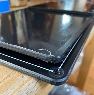

Fig. 11. New and old panels stacked together.

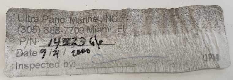

ASIDE ON A DIFFERENT PANEL: as I was working on the circuit breaker panel over the weekend, adried up label dropped from the circuit breaker panel. The original vendor for the circuit breaker panel was identified as Ultra Panel Marine in Miami, Florida. If anyone needs a circuit breaker panel from [a 2001 CONQUEST 23], it may be worth the time to contact them.
Fig. 12. Manufacturer name tag.
[Moderator’s note: the OEM circuit breaker panel is NOT the panel being replaced that appears in the several illustrations in the thread.]

What is the part number for the OEM circuit breaker panel? It is a bit hard to read the number from Figure 12.

The thickness of the plastic sheet for the panels as seen in Figure 11 surprises me. What is that dimension?
Your cut for the curved upper edge of the panel looks good. Nice work with a jig saw. I suspect there was some sanding. I like the edge bevel on the panel.

jimh wrote:The thickness of the plastic sheet for the panels as seen in Figure 11 surprises me. What is that dimension?
Thanks Jim. The plastic sheet I purchased is 3/16" thickness. This is what Decorative Plastics recommended for boat instrument panels. The thickness is an exact match to the original Whaler panel.
After cutting with a jig saw, there was indeed a lot of sanding. I could have wet sanded to even a smoother finish but it's good enough.
