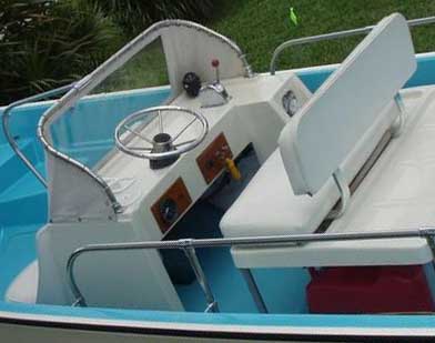

The unusual console of a KATAMA can be seen in CETACEA. See
http://continuouswave.com/whaler/cetace ... age30.html
Use a top-mount remote engine throttle and shift control. Mount it on the console top surface.
Fig. 1. A KATAMA console with top-mounted engine remote throttle and shift controls.

I had a Minot and that boat shipped with the same side console that was used in the Katama. In my boat, the engine control was mounted to the side of the vertical console leg that would be next to the driver's right leg when he is seated at the helm. There is a partial picture of this on Cetacea page 33:
http://continuouswave.com/whaler/cetacea/cetaceaPage33.html
- Ron

The photograph mentioned above is shown below:

I think the positon of the throttle in relation to the steering wheel in both photos is deficient.
Personally, I would place the throttle closer to the steering wheel.
If you are going for authenticity, you can install a new Morse binacle control with a separate trim switch for your new Suzuki.

Phil, I understand your perspective on the distance between the steering wheel and the engine controls but I found the side mounted control unit to be very natural to use. These older 16/7" boats are not very wide and when seated at the helm, my hand fell naturally on the throttle control. The added advantage to mounting the control to the side of the console leg is the extra horizontal console surface that is available for laying out a chart book or for mounting a chart plotter and a VHF.
