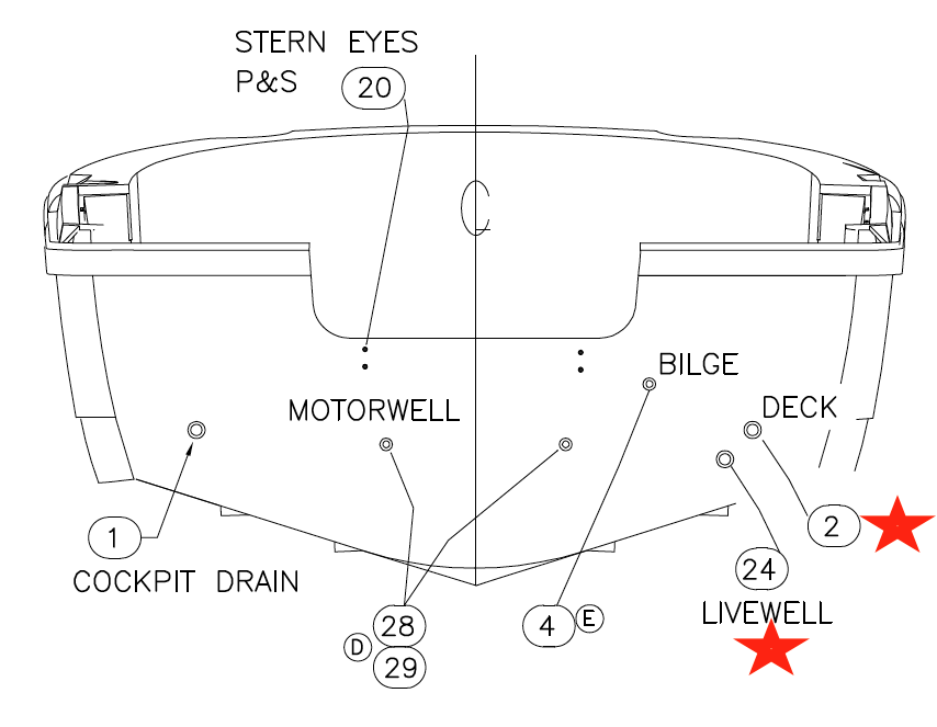

Inspect the entire deck drain assembly.
Fig. 1. Drawing of transom showing fittings. Note fittings identified by callout numbers 2 and 24, identified by name as DECK and LIVEWELL, and marked by RED STARS.
Nantucket 190 Through Hulls Transom.png (76.15 KiB) Viewed 4026 times
On the starboard side deck drain there is a rubber hose that connects the through hull to the deck drain. The rubber hose tends to shrink with age and pull either the deck drain or through-hull fitting--both plastic--until one of them brakes.
If the 2005 190 NANTUCKET boat has a live well, then inspect the live well plumbing, both the intake, under the boat, and the evacuation, carried out the transom.
