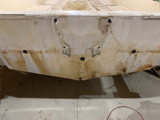

I am renovating a 1985 Outrage 18 I acquired early in 2021. This 1985 OUTRAGE 18 boat sat outside for several years with no covering. I live in northern Michigan [later mentioned as in Charlevoix area]. The boat was exposed to several winters.
I've decided to remove everything to see what I will be working with. I have removed the 1989 150 HP Yamaha two-stroke-power-cycle engine, the console, the deck, and fuel tank.
The hull seems to be in decent condition except for a large crack along the top of the transom. The transom seems very solId.
After removing the three brass drains in the transom, I discovered the wood is very solid but a little damp.
There is also a drain plug at the very bottom near the keel. This drain was unplugged was open when I got the boat and no water comes out even when I lift the bow.
Fig, 1. Note unusual situation with four drains in transom, including one just above keel.
Q1: What does the drain at the bottom near the keel drain?
I thought [the Unibond hull of Boston Whaler boats] are filled with foam.
Q2: Could [the drain at the bottom near the keel] have been installed by previous owner?
Q3:[ do readers have] any idea [what drain at the bottom near the keel was for]?
Thank you [for reading this post].

There is also a drain plug right at the very bottom near the keel. It was open when I got the boat and no water comes out even when I lift the bow.
Any rain or deck water enters the sump in the aft starboard corner, forward of the splashwell front wall. There is also a drain from the center fuel tank cavity into the sump. This water exits down and through the drain tube. There is a Perko clamshell cover partially covering the drain tube to create a vacuum to pull the water out.
Typically the sump drain is plugged from the inside.
Some owners install a bilge in the sump, some do not.

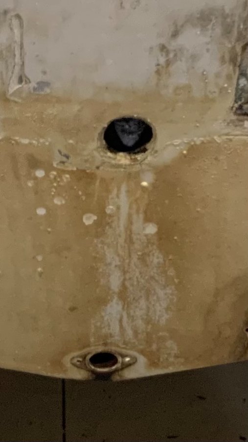

I've found the drain in the aft starboard corner. That was plugged with rotten pine needles but I cleaned it out. There was a sump pump there, too, pumping water out the starboard gunwale. The forth drain I'm unsure about is on the very back of the boat about one-inch above the keel [See Figure 4 below]. It had a screw-in plug, I removed the plug to investigate. I stuck in a long screwdriver to see how deep it went and it only was about six-inches deep.
Fig. 4. A close up of the drain hole at the bottom near the keel.

Someone added that. Not a good sign.
Typically novices add that in the misguided attempt to drain water from the foam. This is misguided.
Inspect and shine a light inside. Do you see exposed foam? If damp, use a hair dryer to get surface dry, Fill with expanding foam and then seal with fiberglass and resin and finish with gelcoat.

JamesA2021 wrote:Q1: What does the drain at the bottom near the keel drain?
Apparently this hole leads nowhere, as you describe in your narrative. If it only goes in six inches, then it will only drain the water that collects in the space of the six inches of the hole.

JamesA2021 wrote:Q2: Could [the drain at the bottom near the keel] have been installed by previous owner?
That is certainly a possibility. I have doubt it was there when the boat left the factory.
JamesA2021 wrote:Q3:[ do readers have] any idea [what drain at the bottom near the keel was for]?
About all that can be guessed is someone thought it would be a good idea for some unknown reason to drill a big hole in the transom of their Boston Whaler boat.
The OUTRAGE 18 boat has a shallow engine splash well that is a full width splash well. I have never seen a drain in the hull that was at the keel on the transom and goes nowhere. This was never done by Boston Whaler. NEVER.
Since you just bought the boat a few months ago, perhaps you can contact the seller of the boat. Ask the seller of the boat about this unusual transom drain that goes nowhere just above the keel.
It is a shame that the boat was modified this way. The keel is the strongest point of the hull. If someone has bored a 1-inch diameter hole into the hull for 6-inches, they have weakened that area.
To have no water come out from this added hole after you removed the plug is a positive sign: there was no water trapped in there.
I agree with Phil: repair this unusual added hole in the hull that is well below the waterline. For advice on how to make repairs to a Boston Whaler Unibond hull, see several articles on that topic in the REFERENCE section.

JamesA2021 wrote:I am renovating a 1985 Outrage 18 I acquired early in 2021.
Regarding the restoration of this fine 1985 OUTRAGE 18 boat, you have a lot of work ahead of you.
If the hull is being stored indoors in a heated area, make sure all the moisture surrounding any of the FOUR holes in the transom is dried out. I would let the boat sit for several weeks while in a hot, low humidity environment. Then check for the presence of any moisture in any of those four holes.
The non-factory hole at the keel should be repaired.
The three engine splash well drains should be replaced. See the FAQ for advice on how to repair brass drains.

JamesA2021 wrote:There is also a drain plug at the very bottom near the keel. This drain was unplugged was open when I got the boat and no water comes out even when I lift the bow.
I hope the drain was unplugged when you got the boat because the previous owner had recently removed the plug while the boat was out of the water. If the previous owner left that hole unplugged while the boat was in the water, there is good reason to be very concerned about water getting into that area.
If the boat was left sitting outside with that hole unplugged, there could have been some water enter from rain dripping down the transom, but that would not be nearly as much concern as if the boat was operated in the water without that hole plugged.
Again, having now water flowing out of that hole at the present time is a good indicator.
