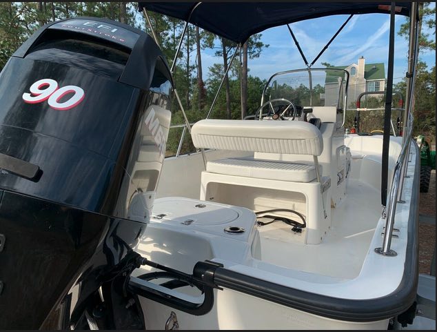

Consider a Montauk 170. They started to offer a baitwell or livewell option forward of the splashwell in 2007.
Fig. 1. A 2008 170 MONTAUK with the optional stern livewell set forward of the engine splash well.
The Montauk 170 is a much better riding and handling boat. It is still 17-feet, and it can be handled solo.
