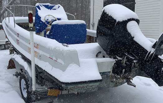

Fig. 1. A boat with a covering of snow.
Fig. 2. Boat with covering of snow.

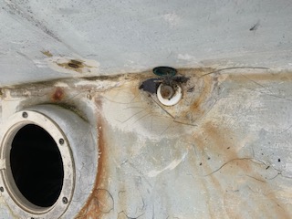

Figure 3 shows a bolt in the [floor] of the engine splash well. I can reach down and feel a bracket inside, which may be a superstructure hold down during bonding.
Fig. 3. View of engine splash well bolt.

Postby jimh » Sat Apr 09, 2022 8:41 am
In my opinion, Figure 3 shows a bolt that is probably a non-factory modification to the hull.
