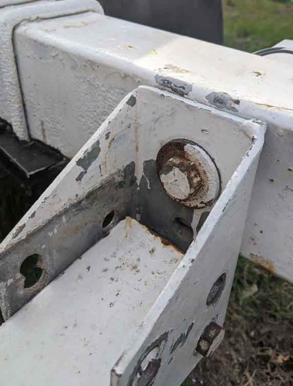

On my single-axle roller trailer, where the rear crossmember joins the side rail of the trailer, the crossmember has a bent over part (a tang) that rests on top of the trailer frame and a single bolt that holds it in place. The bent over part appears to be bending up and coming off the frame. This will result in only the bolt holding the cross member onto the frame of the trailer.
Fig. 1. In this view the longitudinal frame of an old trailer is seen at the point of attachment of a crossmember. A tang on the crossmember is supposed to be sitting flush on the longitudinal frame, but appears to have been bent upward. The cause of the bending upward is attributed to excessive weight bearing on the tang.

Why does the rod sit under the frame? Is it to keep a cross member from going upwards when you go over a big bump in case the bolt fails? I just see no use for that rod in the position it's in.
In [Figure 1] there is a 9/16-inch rusty bolt that holds on the crossmember bracket. Above that bold the bracket [tang] curves over the top of the trailers side rails. This set up give the crossmember two support point: the bolt as one and the tang bearing on the frame. The [tang] is stretching upwards signalling to me that the bracket and possibly the bolt are weakening. [That sign of weakness that I perceived by the bending of the tang in the single-axle trailer was the reason I bought the used] tandem axle trailer.

I thought [the trailer manufacturer] would put the [welded-on ]rod [on the crossmember bracket] on top of the frame to add support to the bolt. I removed the 1/2-inch rusty bolts on my Venture trailer and replaced them with Grade-5 5/8-inch-diameter bolts. I hammered down the tangs and added U-bolts to keep them down.
