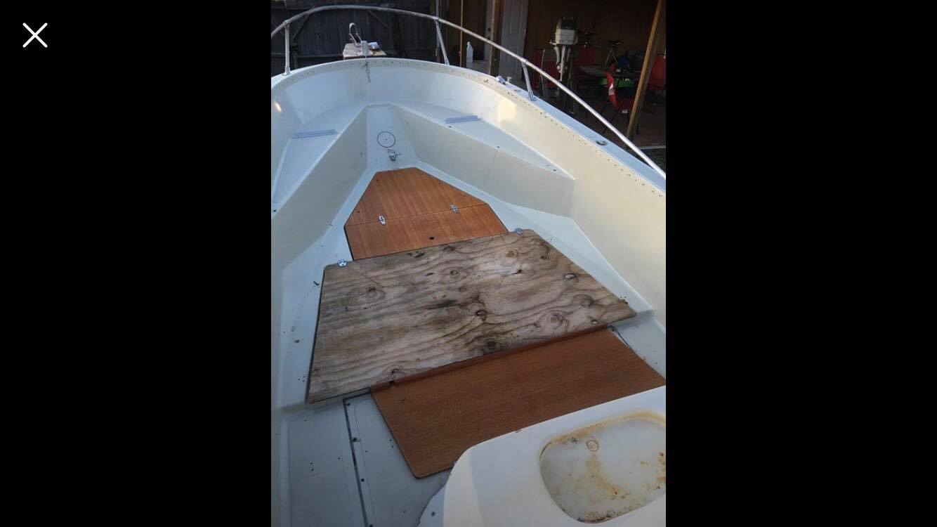

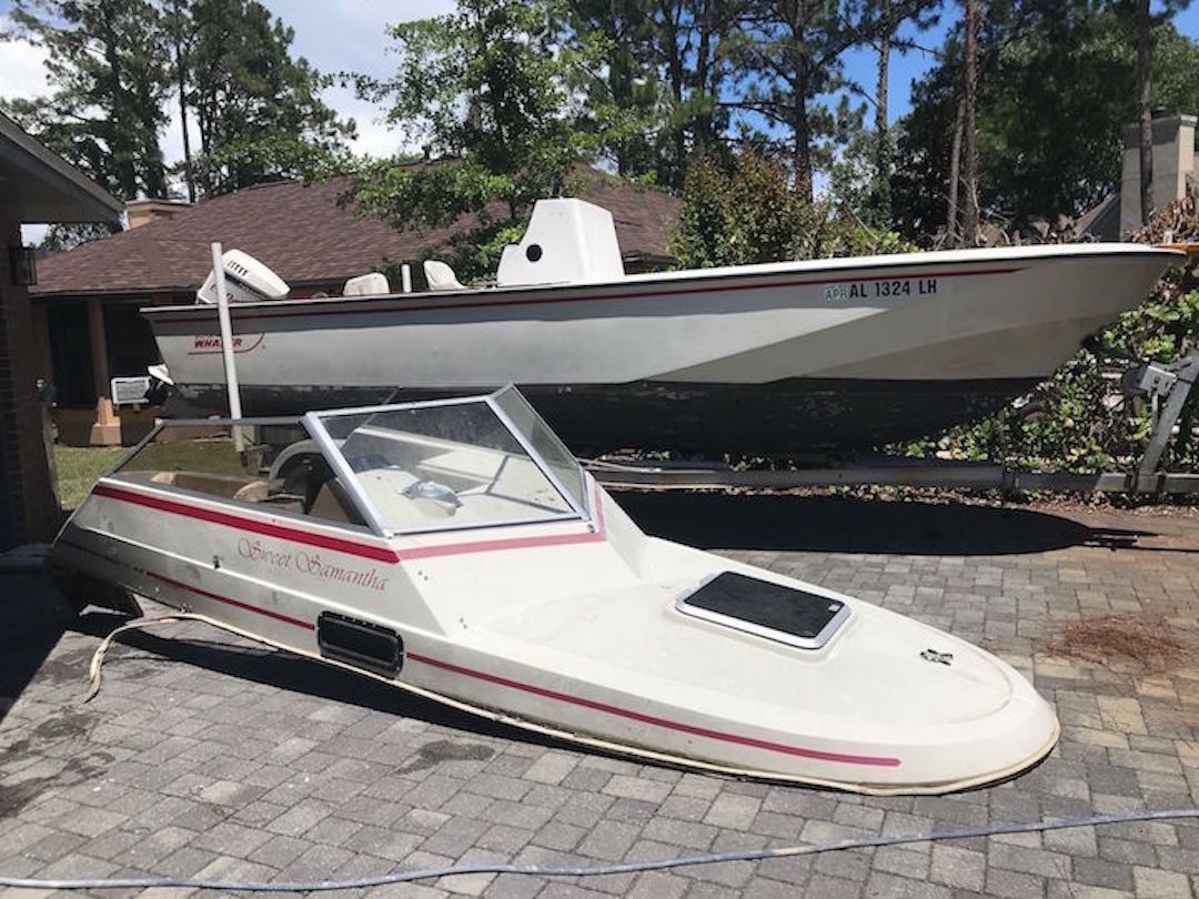

The boat is a 1980 Revenge 22 BUT the cabin was pieced out, removed and halfway converted to a center console. I drove down to Alabama to get her, thinking I could re use the cuddy. After bringing it home and further inspection it is not feasible. Most of the wood support pieces are rotted and lots of cracks in the cuddy. So.. as the title implies, Sweet Samantha is going topless. My plan is to finish converting her to a center console, I know i know, some people will be mad about me not restoring back original but its just not possible without a ton of money and time. The way I reason it, Im saving her from the boneyard.
The good:
-Hull seems to be in good shape
-1998 Evinrude Oceanpro 175 runs great
The bad:
-Entire boat needs thorough cleaning
-Needs new bottom paint
-Two soft spots in Deck
-Gunwales are rotted
-Lots of unsealed screw holes
-Cuddy rivet holes
-Bow rail holes
-Center console holes
-Will have to make new deck lids
-Needs new center console
-Redo wiring
The plan: Create a decent looking center console with T-top boat. Doesn't have to be a showboat, it will mostly be used to scuba diving and spearfishing around Panama City Fl. My #1 priority is getting all of the holes sealed to prevent further water intrusion. Will be looking for new center console as well as this one is ugly as heck. I'm planning on making a for sale post for the Cuddy windows and parts, not sure what they are worth if anything. I will take pictures throughout and keep y'all updated on my progress. If anyone has any advice for me or knows of other posts I should read please let me know. Also, since I'm new to this forum and forums in general, if I am doing something I'm not supposed to, also please let me know. I won't take offense to it.

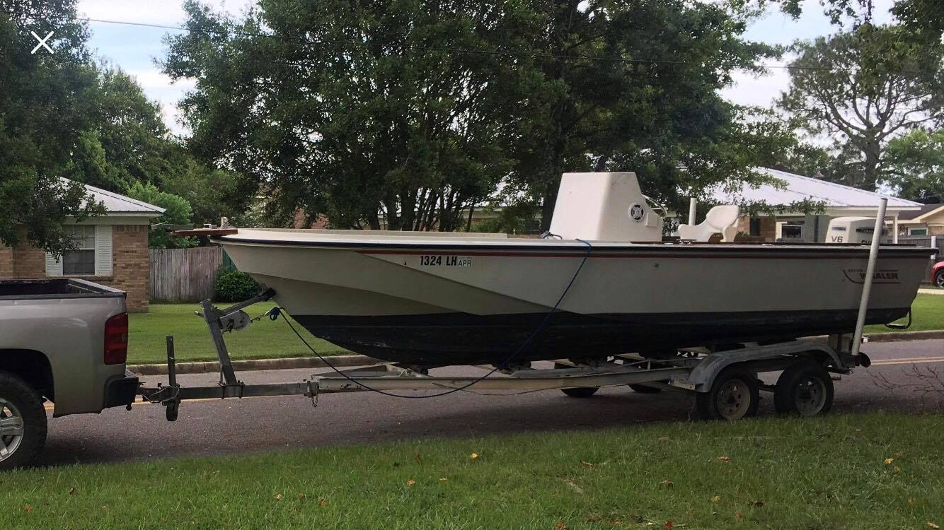

Hi, Phil. I couldn't find my way back to my account so I made a new one. Sloppy of me -- sorry, Jimh!
Just ran across these 2018 pictures of my former boat, which seems to have changed hands multiple times and shed weight in the process since I sold it hastily when I moved from house to apartment in 2017. I wonder what has happened to it since.
