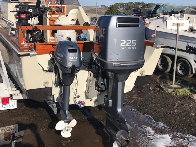

My 1980 Revenge 22 had a black ball scupper at both the transom drain and the transom side of the tube between the below deck fish well and deep motor well. They were original from the factory but no longer available so I replaced the one on my transom with a T-H Marine Flow Max Ball Scupper. There wasn't enough room to replace the factory ball scupper inside the deep well transom so I now use a plug inside my below deck fish well to keep it from flooding with water from the motor well. From what I can tell from your pictures the T-H Marine or similar Ball Scupper was used and your pictures only show the base plate.
The transom on the 22 Revenge and Outrage hull's are very low and water easily washes over the transom into the deep motor well. If there is not a ball scupper in the transom drain there is no way for the water to escape the motor well unless you were to install a bilge pump. Apparently the factory chose the ball scupper as a check valve to allow the deep motor well to drain.
Due to additional drainage I have installed. I now have 6 of the T-H Marine Ball Scuppers on my Revenge 22 which are going on their 4th season and drain extremely well while the boat is on plane, and allow very little water intrusion while the boat is not on plane.
Here is a link to one on Amazon: [bad link removed--please give a better URL]
Here is a picture of my 1980 Revenge 22 that shows the T-H Marine ball scuppers
Whaler pic full transom both motors and scuppers.jpg (121.73 KiB) Viewed 5482 times
