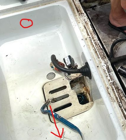

I have a 1997 17 Outrage II. When I open the aft deck locker to check the for water, sometimes I see water dripping from a hole in the locker on the starboard side.
Fig. 1. View of aft deck locker of 1997 17 OUTRAGE II. The water ingress is occurring in the approximate location of the red circle, but on the other side, as indicated by the red arrow.
Q1: from where is this water coming?
Q2: what size plug is needed to plug an aft cockpit scupper on a 1997 17 OUTRAGE II?
Q3: is there a concern if the aft cockpit scuppers are below the waterline most of the time?

Give me an idea on the source of the draining water. It's intermittent but I'd still like to know.

The hole in the starboard side of the locker connects to the rigging tunnel. If you look under the starboard quarter seat in the stern you can see the aft opening of the rigging tunnel. If the boat is sitting low in the stern it is likely that water is entering the compartment under the quarter seat and making its way into the rigging tunnel. The compartment drain can be plugged, but then will likely fill with rainwater over time.
