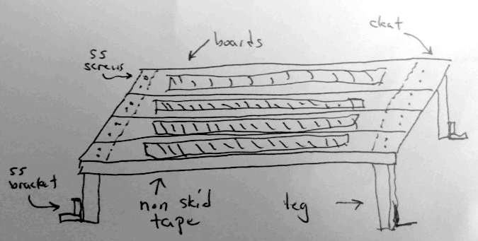

Fig. 2. Raised platform concept drawing
For ergonomic reasons I would have the platform cover the distance from the console to the seat base and be the width of the console.
It should be secured to the floor and have non-slip tape on the top surface. Sand the edges.
It can be easily made from standard board lumber. Painted white and apply non-slip tape on the surface. Use 2 small stainless L brackets to keep secure.
