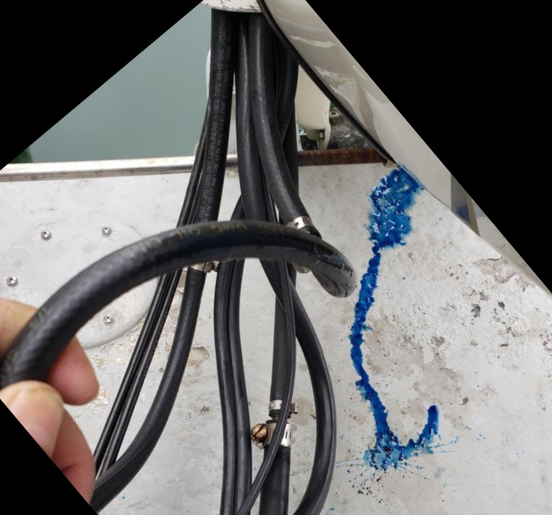

Later, a blue substance was found. See Figure 1.
Fig. 1. A blue substance found near the engine.
I am guessing [the appearance of the blue sunstance is caused by] loose hose clamps, which may not have been properly tightened.
Or, maybe the oil hose is cracked.
Or, a maybe a fitting joining the oil hoses is broken.
I have concern about the shuddering and fib-fub-fub sound.
Q1: what is the [your assessment of the cause of the initial red alarm lamp, the fub-fub-fub sound, and the blue substance leak]?
I don’t want to risk ruining the engine.

I don't know what caused the red alarm lamp or the fub-fub-fub sound or the appearance of the blue substane, but the next step I would take is to remove the engine cowling and make a close visual inspection of the engine.
I don't understand where the "red alarm lamp" was located. Please explain further.
What is your guess at the nature of the blue substance seen in Figure 1?
Is that a two-stroke-power-cycle engine oil?
