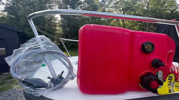

BACKSTORY: The original Moeller 6-gallon on-deck fuel tanks were beginning to crack on my 2014 170 MONTAUK with 2014 Mercury 90-HP EFI engine. I replaced those tanks with new [Moeller 6-gallon on-deck fuel tanks]. These new tanks came with a hose assembly with a primer bulb and quick-connects, but without a fuel demand valve. See the new tanks in Figure 1 below.
Fig. 1. New fuel tank without a fuel demand valve in the hose kit.

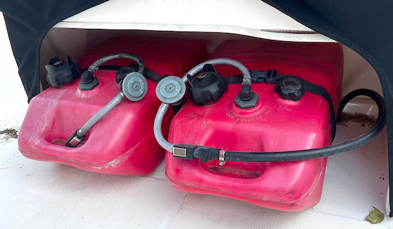

The old fuel tanks had a fuel demand valve in the supply hose line. See Figure 2 below:
Fig. 2. Each original fuel tank included a fuel demand valve in the fuel hose line located six inches downstream of the fuel tank pick-up connection. Each hose ended with a quick connector fitting. The fuel line to the engine had a mating quick-connect fitting.
I would prefer that each fuel tank have its own quick-connect connector mounted onto the tank itself to eliminate the tanks having their own short fuel hoses which flop around the boat during transport.

[The fuel system seen in Figure 2 above] is terrible setup.
The gray hose is not alcohol-resistant and is prone to degrade and contaminate the carburetors and fuel injectors. Replace any fuel hose that does not have alcohol-resistant printed on the outside.
