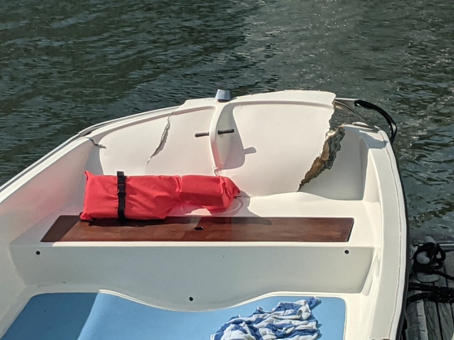

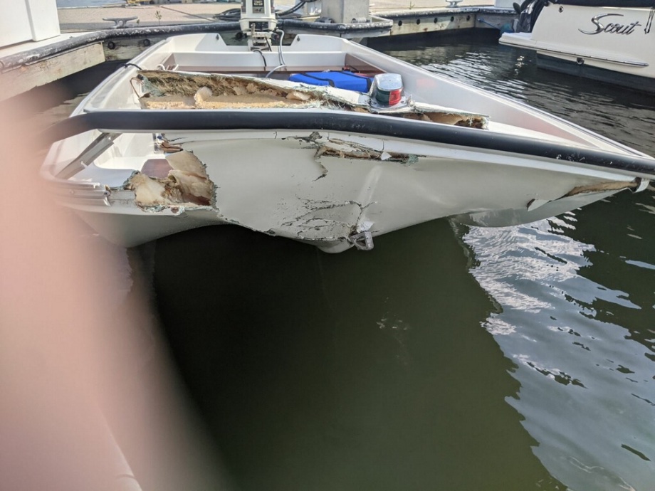

My 1971 13-footer hit a large object and damaged the hull above the water line.
Fig. 1. Damage to hull above waterline
Fig. 2. Damage to hull above waterline, alternate view.
Give advice on making a repair to a Unibond hull.

You are looking at $5,000 to $10,000 in repairs at a shop who has experience with Boston Whaler construction.

Repair to original condition would be very difficult and expensive. Even repair that restored the structural integrity of the bow at the sacrifice of all cosmetic appearance would be, in my mind, somewhat iffy.
One possible approach might be to find another hull of the same design, then make molds of the hull and liner in the areas of damage on your boat. The molds could then be used in joining the larger pieces of your boat back together. Or you might find a donor boat whose stern was severely damaged. The bow of the donor boat could be cut off and laminated onto your boat at a clean joint line made by cutting off the damage on your boat in the identical plane

I think I will strip [the removable parts from the hull]. The wood is in perfect condition.The engine and the trailer are also in excellent condition.
I will trash [the hull] and find a another Boston Whaler boat with no engine or trailer.
