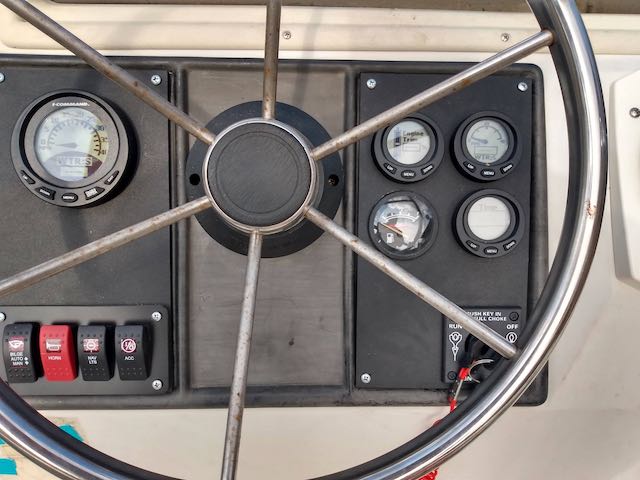

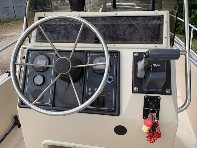

Here are two photos for comparison.
Fig. 1. Original helm console panels, switches, ignition and throttle from a 1993 Outrage 17.
Fig. 2. New KING StarBoard panels, BPR gauges, ignition switch, and a custom switch panel with select switches I designed and ordered from New Wire Marine.

The electrical switches in Figure 1 are at the lower right of the steerning wheel and are hard to see. They look like rocker switches, not COLE-HERSEE push-pull switches.
Boston Whaler typically used rocker switches from CARLING of the CONTURA family. Marine rocker switches can be very complicated in their designations, and many options are available for them. The options include:
  • the basic switch action, which can be two-position or three-position, with the contact action being momentary or continuous, single throw or double throw, single pole or double pole and combinations of those arrangements;
  • the electrical switch contacts and their arrangements;
  • the type of terminals on the switch housing, and
  • the option for switch illumination, including multiple color of illumination, and the inclusion of additional contacts for control of illumination.
A further difficulty in specifying a particular marine rocker switch is the actual switch mechanism and the physical rocker exposed actuating surface can be ordered separately and combined in many ways.
Because so many options for CARLING CONTURA rocker switches are possible, it is impossible to deduce from the narrative provided so far what the part number would be for a replacement switch.
The best approach in getting a replacement Is to make a careful visual inspection of the existing switch for evidence of a part number, then try to obtain an identical replacement from that manufacturer using that part number.
If no identifying marks remain visible, then locate a vendor who will let you send them the existing switch and they can deduce a replacement for it .
