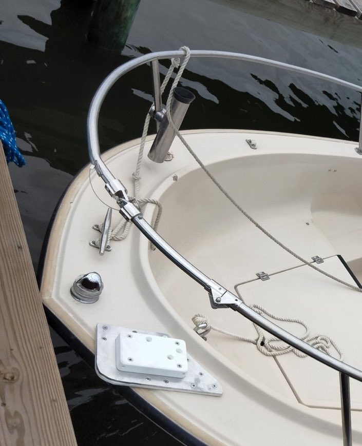

Hinge to the bow rail.
You can add a hinged section to the bow rail using either bimini eyes or a rail hinge fitting from Victory products.
Here is an owner's photo of his install:
Fig. 1. Modified bow railing with hinged section added.

Re the modification to the bow railing seen in Figure 1: you would have to be VERY keen on having a trolling motor on your boat to be willing to chop up the bow railing in the rather drastic manner seen in the photograph.
