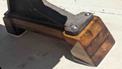

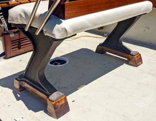

My latest project on my 1984 OUTRAGE 20 was to buy, restore, and install, and then modify an old reversible pilot seat (RPS) in poor condition that I bought from an on-line seller.
After initial installation, the original height of the reversible pilot seat was too low for my 6-foot 2-inch height. I decided to raise the height of the RPS by making wooden risers. The added height also makes the RPS into a nice leaning post when the seat back is in the forward position.
Sourcing the teak proved difficult. I found an old outdoor teak table on Craig's List for free. I sanded down all of the planks, and laminated them together, creating bigger lumber from the original planks, I used TiteBond-3 wood glue to laminate the planks together.
I carved the new teak laminated lumber to a shape which followed the contours of the base of the Z-legs.
I oiled the teak, and applied eight coats of varnish.
The new RPS risers are shown in Figures 1, 2, and 3, below:
MORE DETAILS

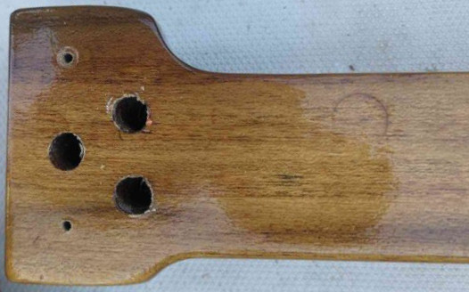

To fasten the risers to the deck, I drilled three counter-sinking holes [at a location described as] on each side of each bit. [Moderator's note: please give a more clear description of where the three counter sinking holes were located.]
I used #12 x 3-inch stainless steel fasteners to hold the new risers to the deck. I attached the Z-leg bases to the riser with the same size fasteners.
I put a sealant on the joint between the deck and the risers.
Overall, I'm very happy with how the project turned out. I think it looks good and definitely serves a purpose.

In Figure 2, I see three boards laminated into one timber, but I am not sure of the total height of the risers.
Q1: what was the total height of the risers you laminated from smaller planks?
Your narrative is a but fuzzy on how the new teak risers where attached to the deck. Please give a few more details on where the screw fasteners were located.
If you used 3-inch long fasteners, and the risers are about 3-inches thick, I presume you must have drilled holes several inches deep into the risers to recess the fasteners that will hold the risers to the deck. I suspect that those holes are hidden under the Z-leg bases.
Q2: if that is the method, did you make bungs to cover the recessed fastener holes?

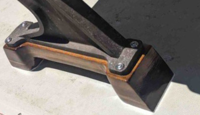

Details of how the new teak laminated lumber risers are attached to the deck are shown in Figure 5 below.
The mounting of the teak riser to the deck seems really solid--so far. The new risers raise the height of the RPS by 3-1/2-inches. The addesd height below the RPS provides more storage, and a cooler can now fit there.

With the riser height 3.5-inches, and the holes drilled to a depth of 1.5-inches, and the screw fastners length 3-inches, I presume then that about 1-inch of the screw fastener penetrates into the deck. That is a good depth for the screw to penetrate, as there is not much more than about an inch of material in the deck at that location. Also, you do not want to have the point of a self-tapping screw penetrating any deeper than that, as there could be a fuel hose of electrical wiring below the deck.
