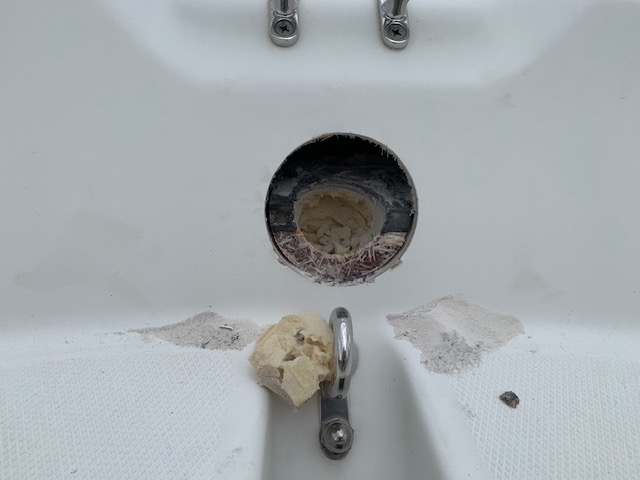

In order to look for a rigging tunnel in a 2010 170 MONTAUK from the console to the bow area, I cut a hole, but no rigging tunnel or wiring path was found. See Figure 1 below.
Fig. 1. A large hole cut into the hull of a 2010 170 MONTAUK to explore for a hidden rigging tunnel between the bow and center console.
IMG_1663 (1).jpg (43.64 KiB) Viewed 21490 times
I have read about laying [two 4-AWG electric cables] on the floor [of the cockpit] but have not seen any pictures [of that method of running the wiring for the trolling motor].

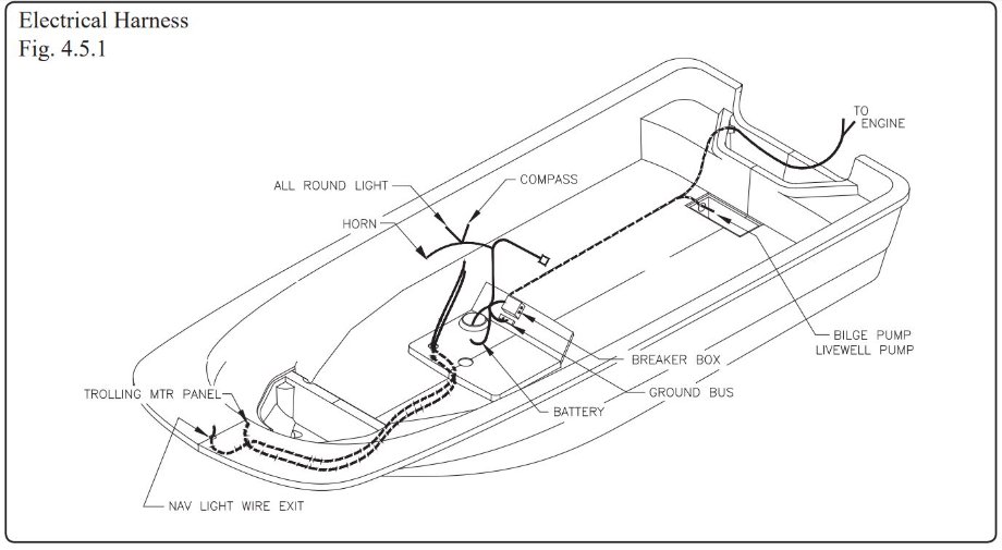

Also, here is the electrical harness diagram taken from the 2010 owner's manual
Fig. 4. Wiring harness path from Boston Whaler resources.
electrical harness diagram.JPG (63.12 KiB) Viewed 21361 times

Power was provided using the original [circuit to the] starting battery.
jimh wrote:Q17: what happened to the original wiring that powered the navigation lamp at the bow after they were used to pull in the electrician's fish wire?
The original wires for the [combined sidelights lamp at the bow] were taped to the electrician fish wire along with the new 8-AWG for the trolling motor and [pulled] back to the bow.
jimh wrote:Q18: what is the anticipated future use of a single 14-AWG conductor now in the rigging path from console to bow?
The rigger placed the 14-AWG wire in case I wanted to install a SONAR [in the bow]. Actually, for me [the 14-AWG wire will be of] no use.
jimh wrote:Q19: was there a wiring path discovered between the original path of the navigation lamp circuit and your newly cut exploratory hole in the bow area?
I can only assume [the wiring path between the original route to the navigation lamp and the new large circular hole] came out in the black box that we viewed when we originally cut the hole. As you can see [in Figure 5 below the 8-AWG] wires exit the plate that covers the hole I cut.
The trolling motor power conductors are “hard” wired through the original hole I cut, and they run to the console.
Fig. 5. Permanent wiring to trolling motor.
