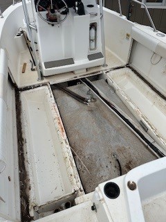

The removable deck covering the fuel tank area has been removed. Taking the boat half-apart was a long and slow day.
Fig. 1. The fuel tank revealed after removal of the deck section that covered it.

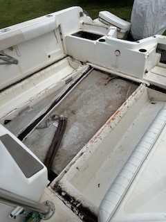

In the illustration below at Figure 2, note where the 90-degree brackets detached from the Florida Marine Tank.
Fig. 2. The 90-degree welded tabs on the fuel tank failed at the bend line, allowing a substantial shift aft in the tank position as seen here. Also note the considerable amount of adhesive remaining on the hull liner that retained the deck section covering the fuel tank.
I will hire a welder to reattach the 90-degree brackets to the Florida Marine Tank.

From Figure 2, the shift in the fuel tank towards the stern looks quite significant. That there was enough slack in the fuel filler hose to remain attached (as seen in Figure 1) when the fuel tank shifted is quite fortunate. What was the total distance of the aft displacement as seen in Figure 2?
Also from Figure 2, the amount of adhesive holding down the deck looks quite substantial.

The shift in the fuel tank position was probably about 8 to 10-inches aft.
The fuel filler hose and grounding wire were extremely taught and were literally holding the tank from shifting towards aft even further.

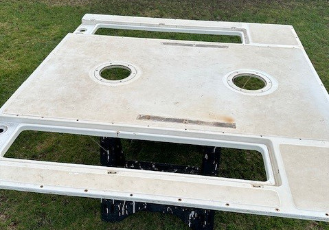

Fig. 4. The removed section of the deck that was covering the fuel tank.
deckSectionCovering Fuel Tank.jpg (60.81 KiB) Viewed 8605 times
[As seen in Figure 4 above] in addition to adhesive the deck was screwed down with four rows of ten screws along outer edge and into interior structural stringers. The length of the screws was 2.5 to 3-inches.
I started with starboard forward corner with multiple pry bars to get that corner started. That was the most difficult. Minimal damage occurred to the surrounding non-skid deck. Once there was room under that area I put on a strap on the starboard side of the deck section, running from the forward side of the removable deck side through the live well, and then I lifted that corner with forklift, all the while while prying and wedging the deck upward. Once more adhesive released, I moved the lifting strap to go through the live well to the circular deck access ports, and kept lifting. Then I moved the lifting strap again, to pass through the aft hatch. Then I repeated to the process on the port sides.

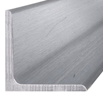

Fig. 5. Extruded aluminum angle stock to be used in making new and stronger brackets for the fuel tank, replacing original bent sheet metal brackets.

I believe that the aluminum L-channel stock is actually extruded, which means the aluminum alloy used is more malleable. The much thicker material should be stronger, and certainly the L-channel should not tend to fracture at the 90-degree bend as there is a nice fillet incorporated in the extrusion.

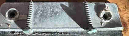

[The fasteners that held the fuel tank retaining brackets to the hull liner were] 1.5-inch-long self-tapping screws [of unspecified diameter or size].
Fig. 5. The screw fasteners and a portion of the broken aluminum bracket that was welded to the fuel tank of the 2001 OUTRAGE 21.

ROGER on the use of a self-tapping screw to fasten to phenolic instead of tapping the phenolic and using a machine screw. Perhaps that represents another change in engineering in the Van Lancker era from the Dougherty era of Boston Whaler boat design.
