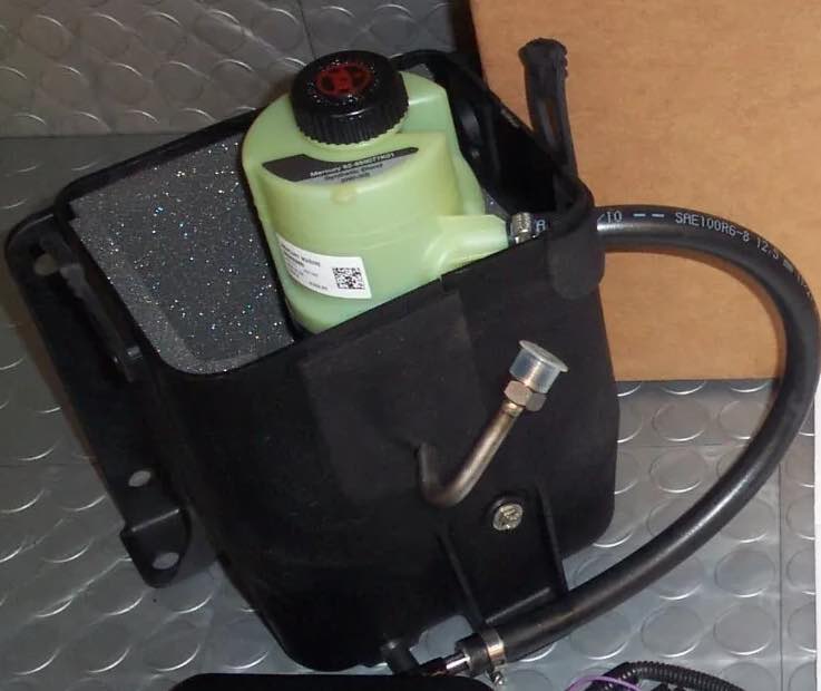

The Mercury power steering pump shown in Figure 1 below looks very similar to the Mercury power steering pump that is on my [c.2005] 220 DAUNTLESS.
Fig. 1. A Mercury power steering pump that has a similar appearance to the pump in the boat in this discussion. The cover has been removed in this view.

I wish the Mercury power steering pump on my boat was as accessible as [the pump seen in the youTube episode linked above].
