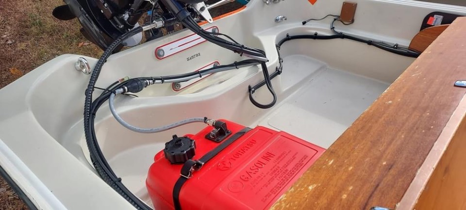

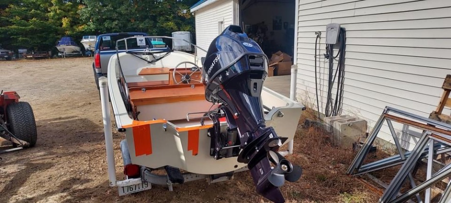

Fig. 1.
Fig. 2.
The measurements were marked up thanks to Chuck Anderson. The swim platform will be installed soon

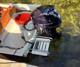

Below is [a photograph] of the installation intended for others owners of a 15-foot hiull that are considering [mounting a swim platform on the transom].
Fig. 3. The newly installed swim platform.
The swim platform was installed on the Port side, and the new fuel tank was installed on the Starboard side. The hull still has a lean to Port, so next summer I may try the moving the battery to [the Starboard side] from its new location inside the storage box. Per Jim’s suggestion, I do have the option of moving the fuel tank to center or Port if we want to.
I am very happy with results, as I think it will make this more fun for the kids for skiing and swimming, and also more fun for me. The swim platform is for safety should if I ever fall out of the boat.

Postby jimh » Sat Oct 19, 2024 10:13 am
Q2: is there any interference between the swim platform and the engine midsection and lower unit when the engine is turned for hard to Port?
As seen in Figure 3, the clearance looks rather tight.

jimh wrote:Q2: is there any interference between the swim platform and the engine midsection and lower unit when the engine is turned for hard to Port?
Yes, it is tight. But there is no interference . We noticed that there was [interference between the engine and the platform] in the dry fit, and adjusted. See the first of the three installation comments above.
Our starting point was the location of the same swim ladder that Chuck Anderson had installed on his 1988 Super Sport. I don’t know if he has interference, but he so carefully crafted that boat, I doubt it. We had to adjust just a bit outboard from there so as not to interfere. We were just at the limit where the outboard bolts by Martin Marine would have been too short had we gone further outboard with the mounting position of the swim platform
[What accounts the difference [in clearance of the engine and swim platform between my boat and the boat owned by Chuck Anderson]? My suspicions are as follows.
  • my engine is a Tohatsu 60 and his engine was a Yamaha 70, so the shape of the transition between upper engine and lower unit may be different. On the Tohatsu, it is very curved in that section. The only interference [the might occur on my boat] would have been when the engine was fully trimmed down.
  • Chuck is using a set-back jack plate which pushes the engine farther aft and that would allow more clearance [when the engine] fully turned to port; and
  • effectively the engine [on Chuck's boat] is mounted quite high as the jack plate is mounted three-holes up on the transom and the engine is four-holes-up on the jack plate, as Chuck wanted to be able to run very shallow. Currently, the Tohatsu engine is mounted three-holes-up, and it could go up one more hole;
  • I have no idea where the steering stops are on other boats compared to where the steering stops are on the new steering system I just put in.
I also suspect the angle of my photo contributes to it looking tight
So, the swim platform fits fine post-adjustment, but every engine and setup may be different. I included this as my first caution as I wanted anyone else to ensure they check, as I did, to ensure no interference

Postby jimh » Sun Oct 20, 2024 9:08 am
davidB01 wrote:I also suspect the angle of my photo contributes to it looking tight
Yes, I agree. In retrospect, the small size of the photograph and the unusual high-overhead view made it look like there was going to be interference.
Thanks for the further clarification. I did not read your initial remarks with sufficient care to catch you comment about interference on the first reading.

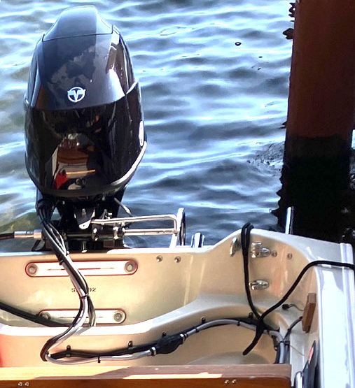

The bent tubes that make the support frame for the swim platform are interesting because the upper attachment point of the tubes to the transom will be in tension and the lower attachment point will be in compression. This raises the question:
Q3: are the upper support tubes through-bolted at their attachment to the transom?

Postby davidB01 » Sun Oct 20, 2024 9:50 pm
[The swim platform mounting tubes] are through-bolted with all the hardware (which includes some very odd “bent” bolts that match the curve of the transom for the outer Port locations) supplied with the platform from Martin Marine; everything fit perfectly.
Fig. 4. Details of swim platform and engine mounting bolts on inboard face of the transom.
Note the upper and lower engine mounting bolt backing plates. These are “harpoon” plates also from Ray Martin. The are machined aluminum, but I chose to highlight the harpoons and outer edges with as close to Boston Whaler red as I could get, covered by clear coat.
Also, this photograph is taken from a better angle to show the clearance to the engine. As noted, it is tight, but just makes it with this particular engine configuration and positioning. In this angle, it looks like the steering arm is also interfering. It is not. Several inches of clearance

Postby jimh » Mon Oct 21, 2024 10:13 am
Figure 4 shows very nice engineering and details.
