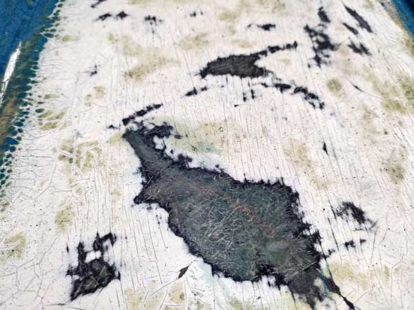

One area of the hull is "squishy" and likely has delamination. I don't want to tear-up the fiberglass, but I believe my only recourse here is to [cut] out the whole section of fiberglass, dig out all the soaked foam, and then refill with proper two-part polyurethane and re-fiberglass.
This 18-second-long youTube presentation I created shows this area:
https://youtu.be/myQOLaAjdWA
Fig. 1. Keel damage.

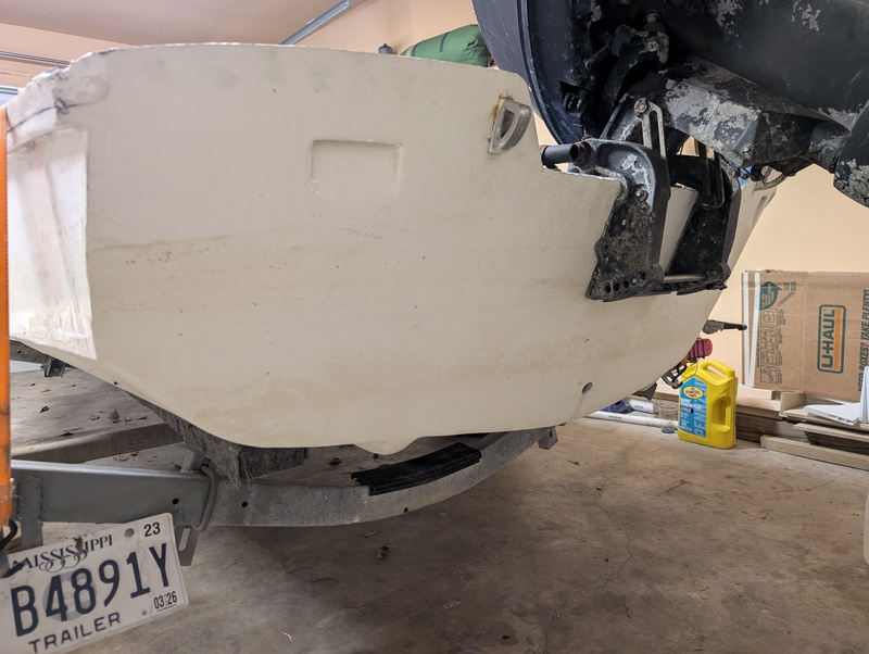

Fig. 2. Hull bottom patch.

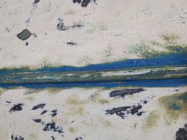

The hull has been patched many times and the hull thickness varies.

Postby waterlubber » Sun Feb 15, 2026 6:08 pm
I finished my hull repair work in the Summer of 2025. I have heavily used and trailered the boat since. Below is an update on the repairs I performed and how they stood up. For now, I have only worked below the waterline . I will handle the hull side sides and interior of the boat at a later date.

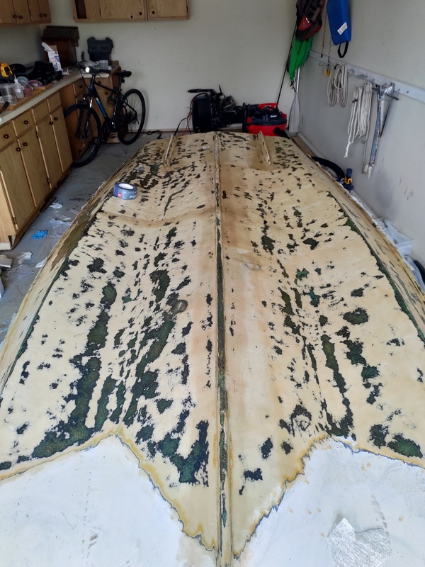

Overview of repairs:
General work flow steps:
  1. removed all bottom paint mechanically using disc sanding with 60 grit;
  2. sanded gel coat significantly to rough surface; in some cases, removed gel coat completely and exposed bare fiberglass;
  3. sanded out any portions of the fiberglass bottom that were squishy or otherwise clearly delaminated from the underlying foam. These are largely areas of the hull that had been previously repaired with Bondo;and then
  4. sanded and then scooped out the chines on the sides of the hull--the squarish joints at the bottom of the freeboard.

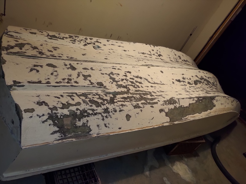

Fig. 3. The hull bottom after existing paint layers were ground off. The bondo-filled areas are visible.
Fig. 4. The hull bottom now ready for the first layer of new fiberglass.
Fig.5. The hull transom after one-year of using the boat since the repairs were completed.
For rebuilding the hull, I used US Composites 700 Vinyl Ester Resin, white gelcoat, and surfacing wax. The fiberglass material was chopped strand mat and 3M microspheres.
In general, I would highly recommend going with an unwaxed resin. The ability to lay up a layer at at time, and return the next day, worked extremely well for me as I could complete a layer each day as I got home from work, then let it cure overnight.
I started on the hull sides and the chines, where I built something similar to a concrete form using tongue depressors. The I filled the deepest cavities with a microsphere-based [thickened resin]. These chines had essentially the bare foam exposed, and I used a mix of microspheres and chopped mat to fill and reconstruct the area. I wouldn't recommend this for large repairs, but the scope here was small enough that the actual filled area--and thus thickness of the resin--was limited to less than 1/4-inch.
Due to the high temperatures in Mississippi when I performed the layup I had to significantly reduce [the amount of] catalyst [added to the resin] to get enough working time. I would mix six to eight ounches resin at a time, which was generally the most I could lay out without it setting and becoming unworkable. I had a lot of problmes around the chines at the stern: the mat would not conform unless wetted, and the time it would take to wet, form, and lay up was very tricky to manage. Later a coworker offered advice that he used for carbon fiber layups: use a heat gun to soften the chopped mat "stiffening wax" to pre-form before wetting out.
In some areas of the boat, and particularly the transom, near engine mounts), I used multiple layers of chopped strand mat; usually adding two layers at the beginning and end of an evening lay-up in these locations. This was to replace the significant scoops I had put in the area sanding-out damaged fiberglass, and strengthen this load-bearing area of the structure.
After laying out a full layer of chopped mat I followed it up with a gel-coat; I believe I ended up with two waxed and cured layers and a significant amount of sanding and fairing to produce a smooth surface. This was almost a year ago and I forgot the exact procedure.
Finally after curing the gel-coat I painted the bottom with TotalBoat's epoxy barrier coat primer. I did not add another layer of bottom paint on top of this, as the boat would not be stored in the water.
Ultimately this whole adventure took me a few months; most of this was sanding, sanding, sanding. The work was easily broken into small pieces, however, so it probably took about three weekends and a dozen evenings after work--perhaps not all that much all-in-all. I think the outcome was definitely worth the effort.
