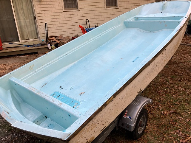

Fig. 2. The c.1960 boat on its much newer trailer, showing the topsides in decent condition.

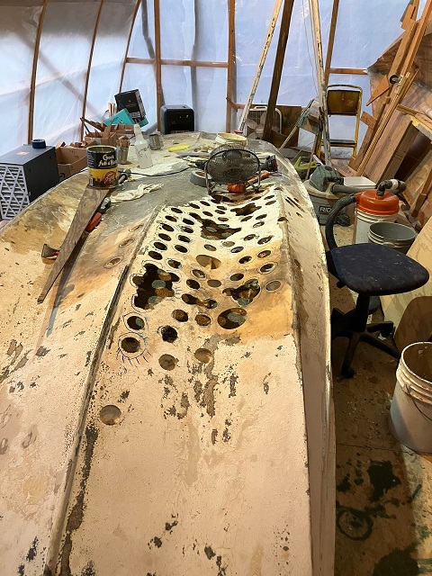

THE NEW PLAN
    -I started with the holesaw (which was in one of the tool boxes that came with the boat), and I found that not all the foam was wet, I'll get out the wet foam and pour in new foam in. Then replace the hole saw divots (I kept then).
    - Next I will apply two layers of 1708 --17-ounce cloth backed with mat, pretty standard boat building glass--over all the repaired sections.

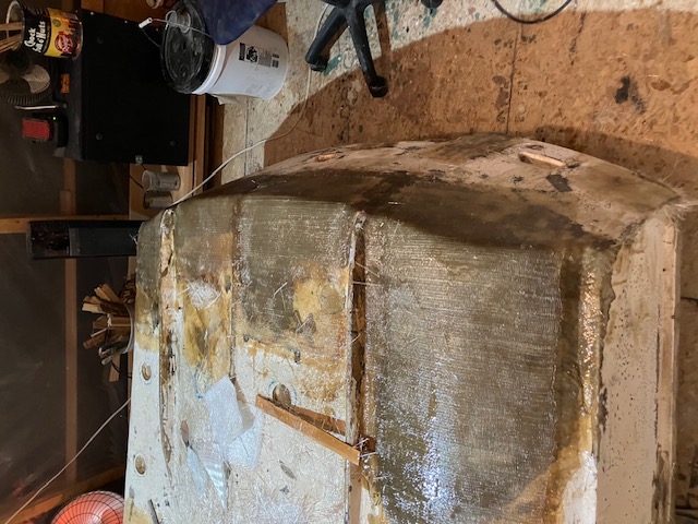

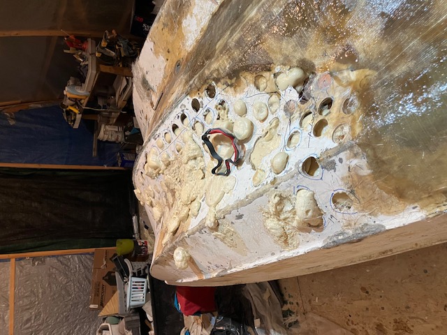

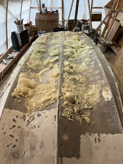

Fig. 4. Foam-filled holes,
Fig. 5. Vinylester and 1708 biaxial closthfor a handsome transom.
Fig. 6. The weekend's progress.
First round of foam [infusions appeared to have] worked.
I an going to try taping-in-place the my [large circular hole] divots, and let the foam expand up to them. There seems to be a 10-minute period where the foam is hardening, but the foam remainsl pliable enough to move stuff around. If you don't get to the foam at the exact right moment, there's no going back.
Also, more glass work was done.

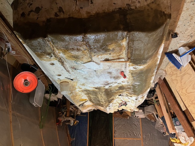

Fig. 7. End stage of infusion of new foam into the interior of the hull bottom.
IMG_0537 (1).jpeg (69.9 KiB) Viewed 1895 times

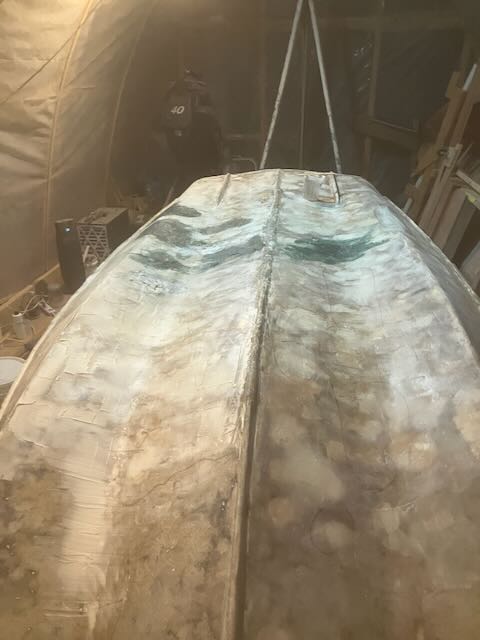

Fig. 8. The hull bottom after sanding. It is ready for new fiberglass.

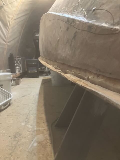

Fig. 9. Rebuilt gunwale.
