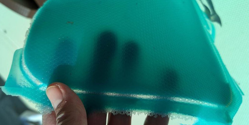

Fig. 1. The mold (green) made by a silicon casting from a non-damaged section of the deck non-skid pattern.

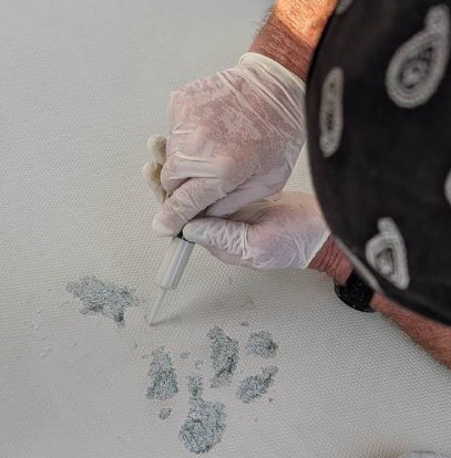

Fig. 2. Overhead view showing resin being added to repair area.

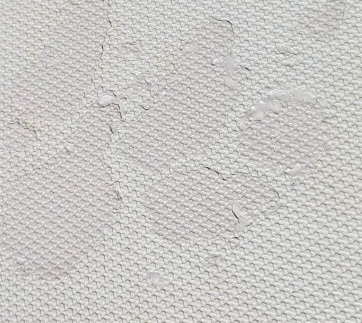

Fig. 3. Extreme close-up view of deck showing non-skid pattern [and what appears to be repaired areas].

Q1: in Figure 3, are we seeing the outcome of your repairs?

Q4: what are we seeing in Figure 2? You mentioned "popsicle stick" but there appears to be a syringe in use.
Q5: is there a better photograph of the green mold? Seeing the pattern in the mold is difficult in your illustration. The mold seems to be lit from the back.
