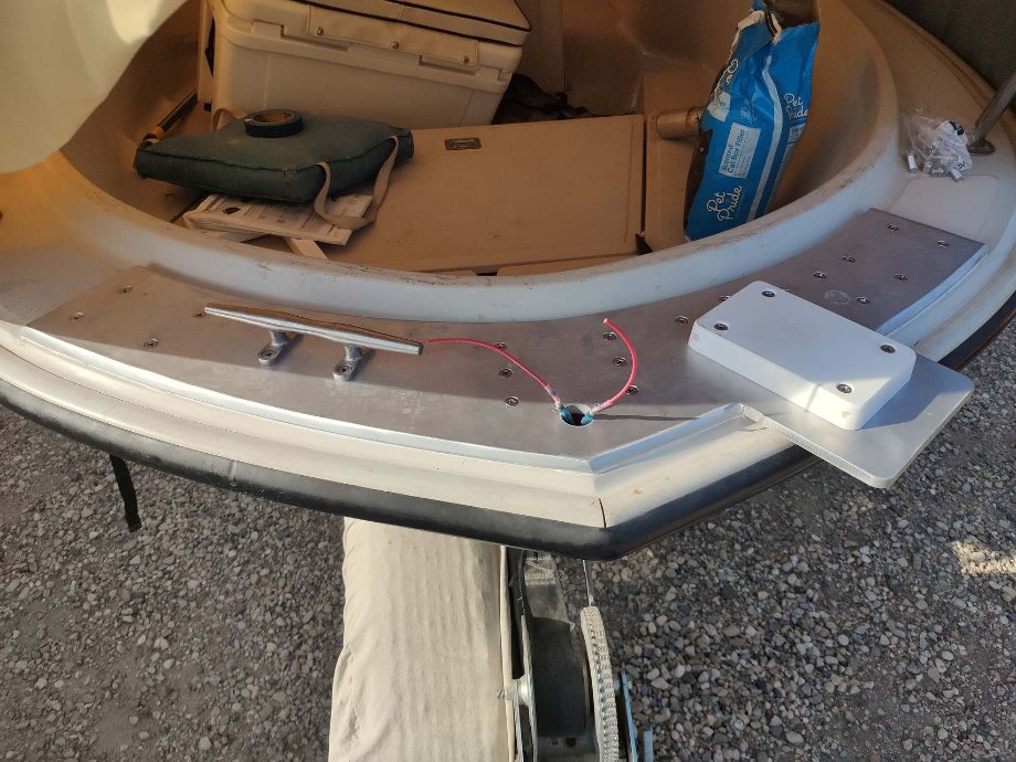

Designing Mounting Plate for Trolling Motor

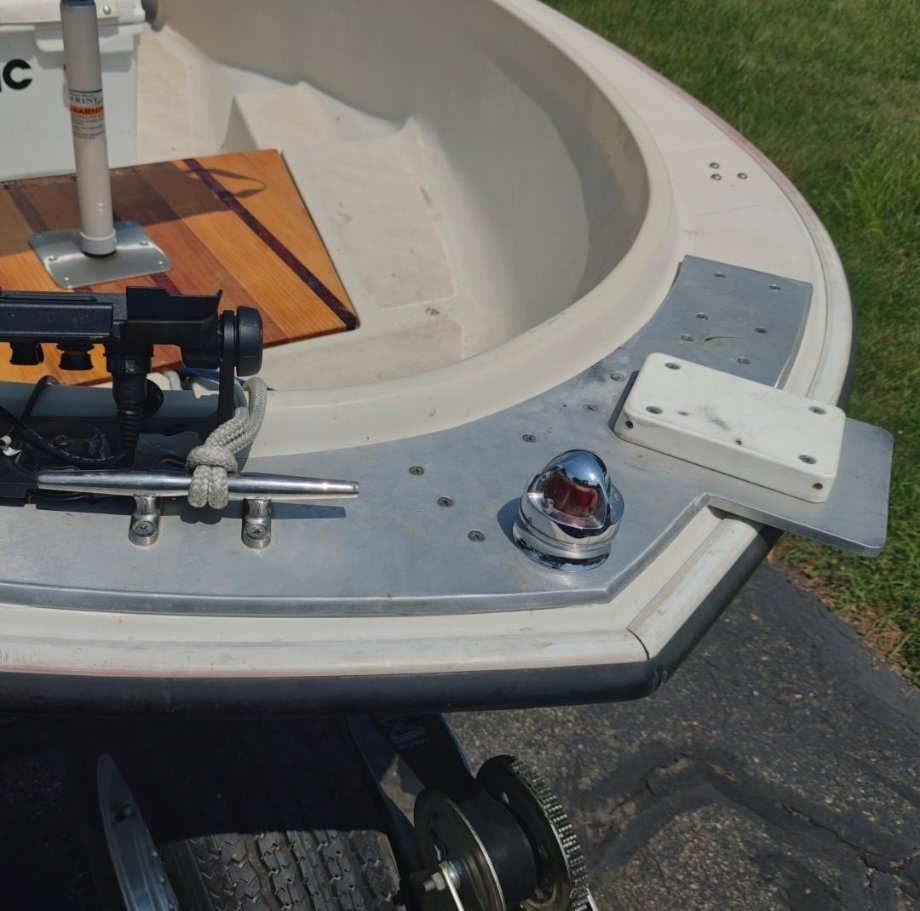

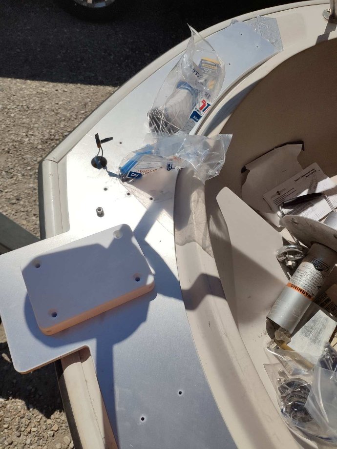

After deciding on orientation, I grabbed the wood locating diagram that came with my boat from the previous owner; the wood diagram actually turned out to be wrong. I started planning out hull attachment.
My idea was to have a piece of aluminum fabricated that would provide plenty of strength when attached to the hull in many different spots, and then attach the trolling motor to the aluminum with a quick disconnect plate. To make a template I used a piece of cardboard, then took I took the template to a local fabricator to have it cut out of 3/8-inch thick sheet aluminum.
I had seen other mounting guides where they cut into the ridge of the bow gunwale area; I didn't want to do that, so I made sure the height of the aluminum plate would allow the trolling motor to ride just over the ridge of the boat's gunwale.
For improved appearance and to reduce the chance of a sharp edge of the plate cuttingI fishing lines or my boat cover, I had the aluminum plate edges beveled.
The MinnKota quick disconnect plate is attached to the aluminum with two through-bolts in the front, and in the rear the aluminum plate has tapped holed for two bolts
Fig. 3. Test fit for large aluminum plate mounting bed for trolling motor.
Test Fit.jpg (110.62 KiB) Viewed 3999 times
Attaching Mounting Plate to Hull
To attach the plate to the hull I planned on using stainless steel screws into any locations with wood, such as under the cleats, as well as making thickened epoxy cores under the laminate. (See "Repair of Loose Screw Fasteners, as described previously in the forum}. Basically, I drilled a small hole, then used an Allen wrench to core out the foam beneath the fiberglass, then injected epoxy into the vacant space created under the laminate, and when the resin was fully cured, installed screws into the epoxy.
I used SIX-10 epoxy for this portion. Additionally, I used 3M 5200 on the entire underside of the plate. After the test fit I countersunk the holes for my hardware, then completed the mount.

Trolling Motor Project Continued
After the mounting plate was in position, I reattached the starboard cleat into its original holes. The port cleat is sadly gone for good with this setup, as the motor requires about six-inches of room to the port side of the mount for the quick connect locking mechanism. If I ever dock the boat on the port side I just run the docking line around or over the trolling motor to the starboard cleat.
Fig. 4. The aluminum plate is attached to the hull with stainless steel screw fasteners and bedded with 3M5200 adhesive sealant.

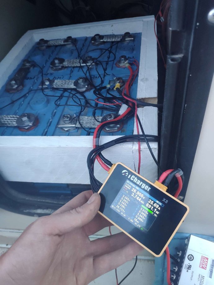

After finishing mounting the motor I had to figure out how to get battery power to it. I should have put much more thought into this aspect of the project from the beginning. The OUTRAGE 17 does not have any conduit or tubing to the bow of the boat, other than a circuit for the navigation lamp which runs inside of the rub rail (and there is definitely no space in there for two 8-AWG conductors).
Custom Battery Pack

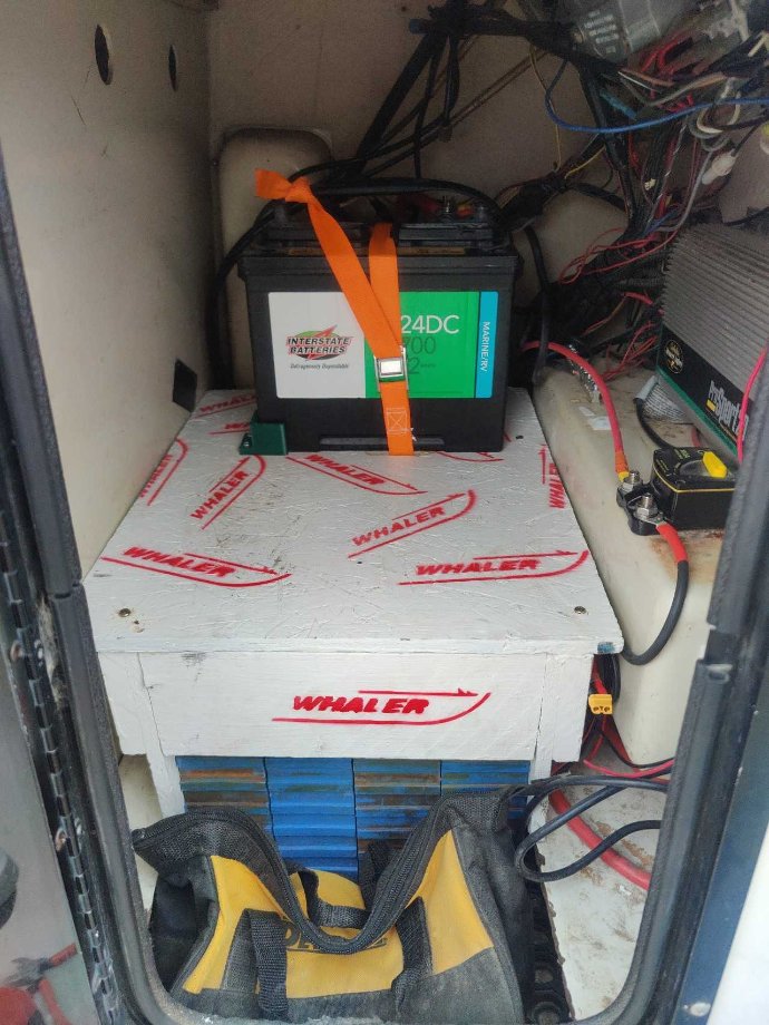

I had installed a custom LiFePo4 battery bank under the console using eight 3.3-Volt electric car batteries from China. These batteries were pulled out of a DIY electric car, and each was tested at between 140- to 150-Ampere-hour storage capacity.
Fig. 5. The battery is composed of eight 3.3-Volt LiFePO4 cells used in electric cars. In this view the dedicated battery charger is attached and charging, with its display screen indicating individual cell data.
Battery open.jpg (101.63 KiB) Viewed 3998 times
The eight battery cells are housed in a plywood box under the console. The boat's 12-Volt starting battery is then mounted on top of the box.
Fig. 6. A view inside the center console looking through the open port side door shows the trolling motor battery bank covered in its plywood box, and 12-Volt engine cranking battery mounted on top.
MinnKota had assured me that the motor could handle the 26.4-Volts coming out of the battery bank, but advised me to limit full-throttle operation to a minute or two at a time to ensure no overheating of the motor control board.

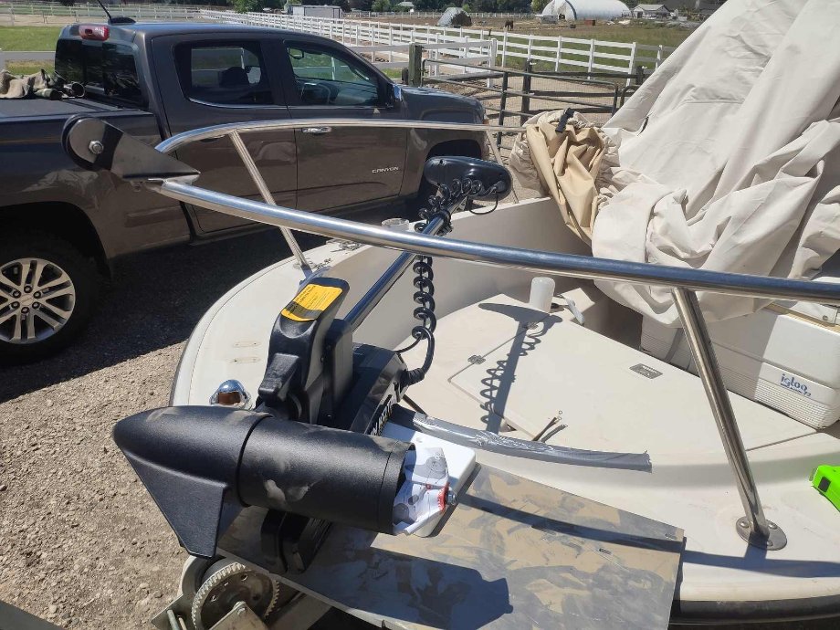

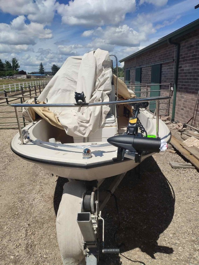

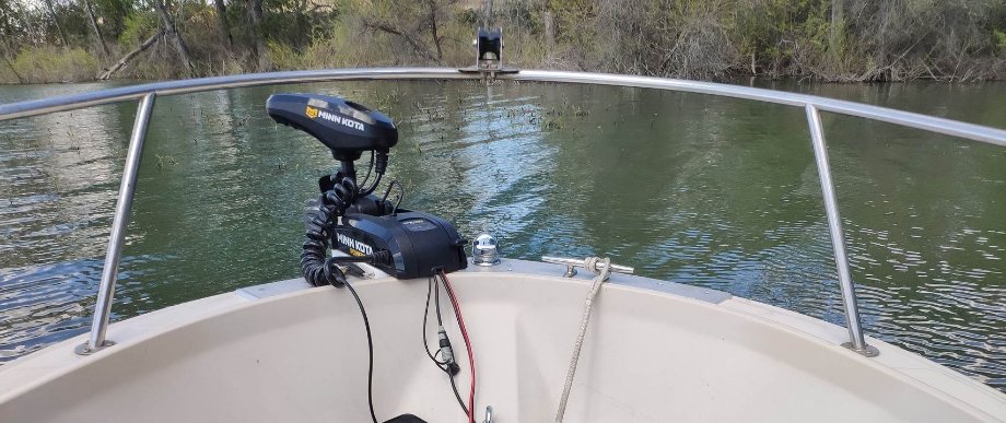

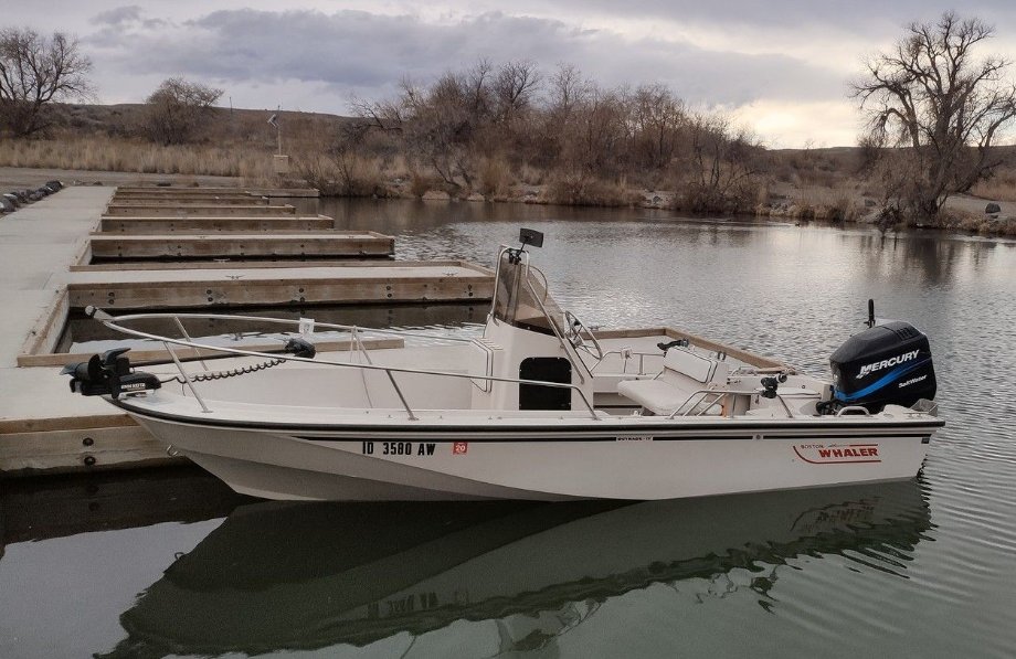

Trolling Motor Summary
Overall this project has made fishing out of the boat significantly easier and more enjoyable. Having a bow mount motor with spot lock, track following, heading locks, and speed controls is a huge upgrade from a tiller steer transom motor. Plus having a remote lets me operate it from anywhere on the boat.
The LiFePO4 battery bank has enough stored energy for me to go on four-day camping and fishing trips without needing to bring a generator to recharge the battery bank.
The aluminum mounting plate is rock solid, with the only downside noted is that it's possible to hang up the extension portion on a dock if approaching in wavy conditions.
Fig.8. Trolling motor stowed beneath bow railing.
Fig. 9 Trolling motor deployed in the lowest and deepest position. It can also ride above the bow rail for very shallow water.

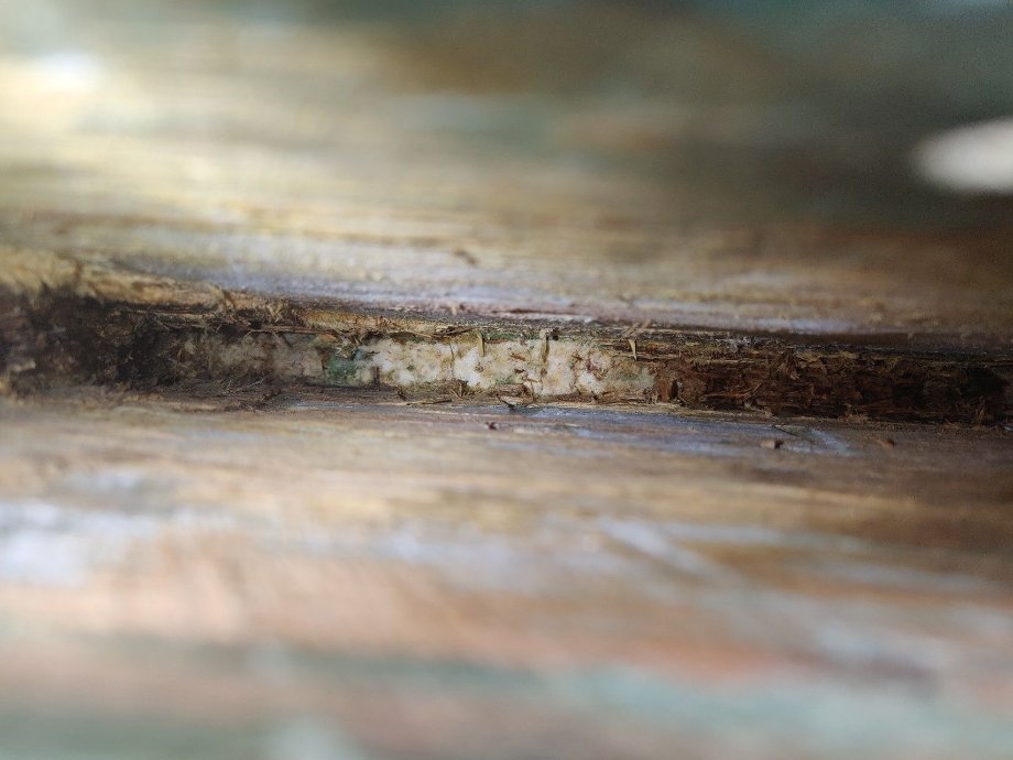

In late 2022 I noted that the bolts holding on the outboard engine on were starting to compress the gelcoat and fiberglass of the transom, which to me was an indication of wood rot around the bolts. I removed the two brass drains from the engine splash well, and I found the embedded reinforcement wood around those hole was wet and significantly rotted. At that moment. the season was too far gone to start to replace the transom, so I put the boat into winter storage and started planning a Spring 2023 transom replacement.
Planning the Transom Repair
After lots of digging through other boaters transom replacement projects I ended up deciding on [replacing the wood reinforcement in the transom with a] pourable material. In the archive of this website, many people have used a product called Seacast for this type of repair, but there are many other brands offering similar products. They all seemed pretty comparable: lighter than plywood, rot free, bond well to fiberglass. I went with a brand called Nidabond. I also ordered a lot of resin and cloth. This was my first time doing any serious work with fiberglass, so it was definitely a learning process.

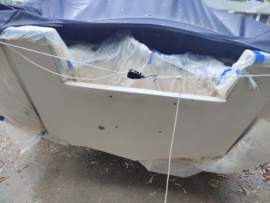

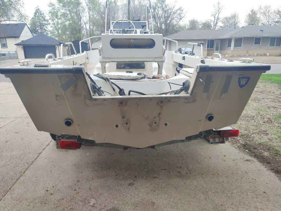

Fig. 10. The transom without the engine in place, ready for repair of the soft wood inside the transom.
Engine Off.jpg (151.82 KiB) Viewed 3976 times

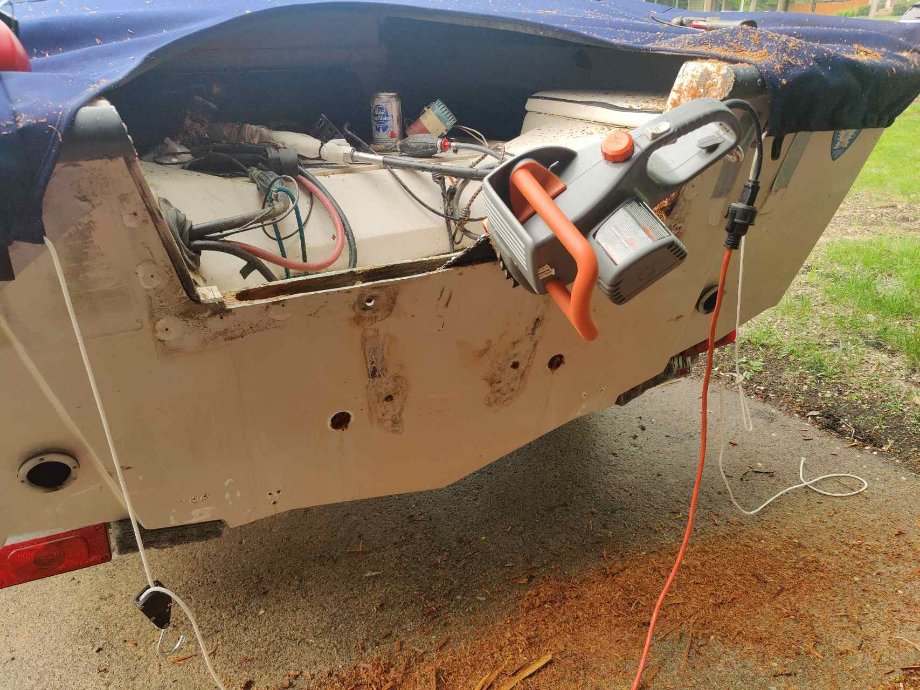

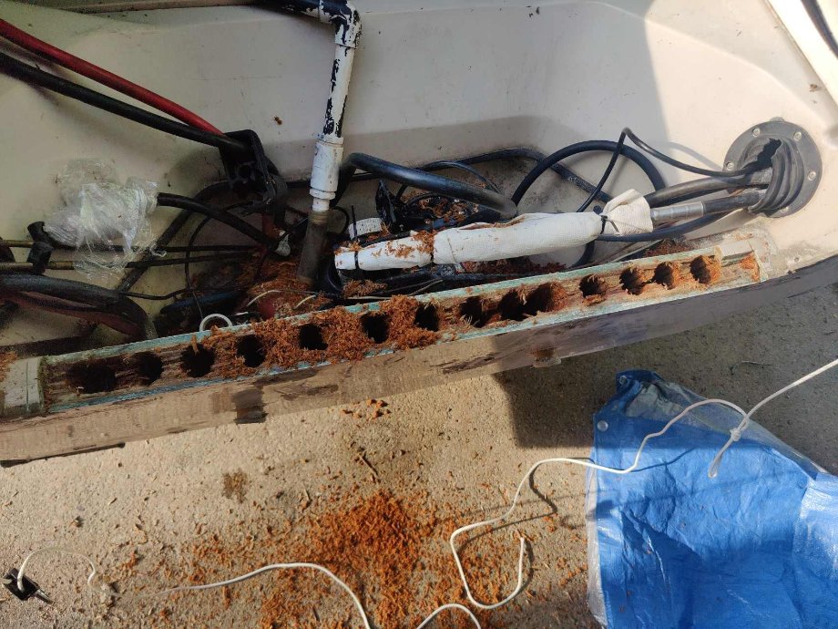

Coring Out the Soft Wood from the Transom Reinforcement
Then I cut off the top cap of the transom to see what I was working with. I chose to go in from the top and hollow it out, instead of cutting off entire the skin off the aft face of the transom. I was intimidated by the amount of fiberglass work that removing the whole aft face of the transom would entail, but in retrospect it would have been muuuuuuch easier that way. If I were ever do a transom again I will use that method.
After cutting off the transom cap the wood core looked surprisingly good, but it makes sense that the highest up wood would be fine as the water intrusion was coming through the engine bolts and thru hulls. I used a long spade bit with an extension to drill down and hollow out the wood between the skins.
Fig. 11. Drilling out wood core with an extended spade bit.
Once a majority of the wood was removed I used an electric chainsaw and a long chisel to remove the rest of the wood. This removal process was a pain in the butt, removing the full skin would be much smarter.
Fig. 12. Continued hollowing out the core with chainsaw and chisel.

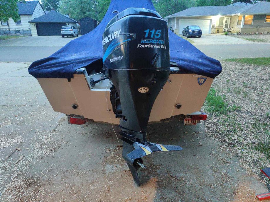

Fig 12, Transom after new gelcoat resin sprayed on.
I had a scheduled fishing trip coming up quick, so once the gelcoat was fully cured and ready, on went the outboard engine, and I was off to the lake.
Fig. 13. The engine is mounted. Ready to fish.
Motor On.jpg (195.08 KiB) Viewed 3976 times

Q1: does your DIY battery pack have a BMS or a fuse for safety?
Cala
Posts: 18
Joined: Wed Jul 02, 2025 8:35 am
Re: 1994 Outrage 17 Modifications
Postby Cala » Thu Jul 09, 2026 8:23 pm
MarkCz wrote:Q1: does your DIY battery pack haves a BMS or a fuse for safety?
The iCharger x8 (seen in Figure 5) is hooked up during battery charging, and it balances the packs and monitors voltage of each cell, current, and temperature during charging.
During normal operation there is no BMS connected, but the positive lead goes through a 50-Ampere circuit breaker in the console. The 24-Volt battery circuit breaker is kept switched off except during actual use.
The circuit breaker feeds battery positive to the trolling motor positive, and also to a Victron DC-to-DC inverter, which steps down the voltage from 26.4-Volts to about 15-Volts to power electronics, like the fishfinders, NMEA-2000 network, and a USB charger.

Q2a, b: what was the approximate cost of the eight 3.3-Volt 150-Ampere-hour cells, and (b) were they used cells when you bought them?
I am impressed with the height of those cells as they appear in Figure 6 above.
Q3a, b: (a) how tall are the cells, and (b) how much does each cell weigh?
Postby jimh » Fri Jul 10, 2026 3:57 pm
Cala wrote:...a Victron DC-to-DC inverter...steps down the...26.4-Volts to about 15-Volts to power electronics, like the fishfinders, NMEA-2000 network, and a USB charger.
Q4: was the choice of 15-Volts instead of something closer to 12-Volts intentional?
Q5: is the 26-Volt battery pack essentially also the HOUSE load battery for the boat?
I presume the propulsion engine does not recharge the 26-Volt battery pack, but if the 26-Volt pack has 150-Ampere-hour stored capacity, I guess you can operate a lot of small electronic loads from it for many hours without much worry about discharging the battery.
Also, your approach to the battery and trolling motor power is quite unique and very interesting.

jimh wrote:...were they used cells when you bought them?
I pulled out those batteries from a DIY electric car a relative of mine wasn't using anymore, I believe they had been used for several years. After pulling them I tested them and found them to hold about 140-Ampere-hour capacity. I'm unsure what the original rating was when they were purchased.
jimh wrote:Q2a...what was the approximate cost of the eight 3.3-Volt 150-Ampere-hour cells...?
As for cost for new cells, searching on Docan Power's (the website I believe where they were originally ordered from) it looks like a 105-Ah cell is going for $38, while a 340-Ah cell is going for $64. This would put an eight cell 24-Volt bank at around $300 for 100-Ah, or around $500 for a 340-Ah bank, which is truly massive. I would plan on spending another $50 for connecting hardware and $100 to $150 for a charger/BMS. So an estimated total including hardware and charger. would be:
  • $450 - 100aH
  • $700 - 340aH
This approach seems awfully appealing compared to Bass Pro Shops Tracker Lithium battery, which retails for $750 for a single 12-Volt 100-Ah battery without a charger. LiTime, a popular lithium battery brand, retails for $310 for a 12-Volt 100-Ah battery, so still over $620 for a 24-Volt. If you DIY you could have over three-times the battery capacity for a comparable cost. Obviously these batteries already have a case, and have some additional features like bluetooth monitoring, but it's still quite the upcharge.
jimh wrote:Q3a, b: (a) how tall are the cells, and (b) how much does each cell weigh?
My cells are about 8-inches tall. Hardware and wiring takes a little extra room on top of that, plus leaving some room to not short out anything if your lid was conductive. So I'd say about 10-inches from base of batteries to top of the plywood lid. Weight is a bit under 5-lbs per cell, so around 40-lbs. For the 340-Ah batteries mentioned above weight would be just under 100-lbs.
jimh wrote:Q4: was the choice of 15-Volts instead of something closer to 12-Volts intentional?
Some anglers report better performance of fishfinders when using 15-Volt inpuit voltage. Others dispute and believe 12-Volts is perfectly fine. Either way the vendor approved input voltage for my Garmin devices, NMEA2000, SMG4 engine gauge, and USB charger are up to 19-Volts, so I saw some potential gain and no downside to setting it at 15-Volts.
jimh wrote:Q5: is the 26-Volt battery pack essentially also the HOUSE load battery for the boat?
Correct. It's technically possible to setup the battery bank to recharge from the engine alternator, but I think it would require at least a few hundred bucks of supplies, and is beyond my electric skill level to do comfortably. I never run out of house juice with my current boating style, so no need to spend extra money or risk any potential failures.

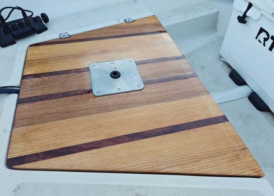

New Anchor Locker Hatch Construction

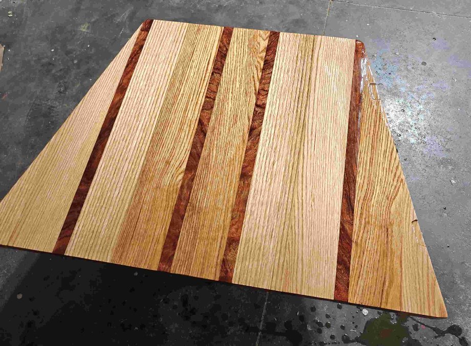

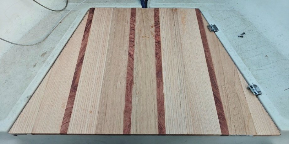

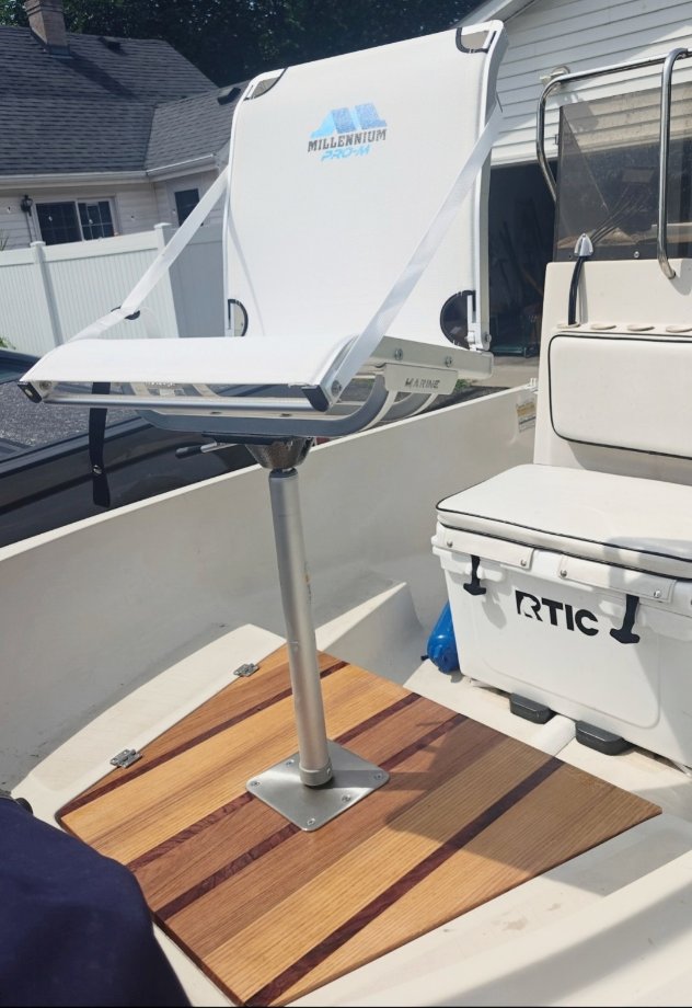

For years I wanted to add a forward fishing seat mounted to the anchor locker hatch on the 1994 OUTRAGE 17 , but couldn't find it in me to cut a hole in the original hatch. Finally I decided to just make a new anchor hatch, and then if I didn't like it I could always go back to the original. I decided that making a mold and creating the hatch out of fiberglass and gelcoat would be too annoying, so I settled on a wooded hatch. After taking some measurements I used 3/4-inch wood.
Choosing the Wood
I happened to have a bunch of appropriately-sized red oak sitting around, which to be honest is a terrible choice for a marine environment due to its porous nature and tendency to rot. But since I already planned to completely coat the hatch with epoxy and varnish that didn't matter, so I stuck with the red oak. I wanted to add a few strips of Bubinga wood as an accent. I cut those and used my planer to make sure all the wood was equal thickness, which saves a lot of sanding time after the glue up. I laminated all the pieces together with Titebond-3 wood glue, then sanded down any uneven edges.
Fig. 14 Test fit of new anchor locker hatch after initial cut, marking points for hinge attachment.
Test Fit.jpg (82.19 KiB) Viewed 3832 times
I removed the original hatch and used it as a template to cut the shape. Then I test fit the new on the boat to check corner fit and thickness as well as to mark holes on my new wood hatch for the hinge attachment points. I had to use a router on the hinge attachment points to get them to lay correctly. I also rounded off corners with an orbital sander. Once was happy with the test fit, I added some crossbars on the backside with the same red oak, perpendicular to the grain of the top. I started with two crossbars going almost the full width of the hatch (stopping short enough to allow the hatch to fit down when closed, then I also added a few shorter backing sections around where the seat base plate would go. I attached these sections with Titebond-3 glue and 1-1/4-inch screws. The hatch should be plenty strong now.
Wood Surface Protection and Finish
Epoxy
To add durability and completely waterproof the rot-prone red oak I fully coated the top, bottom, an dedges with WEST Systems 105 resin with 207 clear hardener. I applied three coats in total, with the first coat using much more epoxy as it soaked into the grain. Subsequent coats were applied while the previous layer was tacky but not cured, so no sanding was needed in between. The epoxy was then given eight days to cure fully as based on local temperature and humidity. After full cure, the cured epoxy was washed with warm soapy water to remove amine blush, and then fully dried.
Fig. 15. The new hatch with a coating of epoxy. It's getting shiny.
Varnish
I used seven coats of Epifanes Clear Varnish to finish the top and edges of the hatch. I scuff sanded the epoxy with 120 grit before the first varnish layer, then scuff sanded with 220 grit between varnish layers. I waited 24 hours between each varnish layer, so this process took a while. On the final (seventh) layer I masked the edges and around where the seat base would go with painters tape, and added Epifanes Polypropylene Non-Skid Beads to the varnish. This gave the top a good grippy surface that I won't slip on once it gets wet or fish slimed. I removed the painters tape about 30 minutes after application, which left a nice clean line. The varnish is mostly just to protect the epoxy from degrading in the sun, so I only applied one layer to the bottom of the hatch.

New Anchor Locker Hatch Construction Continues
Fishing Seat Mount
Once the varnish had fully cured on the hatch I moved on to hardware installation. I went with a Springfield 7-inch x 7-inch stainless steel base with a 3/4-inch threaded insert. I chose this size as the hole size is quite small when the post is not installed, so dog paws can't fall in when they roam the boat. I like the threaded end for peace of mind that it won't fall out on the highway or in rough water conditions. I used a hole saw to cut in the middle of the hatch (I believe it was a 2-3/4-inch hole). In retrospect I wish I had placed the seat 3 or 4-inch more towards the rear of the boat instead of dead center, as this would have given a bit more room between the stowed trolling motor and the seat. The base was fastened on with 1/4-inch stainless steel hardware, and caulked on both sides to prevent water intrusion into the screw holes.
Fig. 16. The metal seat base is installed. You can just make out the edge of the non-skid area.
Final Without Seat.jpg (108.74 KiB) Viewed 3832 times
I had a BassProShop power pedestal laying around that I installed, as well as buying a Millenium mesh seat based to overwhelmingly positive feedback online. I had started this project assuming I would buy a traditional foam padded high backed seat, but after reading so many poor reviews about their stitching quality, comfort, and tendency to get waterlogged I pivoted to the Millenium seat, and I've been very happy with it so far. The pedestal I had ended up being a bit too tall (it was the 22- to 29-inch adjustable version) as it is designed for the leaning seats, so I replaced it with the shorter version 16- to 22-inch adjustable pedestal
Fig. 7. This views shows the original, taller 22- to 29-inch adjustable pedestal, which was later replaced with a shorter version.
With Seat.jpg (95.83 KiB) Viewed 3832 times
So far I've been very pleased with the result. The hatch is rock solid, the non-skid coating has been the perfect amount of grit to keep traction, and the seat makes long fishing days a pleasure. I would highly recommend the Millenium seat so far. Its welded construction seems high quality, and the seat is very comfortable. It also provides plenty of airflow to keep your back and butt cool on hot summer days.

Navigation Light LED Conversion -
The navigation light on my boat had been a constant source of annoyance (as well as a safety hazard), as it seemed to always work in the driveway and never work on the lake. The old lamp burned HOT, and the mounting system did not seem secure. Eventually I got so sick of it I decided to convert to LED. I ordered this Perko bow light LED conversion kit from Specialty Marine, which the website claims to be compatible with Outrage 17's made 1990-1994.
https://www.specialtymarine.com/product ... tion-parts

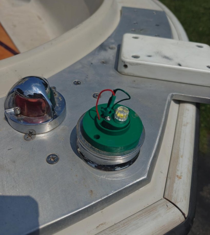

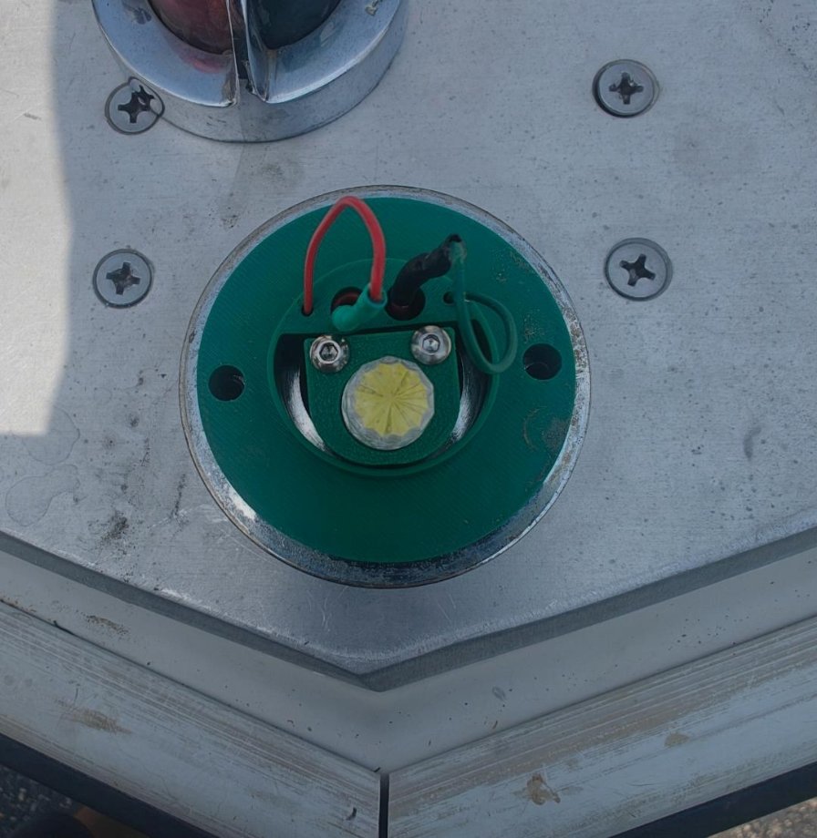

Unfortunately when the kit arrived I found that the green/red housing as well as LED mount did not match or fit my existing light. I am unsure if the website listing is incorrect, or if my navigation light is not the original and the previous owner had replaced it. However, I really only needed the LED itself, so I whipped up a 2 piece mount/LED holder in CAD and 3D printed it with a PETG filament to withstand the heat. The mount uses the navigation light's existing 2 bolts to connect it to the light frame and boat. Two 3mm screws hold the LED to the mount, which has 4 wire holes built in - 2 for the LED leads and 2 for the navigation light power/ground coming from the console. This allows the wires to be connected above the base and behind the LED. Easier to work on, doesn't block the light, and keeps it above any water intrusion that may occur.
Side view of mount with the housing off.
Open Side.jpg (84.69 KiB) Viewed 3758 times
Top view of mount with the housing off.
Bow Top.jpg (119.45 KiB) Viewed 3758 times
The wires were soldered together, then sealed with heat shrink. I re-used the existing green/red lenses and housing. The light now works consistently, is brighter than before, creates less heat and uses less power.
Finished navigation light, mounted on aluminum bracket for trolling motor.
Bow Light.jpg (112.65 KiB) Viewed 3758 times
