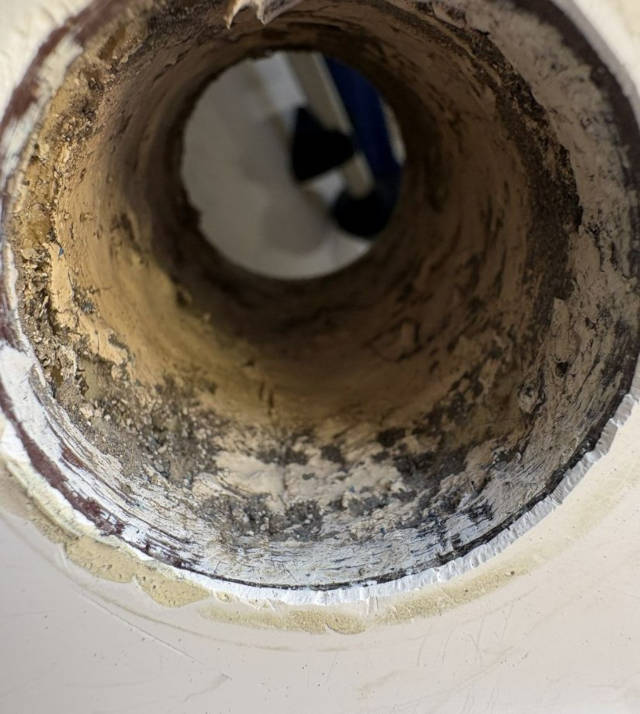

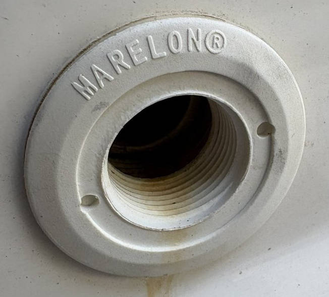

Q1: should I be concerned that a MARELON through hull drain located in the anchor locker of my recently purchased 2013 150 MONTAUK was loose, and that upon removing it I found the surrounding foam to be wet?
Fig. 1. MARELON fitting on hull exterior
Fig. 2. View looking into empty drain hole after fitting removal.

I checked the plastic through-hull drain in the anchor locker. I found it to be very loose and was not sealed at all. I removed it very easily and found that the foam was wet to the touch. I hope there is not much water in the hull. I have had the boat in the water maybe about five hours total but don't know how much it was used before me while the thru hull was leaking.

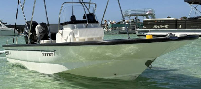

The starboard list might be caused by battery and fuel tank placement. My 150 Super Sport always lists a little starboard because the two 6-gallon fuel tanks are on that side. The 15-foot hulls are very weight sensitive.
Try to post a picture of the boat in the water if you can.

Fig. 3. Static trim of 2013 150 MONTAUK showing location of the anchor locker drain outlet relative to the waterline at the bow.
As seen in Figure 3 above, the outlet of the anchor locker drain at static trim is above the waterline.
[Regarding the list to starboard,] the 20-gallon [on-deck] fuel tank is located on centerline. One of two batteries, a heavy trolling motor battery, is located to port side. On the transom a Power-Pole (weighing about 35-lbs without its hydraulic actuators) is mounted off-center [but not indicated on which side] and that may be throwing off the lateral trim balance.

i would guess that you’re correct in the power pole being the source of the list. Boat doesn’t appear to be floating too low based on that photo.

ASIDE: The photo in Figure 3 was taken on the first trip that we made in this boat on June 28, 2026. We made a few more trips after that. I need to take a new photograph after I replace the throught-hull fitting, and then compare [the position of drain outlet at the bow] to this one to see if there is any difference [in the boat static trim].

carkit wrote:Q1: should I be concerned that a MARELON through hull drain located in the anchor locker of my recently purchased 2013 150 MONTAUK was loose, and that upon removing it I found the surrounding foam to be wet?
Yes. Any path that allows water to perpetually be in contact with the interior foam is a concern. If you can find an exact replacement fitting, when you install it be sure to create a better seal to the hull to prevent water ingress.
