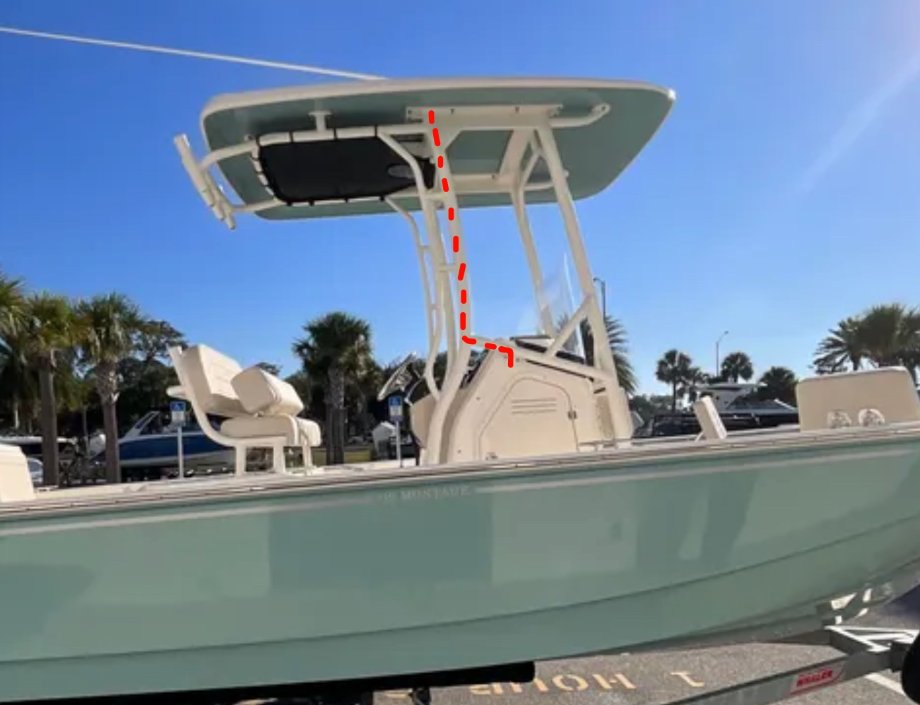

NorthShoreWhaler wrote:On my 190 Montauk [the wiring path to a hard top to a radio antenna mounted on the hard top] is through the starboard side attachment of the [hard] top to the [center] console. [On a ] 210 Montauk [the wiring path] should be the same.
Northshorewhaler, is that the exact path your radio antenna cable takes?
I'm trying to confirm that the cable goes straight into the console rather than routing down to the deck floor first. I still haven't found where the anchor light wire enters the center console on my 210, so I actually just bought an endoscope to help me trace it.
I contacted the factory, but they just referred me to the dealer—who offered to look at it for a fee, of course. Not exactly the help I was hoping for!
BTW, this is not a actual picture of my boat. I do not have a vhf antenna.

Re: 2026 210 MONTAUK with T-top: Antenna Cable Route
Postby NorthShoreWhaler » Tue Aug 04, 2026 6:03 am
Yes that looks correct. Next time i’m on my boat I’ll take a picture. I had the VHF and antenna installed last year at the Boston Whaler dealer.
