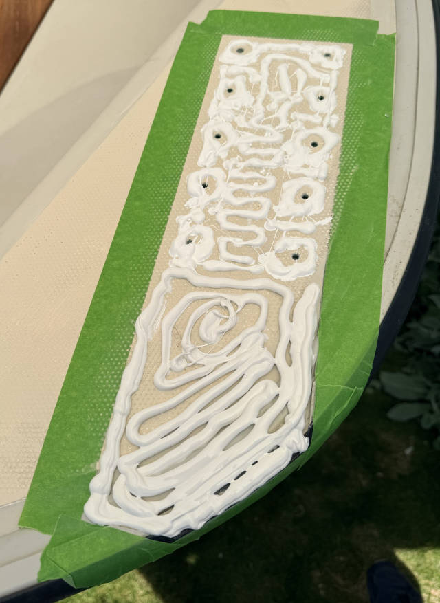

I just made a trolling motor mount for my 1986 Montauk 17, and I installed the mount on the weekend of June 6-7, 2026.
I used 3/8-inch [thick] aluminum [plate] and mounted the Minn Kota RTA-17 motor to it. I then placed that whole assembly on at the flat bow port-side section or bow step.
Next I calculated the proper spacing so the trolling motor could be deployed and not hit the rub railing, as well as making sure it was centered on the bow step so the screws would hit the wood underneath.
To allow the plate to sit flat onto the bow step I had to trim away some of the rub rail. There is wood in this area. I screwed the plate down with ten #14 1-1/2-inch-long 316 stainless steel screws, and I used 3M 5200 adhesive to secure it [to the deck of the hull]. I used 3M4200 in the section under the plate to fill the gap by the rub rail. I used a little more 3M5200 and 3M4200 than I needed, but better safe than sorry.
The sealants oozed out of the screw holes and I just wiped away what I could . Then decided I might as well seal the tops of the screw heads so water doesn't seep into the bow step.
This mount was much cheaper than some of the aluminum slider plates I have seen online, and it is simple. I think it turned out well and will be plenty strong--this thing isn't going anywhere.
I still need to clean up some of adhesive and sand down the screw heads that I covered with extra 5200 that leaked out.

farnsrocket wrote:I used a little more 3M5200 and 3M4200 than I needed, but better safe than sorry.
As seen in Figure 1 below, I think you went overboard with the 3M adhesives. If they cured into a strong bond with the gel coat, you will most likely never be able to remove the trolling motor mount from the bow non-skid deck area. The bond of the gel coat to the mount is probably stronger than the bond of the gel coat to the foam. And if the bond of the gel coat to the foam is still very strong, then the shear strength of the foam is probably less than the shear strength of all the adhesives to the metal.
Fig. 1. A mix of 3M5200 and M4200 adhesives used to bond a metal plate to the non-skid area of the bow of a MONTAUK 17 to allow mounting of a trolling motor.
I have some experience in trying to remove something from a fiberglass hull that was bonded with a marine adhesive.
Cf.: Refitting a through-hull depth sounder transducer
https://continuouswave.com/maintenance-logs/newDS/
A recent project involved removing an antenna ratchet mount. I suspect it was bedded onto the cabin side with a very strong adhesive. The mounting plate, with the four 1/4-inch through-bolts removed, was so firmly glued in place that it still held up the radio antenna and four-foot extension mast, and the mount showed no sign of budging. I am going to try heat and a multi-saw to wear down the adhesive. The goal is to not harm the underlying gel coat.
