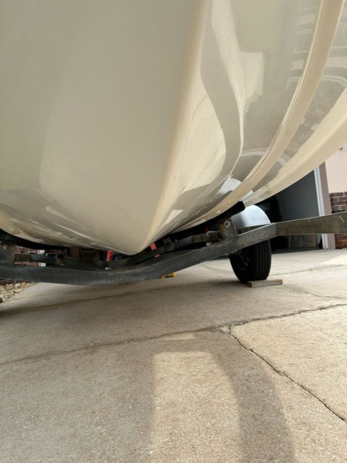

Just bought [a 2010 170 SUPER SPORT]. I did not notice [the hull] damage [shown in Figure 1] before I purchased the boat as-is from a Boston Whaler dealer. They delivered 2010 170 SUPER SPORT to me in the water, and I immediately moved it on my lift. Then, a few days ago, I loaded the boat on the trailer to take it home and do some upgrades and work on it.
Think I will need a good fiberglass guy to grind out, apply fiberglass and gel coat [to repair the damaged area].
Q1: are there any special concerns with this-type [repair] work [on a Unibond hull]?
Q2: how could this damage have happened?
To me, the damage [to the keel] looks like somebody beached [the boat] on [a boat launching] ramp.
2010 170 SUPER SPORT: Damage to hull at keel

The damage to the hull at the forward quarter of the keel (seen in Figure 1) is quite unfortunate. For advice on making repairs, see the article in this forum at the top of the index listings which will lead you to three good reference articles on hull repair:
Advice on Repair of Unibond Hulls
https://continuouswave.com/forum/viewto ... f=6&t=9254
I suggest you read all three linked articles to get a better idea of how to make a proper repair.
In all cases, the first step is to let the hull dry out and for any water already behind the gel coat and laminate to be allowed to drip out and evaporate.
Because the area of damage is part of the running surface of the hull, you should take some immediate steps to prevent further ingress of water into the hull laminate and possibly into the foam interior. For example, if you intend to continue use of the boat before making a repair, apply some quality duct tape that has excellent adhesion and is reasonably water resistant to cover the damaged area. If you are not going to use the boat, get it out of the water and let the damaged area dry.
ASIDE
I am very surprised that an authorized Boston Whaler dealer sold this boat "as-is" knowing that the damage would required immediate repair in order to avoid further harm to the hull.
Because the damage is not in a highly visible area, a repair does not need to perfectly cosmetic and undetectable. On that basis you could very likely make a good repair yourself that is not particularly invisible to the eye, but will stop any ingress of water into the hull laminate and foam. My own preference for making a repair like this would be to buy the WEST System K-105 repair kit for about $60, and also to read their pamphlet on repair of fiberglass hulls with epoxy resin.

Re: 2010 170 SUPER SPORT: Damage to hull at keel
The damage looks as though it may have been caused by the trailer. I would examine the trailer carefully to rule that out. It could also have been caused by "power loading" when the trailer has not been in sufficiently deep water.
I agree that then damage to the keel could have been caused by the trailer. I had similar damage when my trailer bunks were set a bit too low. On certain boat launching ramps [the angle the ramp descended into the water caused] the keel [to be able to ] scrape on the front crossbar of the trailer during the loading. [As a remedy for this problem with this trailer on those certain ramps,] I slightly raised the trailer bunks and also installed a plastic skid guard on the trailer’s front crossbar.
If you just want [the repair to be] water tight and [the boat to be] ready to run then I would use the [WEST System Fiberglass epoxy repair] kit Jim recommended.
If you want [the repair] to look pristine and gel coat over it, you will have to stay away from epoxy and go with a polyester resin underneath the gel coat.
Wrong. You are repeating old myths. You can apply gel coat polyester resin over a surface of cured epoxy resin with excellent outcomes, as long as you properly prepare the epoxy surface. I have personally done this and the repairs have stood up for over twenty years. I describe the process in an article:Cala wrote:If you want it to look pristine and gel coat over it you will have to stay away from epoxy and go with a polyester resin underneath the gel coat.
To me, the damage to the hull surely looks like if was from the trailer.
On my 190 NANTUCKET I had similar keel damage caused by the trailer. The existing trailer was due for replacement, and I ordered a new trailer. The problem with the trailer causing damage to the keel fiberglass and gel coat did not recur with the new trailer.

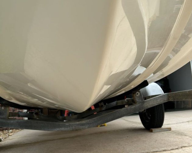

My dealer, Marine Max in Cocoa, FL fixed the hull damage for free and did a beautiful job. The repair is invisible.
