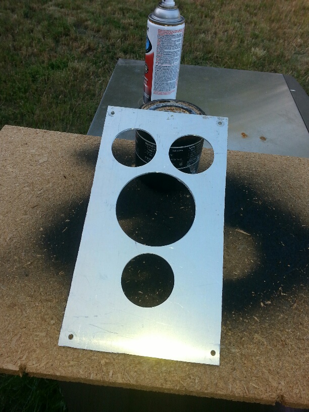

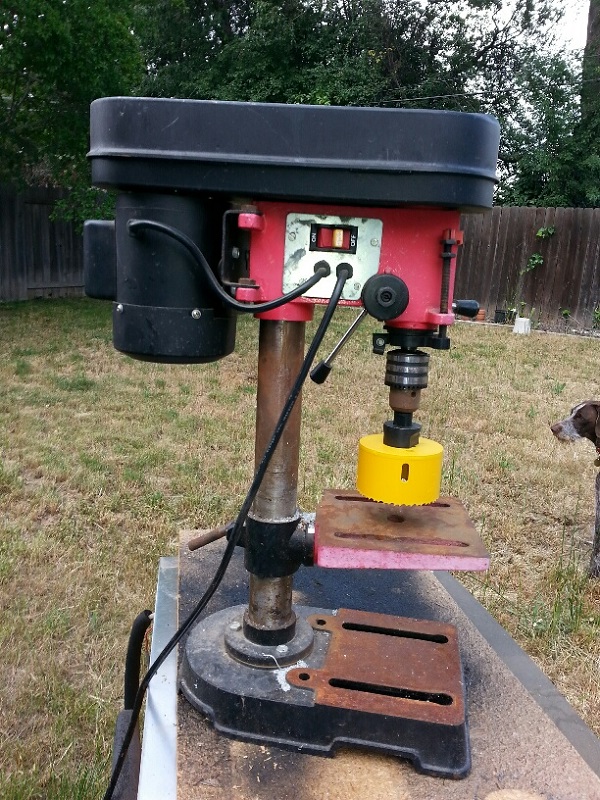

I had to manufacture a new instrument panel. I had some sheet aluminum (from an old street sign). I striped the paint, cut to size with my Skill saw, and filed the edges smooth. I cut the proper holes with my drill press and the correct size hole saws (3-1/8-inch and 2-1/8-inch). I painted the panel with zinc-chromate primer and then with black wrinkle paint. To get the wrinkle paint to wrinkle with consistent small wrinkles, I had to cure the painted panel in a 200-degree oven for an hour. The Outrages of that era had a black vinyl panel between the two metal instrument panels. I found some peel and stick sign vinyl that looked very close.

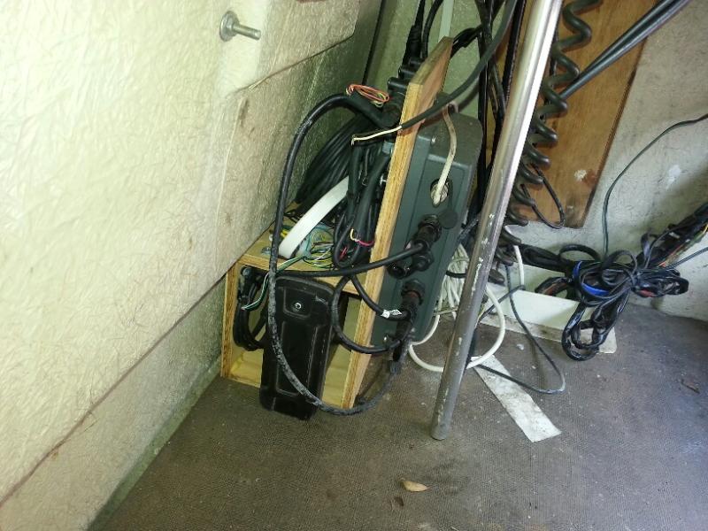

As you may be aware, the console on a 1986 Outrage 18 is not a very large space. With my electronic upgrades, I had several constraints I had to deal with. Space, accessibility, upgrade ability and I wanted to make few changes I couldn’t reverse easily.
The VHF and the AIS both had minimum distances they had to be away from the compass. The compass is on top of the console, directly in front of the helm, slightly to the port side of the console top. I wanted to preserve as much space as I could in the console. So I built this box -
VHF/AIS/NEMA 2000 box
VHF/AIS/NEMA 2000
There is a terminal strip to mount the NEMA 0183 network for the chart plotter and VHF, I also used part of the strip to hook up the AIS signal wires (turns AIS silent and emergency) to switches on the switch panel. There is another terminal strip to provide 12V + and – for the chartplotter, VHF and AIS. The Garmin chart plotter powers the NEMA 2000 network. The whole box fits in the very forward starboard side of the console forward of the fire extinguisher box (the fire extinguisher box is on the starboard side of the console). All of the connecting wires i.e., the 4 AIS signal wires, the 12V + and – are on quick connect connectors so I can take the whole box out of the console to work on it if needed. This system has been working well for 18 months.

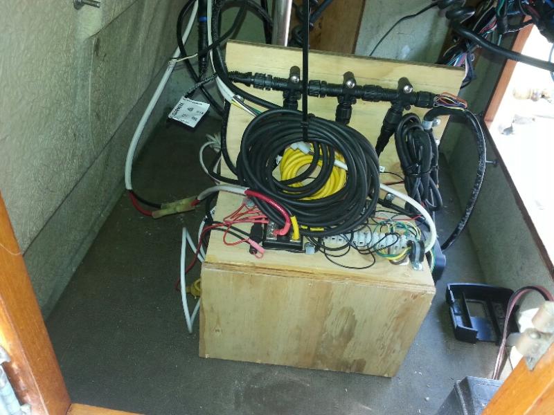

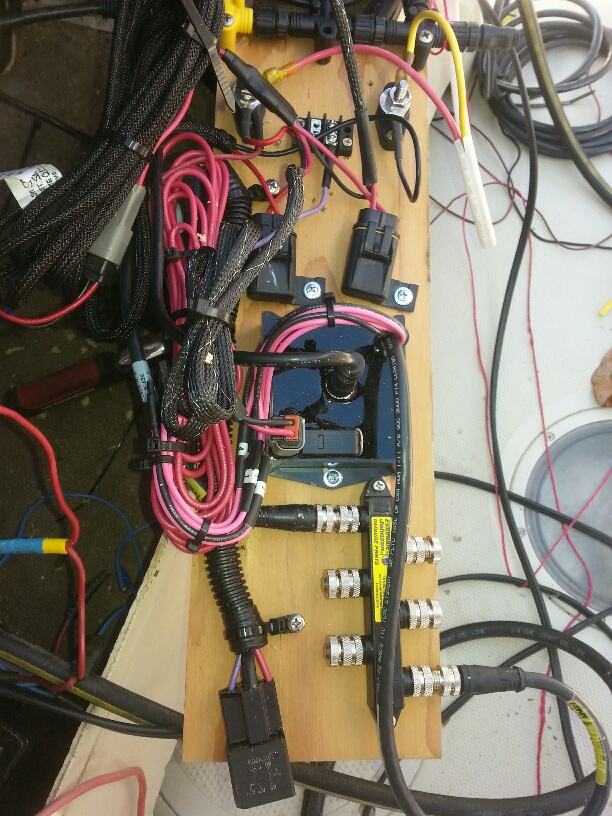

When I decided to upgrade to the E-TEC, with the incentives Evinrude was providing, I couldn’t pass up the opportunity to add the EST and ICON Pro gauges. The console hadn’t gotten any larger and I hadn’t gotten any more limber, I had all of the same constraints as my earlier electronics install. I mounted all of the components I could onto a board that I could fit in the console. It is placed in the console on the starboard side abaft the fire extinguisher box.
ICON Pro and ETS
The board mounts the gateway, the Evinrude network hub, an extension of the NEMA 2000 network, a terminal strip for the key switched B+ (violet wire), posts to distribute battery 12V + and -, and the fuse harnesses. I also bundled all of the excess wire into semi neat bundles.
The ETS binnacle plugs into the Evinrude hub on the proprietary Evinrude network and the key switch. The ICON Pro tachometer plugs into the NEMA 2000 network and the rest of the gauges “daisy chain” from the tachometer. I didn’t use the included speedometer or the NEMA 2000 GNSS antenna. I don’t need the speedometer (the seas dictate my speed and again, available space is a limiting factor) and I already have the required NEMA 2000 GNSS information provided on the network and already being used by the chartploter and the AIS

My old instrument panel had a tachometer, trim gauge and a horn button. My new instrument panel will have water pressure, engine temperature on top, the tachometer and then the trim gauge on the bottom (gauges placed in order of importance and easiest scan). None of the existing holes matched the new needed holes, so a new panel was in order. I had some old street signs that I had previously “salvaged”. The street sign aluminum was virtually the same thickness as the old instrument panel thickness (as measured with my plastic slide caliper) and cut easily with my Skilsaw. I filed the edges smooth and cut the holes with a simple drill press. I had a bit of difficulty finding the proper sized hole saws. As a general contractor I have a pretty good selection, I had 3”, 3 1/4”, 3 1/2”. I needed a 3 3/8”. I had 2”, 2 1/8”, 2 1/4”… I needed a 2 1/16”. I checked Home Depot, Lowes, Ace Hardware and a couple of local specialty wood working shops, none available. Amazon Prime had them at my door in two days. I already had the mandrel required. In the same industrial complex where my granite fabricator is located is also a powder coating shop. I stopped by to check on the cost to powder coat the two instrument panels flat black. The price quoted was crazy high ($80 retail with a $20 discount because they “already had a batch of flat black in process” = $60). For two 5” by 11” panels, I decided paint would work just fine. I had some black wrinkle paint in the shed from a previous project along with some zinc chromate primer. After a few test panels with scrap aluminum, I found the best “wrinkle” was obtained when I cured the painted panel in a 200 degree oven for an hour. After an hour I turned the oven off and left the panel in the oven for the rest of the afternoon. I primed the panel first, the next day painted the back and edges with regular flat black paint. A couple of hours later I painted the front three heavy coats 5 minutes apart with the wrinkle paint and off to the oven to cure. It came out great.

Two items I am still working for the instrument panel. The original panels had a nice pinstripe detail around the panel, I couldn’t find a way to duplicate that feature. The original panels also had nice counter sinks on the four mounting holes and the panels mounted with flat head type screws. I was unable to consistently duplicate the counter sink with my tools. I choose to use straight holes with round head type screws.
