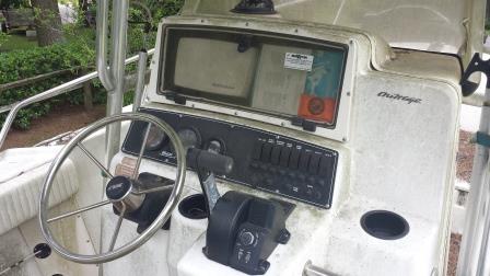

View of console:

If you are inclined to not like problems, I would walk away.
If you don't mind project boats and don't mind possibly a year of work, make an offer.
Given what you posted, plus the unknowns, my thinking would be based on a dead outboard and all rigging and wiring replaced and the potential for water logged decks and foam and a bad fuel tank.
The NADA book values for Whalers in decent condition tend to be undervalued by 50-100%
Based on your description, I might be inclined to make an offer at 50% of the NADA value, minus the outboard, $6-8000, might.
I like that hull, size and tower and I don't mind projects. If the hull looks good to a surveyor I would make an initial low ball of $5000
If you have to replace the outboard you are looking at potentially 18-20K
Figure on $1,000 or so to bring the trailer up to specs and anywhere from $2,000 and up to bring the boat back to decent condition. A fuel tank problem could cost you $2,000 by itself.
If you could buy it for $5,000, put $20,000 into a new outboard and the rigging, maybe $5,000 more in repairs you are ahead in the game compared to people who pay book value, then a new outboard.
